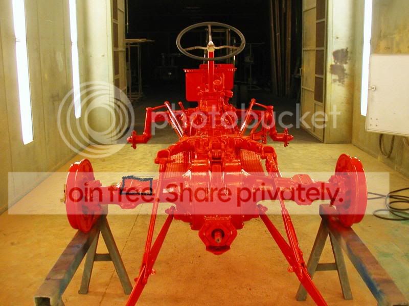

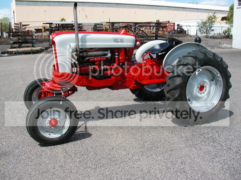

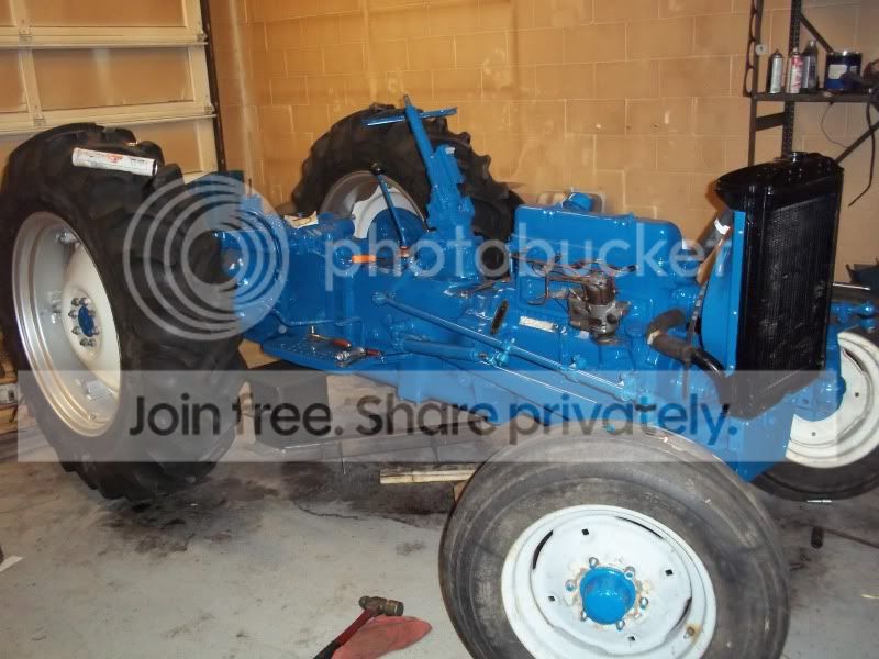

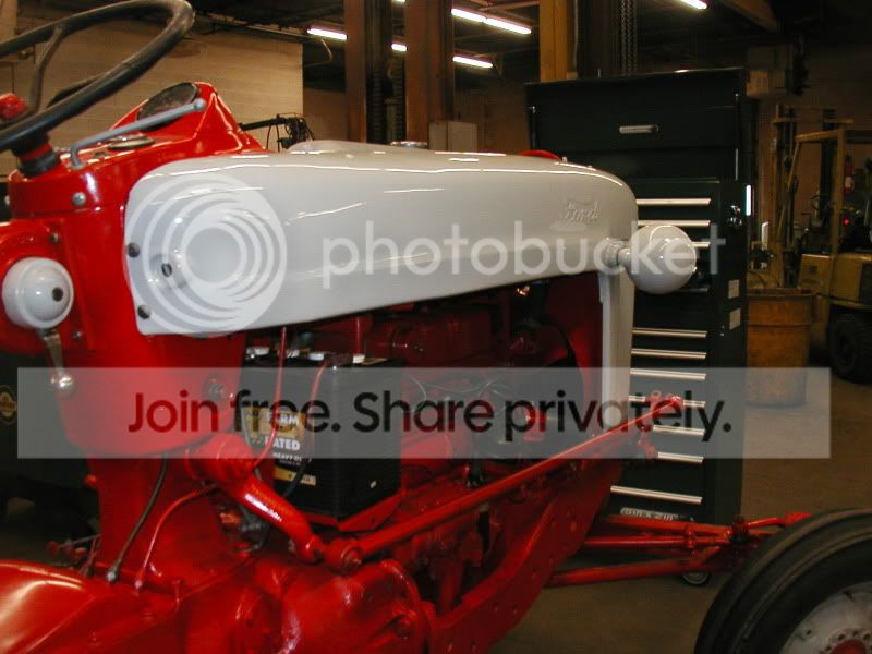

All of these were shot with enamel with a hardner and lacquor thinner.
dunno what I'm doing wrong, but I've restored over 30 tractors over the last 25 yrs and used lacquer thinner as a reducer w/ enamel paints w/ no problems. The end product has a nice high gloss and has held up for many yrs.
Use the same thinner to clean up my gun afterwards.
