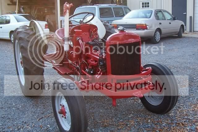

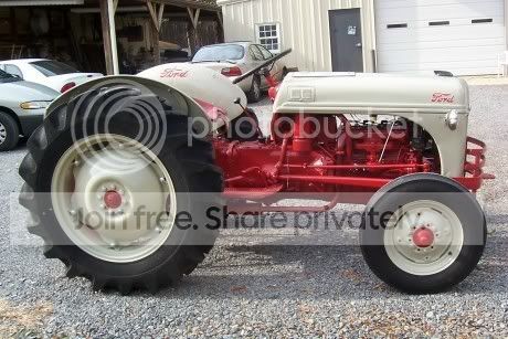

This '46 2n was painted with a brush back in 2003. Still does it's fair share of work on the farm and still looks pretty good. Brush the tin with a fine hair oil brush sand lightly with 800/1000,
steelwool, inbetween coats and buff it out to finish. I mix my own colors using rustoleum paint. For an 8n use rustoleum sunrise red for body and for tin I mix 22 parts Almond/ 1 part black to 1
1/4 parts sunburst yellow to get the right shade of grey. I use a scoop from a protein shake to measure the parts.

I have had good luck with TISCO paint and fog over it with there rattle can paint. I have had better luck with CNH paint and fog over it with CNH rattle can paint. CNH paint is competition price wise and a better but there rattle can paint is pricey, I prefer CNH paint myself.
Its going to depend on what paint you use not all paint is brush/roller friendly. I would brush/roll.fog over its worked for me...
BTW I ran out of CNH rattle can paint one time and had to run out a pick up another brand I was not happy with the results...
If it were me for the red I would pick up a gal of CNH Rouge Red 6 cans of CNH Rouge Red rattle can paint and the hardner. Its going to take a 1/2 gal of red.
For the grey a ot. of TISCO TP240 a 1/2 pint of TP12HP hardner and at least 4 rattle cans of TISCO TP240.
For the tin I use Shur-Line Trim &amp; Touch up Rollers (3") pick them up at Lowe's. Throw away brushes for the frame...
I still have this tractor somewhere if I can just remember were I parked it last... Everything is brushed/rolled except the hood... I sprayed the hood with single stage urethane from NAPA..
