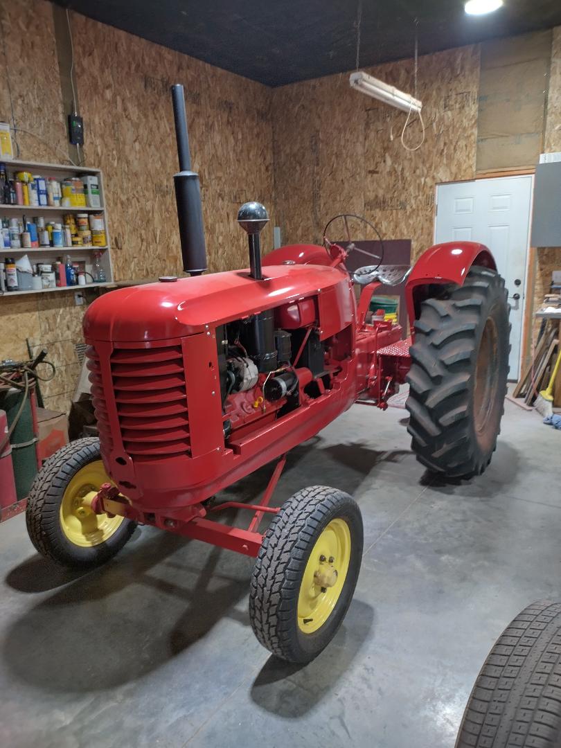

I need some advice. I sandblasted my wheels on the tractor myself. The wheels would not come off the axles. They are a combination of cast centers and steel rims and were rusty from chloride leaks. The blasting got the wheels down to stable (stuck) old paint and bare metal. The rims don't leak and are still solid.
Then I applied a rust converter (Corroseal), which did its job of turning the wheels deep black. Now my options are to brush a coat of good DTM white gloss as a primer (I have the paint) and then apply the final brush coat of Rustoleum (a custom blend to get the Massey Harris yellow). or skip the DTM white and go straight to the final coat of Rustoleum yellow.
This is not a show tractor, but I want the wheel paint to last. Is it worth putting the white on prior to the final yellow? I was thinking yellow over the black would be harder to cover and hide the black, than putting yellow over the white. Are there good and bad points to having the layer of white under the yellow. All the specs on the paint and rust converter say they are compatible. steve

Most rust converters create a good base for a topcoat. I'm not familiar with the DTM product primer you are considering.
Many times, mixing products from different manufacturers can complicate and impede the proceess toward a good job.
I think at this point when you have applied the rust converter, you can do a topcoat with no problem.
That being said, I suggest you go over all surfaces with an appropriate grade of Scoth-Brite pad, scuff every nook and cranny, before topcoating to maximizing the paint adherence.

The Corroseal directions say to apply the topcoat right over the cured and dried rust converter. Adding my DTM (direct to metal) oil base enamel as a primer coat is not in their directions. However, I have the DTM, and I could Scotchbrite scuff the Corroseal, and then put the DTM on as a primer. My final will be the brushed on Rustoleum, unless I get some dry weather so I can spray it on. Do I need to scuff between the DTM and the Rustoleum if I stay inside the recoat window? Both are oil base enamels. One tire is already masked and ready to go. Thanks for all the suggestions so far. steve

You are right. Most times yellow will cover a lighter color than a dark one. But in my experience, it usually takes several coats to completely cover even the light color.

Rustoleum has a yellow primer, why not use that and know it's right. Use the white DTM to pretty up something else around the place.
Red oxide primer then top coat for lasting rust protection. If you can see your primer you don't have enough coats of color paint and darker primer will help you with this.

John Deere has a buff colored primer, looks like a flat Yellow. I'd use that or a grey colored primer before your top coat. A dark primer will be hard to cover with Yellow paint.
I followed the instructions on the rust converter and painted the yellow right over the Corroseal. It took two heavy brush coats, and probably should have a 3rd coat, especially on the cast centers. After it hardens up a bit, I'm going to do a small test scrape to see how hard it is stuck. I have one more outside to do, then I'll post some pics. Like others said, black is hard to cover. steve

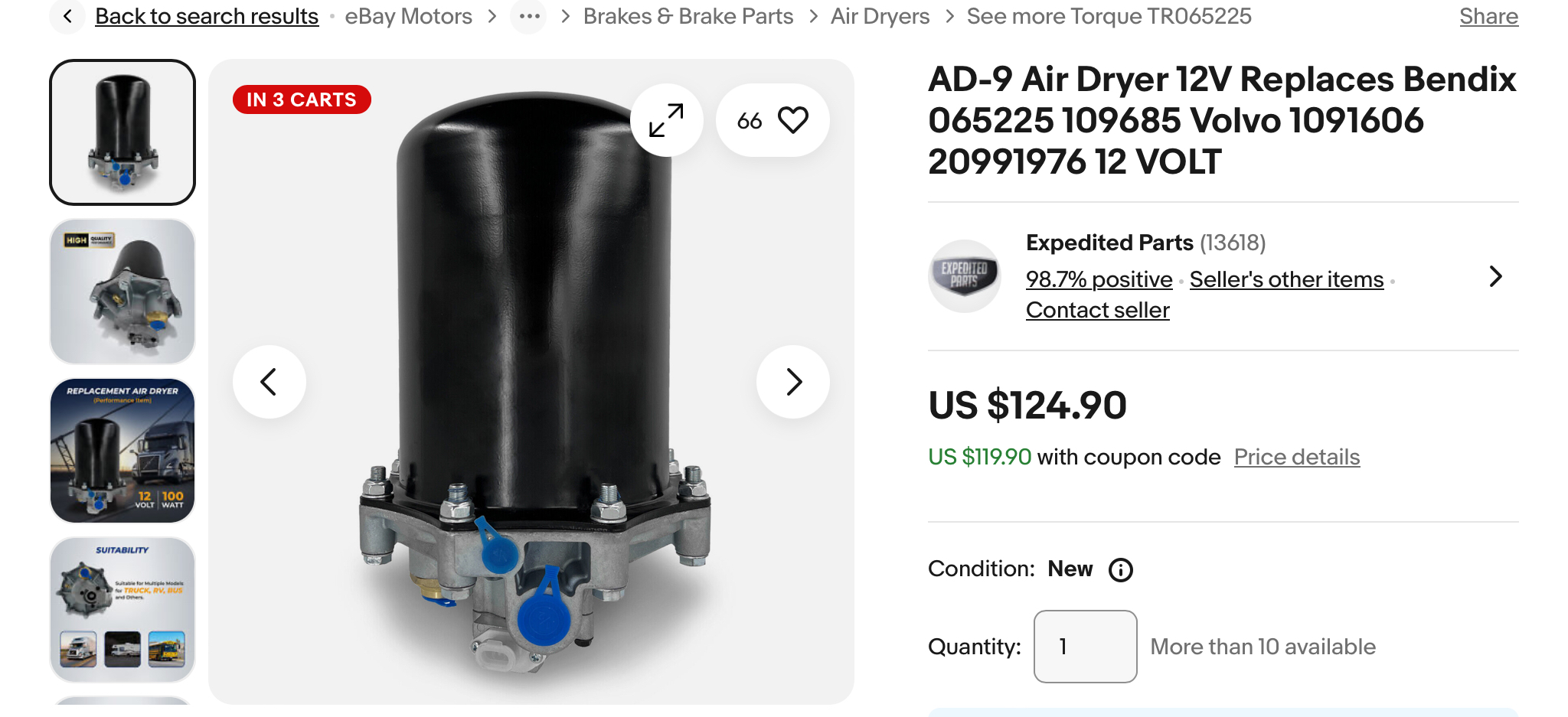

Just a tip for your moisture problems. An air dryer off a semi works really well at removing water from your air supply.
Pic is of an aftermarket option to provide inspiration. I have one taken from a wreck that is hooked to my shop compressor for the sand blaster supply, and I can plug a hose into it when painting. When I am done using it for the day, I stick a blow gun in the purge port to trip it and dump any accumulated moisture.

That's a really good idea. I think my local junk yard might have something like that off a junk truck. I'm going to check. I don't know much about how they work. Will I need to wire in a 12V power supply?
Thanks for the suggestion. steve

The 12v is only for a heater to prevent icing of the purge valve. I’ve never had an ice problem in the shop? 😁
Its just a filter housing with a inlet and outlet. There is an additional port to actuate the purge valve to drain any accumulated moisture. You could plumb in an airline and valve to work it, I just take an airline hose and blow gun and stick it in the port to cycle the purge valve. Ideally you would drain it at the end of the day after using it in a shop. I do well if I drain mine 3 times a year.

Thanks, I thought that might be the case, or some sort of relay for the purge. Does the filter element have to be changed eventually? I'm seeing used dryers on FB marketplace from $25 to $450. I'm going to call the junkyard and get a quote, too.

Todays trucks they recommend changing the element annually, but they have more delicate valves than the older trucks. The AD9 (or clone) like the pic had an element that would maybe be changed 2-3 times in the average trucks life. I have an older version AD1 on my shop compressor, it has been there for close to 30 years. I had put in a reman cartridge when I set it up and haven’t worried about it since.
