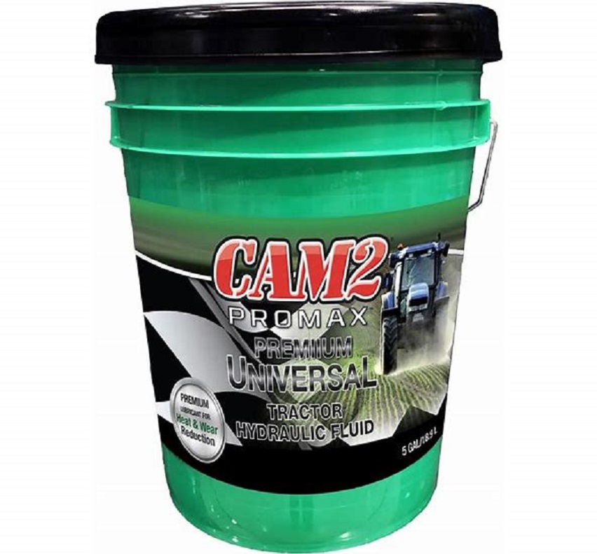

You do not want straight hydraulic oils/fluids. You want Cam2 Promax Premium Universal Tractor Hydraulic Fluid, to meet the Permatran requirements.
Cam2 Promax Premium Universal Tractor Hydraulic Fluid data sheet
Is this the same as that
Is this the same as that?
CAM2 PROMAX™ Tractor Hydraulic J20 C Oil, 5 Gallon - 565298​
Labels change over time, and sometimes for retailers. I believe with a bit of searching product codes and data sheets you will find it is the same product with a different label. Putting the John Deere J20C on the label can draw the attention to it, as the J20C spec is often referred to for a wet brake/clutch oil.
