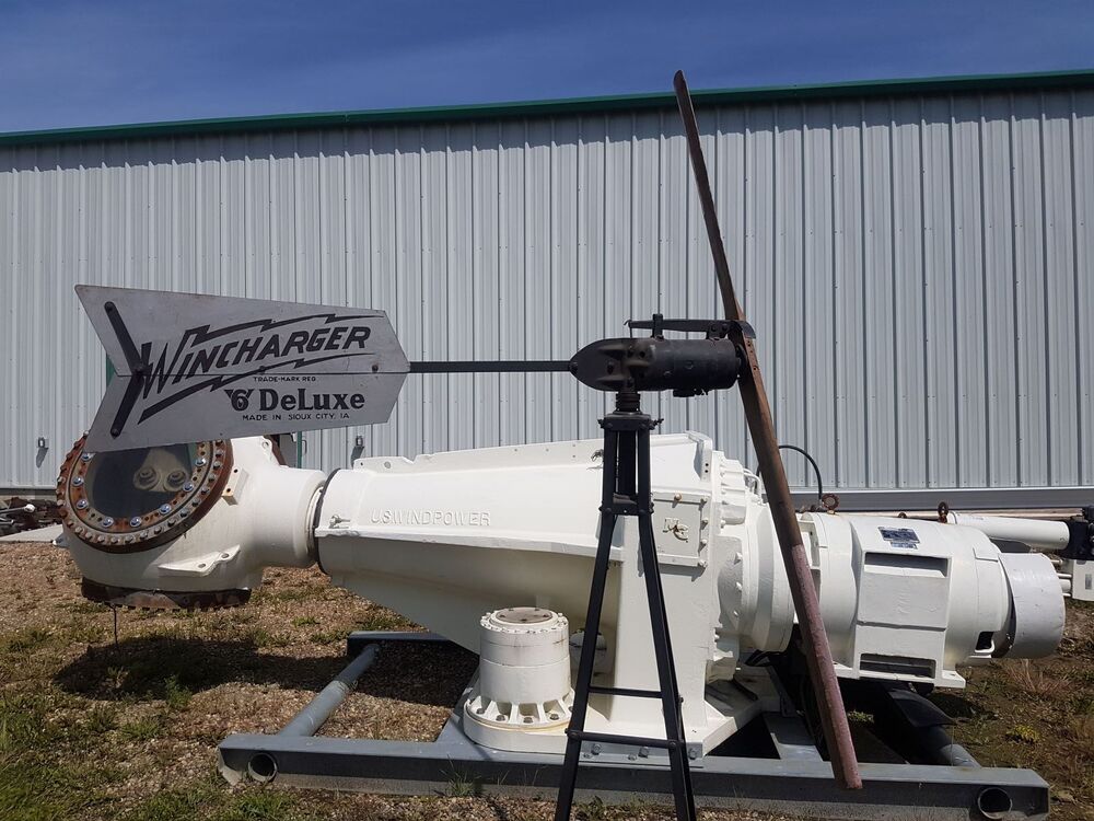

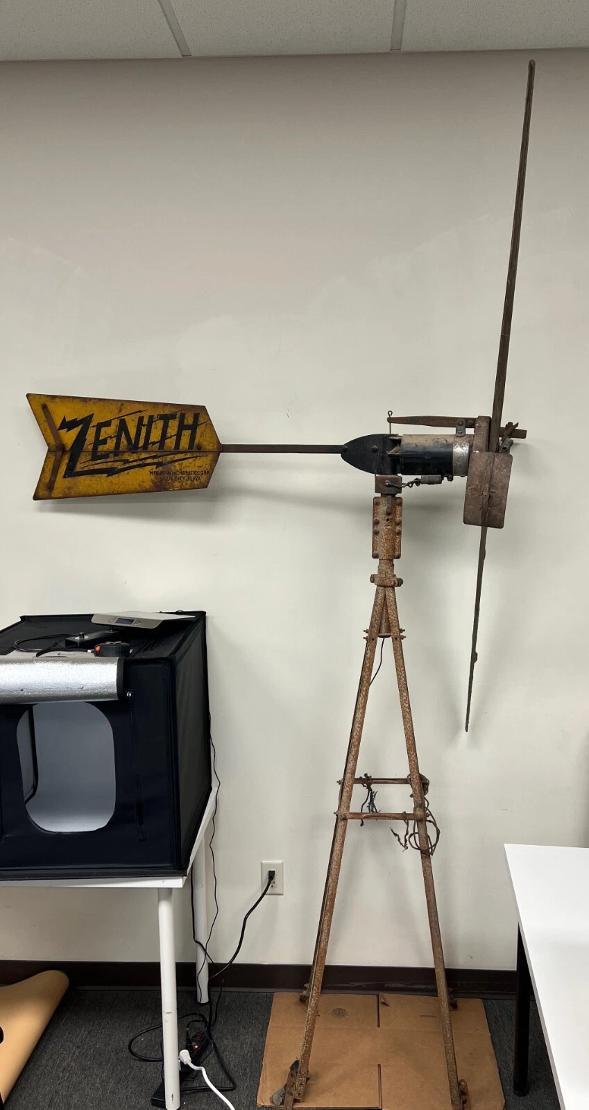

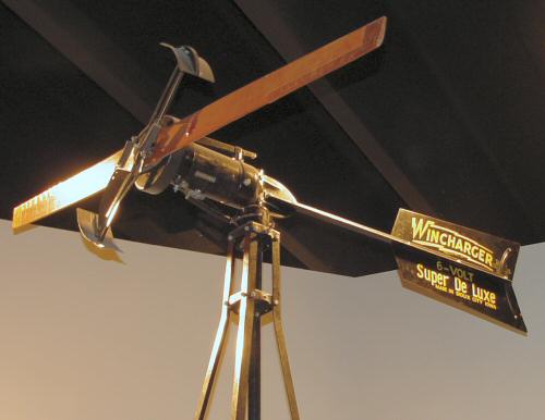

Because I like my "old" stuff, I've looked into getting a Wincharger in the past. It is either 6v, 12v, or 32v, but that problem could easily be rectified.... though the current would need to be inverted. 🙃 A-haw! A-haw!
There were bigger units that would give you 110v, but they are not that common.
They made towers up to 100', if I recall right.
There are quite a few left in the world & the collectors that go with them. Here's a site that will give you some insight if interested. It is a cool site to check out, even if that tech is not what you are looking for.
