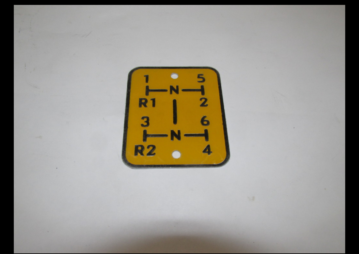

I can find reverse, two slower speeds and two OMG! speeds. I try to follow the graphic on the dash to find the speed I want ... and have not felt successful. I can drive a three on the tree and a 5-speed. This is puzzling.

There are two neutrals. The top one has 1-2-5 and R1. The lower one has 3-4-6 and R2. Let the shift center itself then pull straight back toward the back of the tractor or push straight forward to get in the top gears.

You should have one of these on your dash
