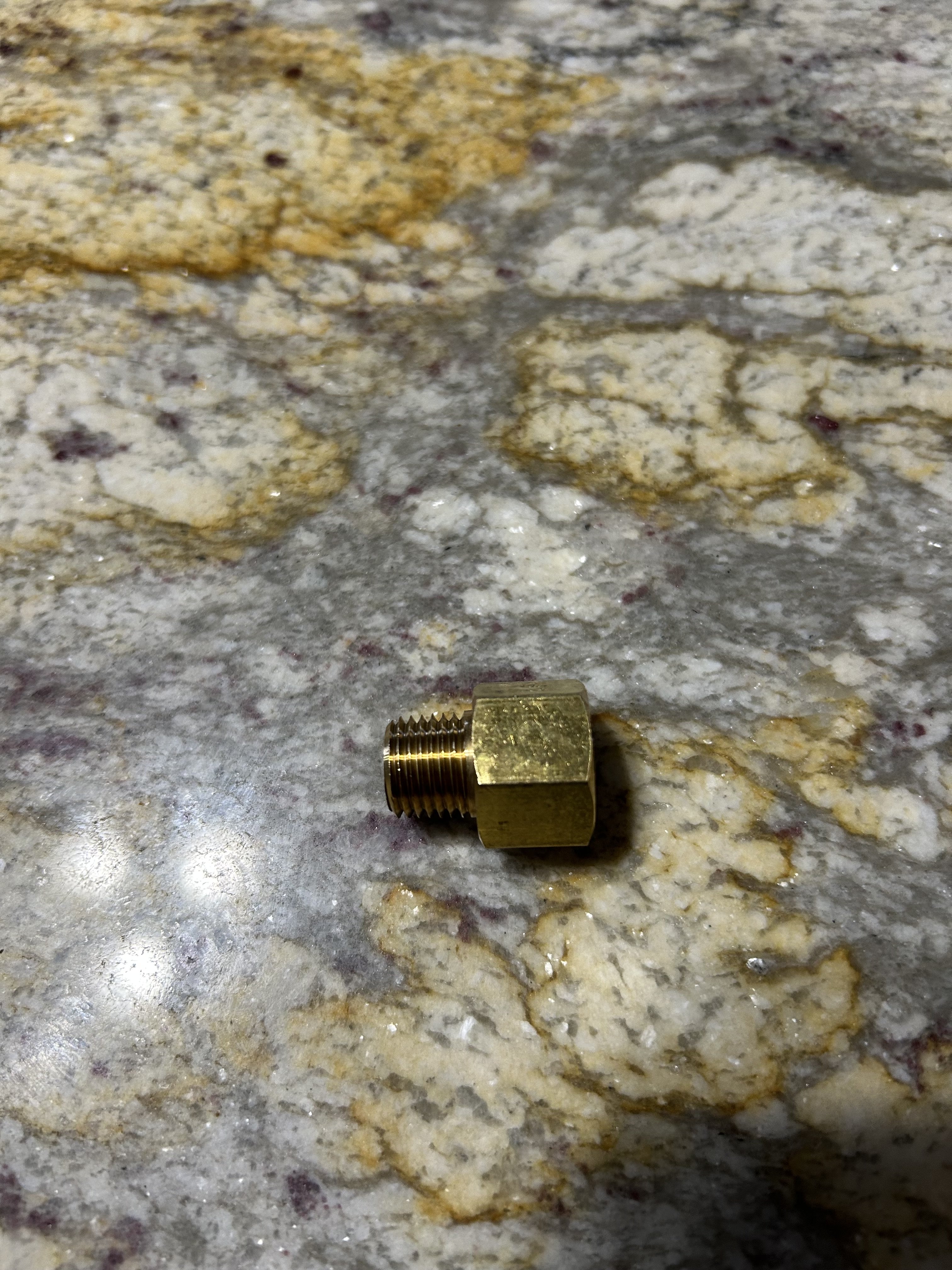

On hyd equipment that stays outsideGates hydraulic catalog calls that an increasing bushing. A nipple would have male threads on both ends

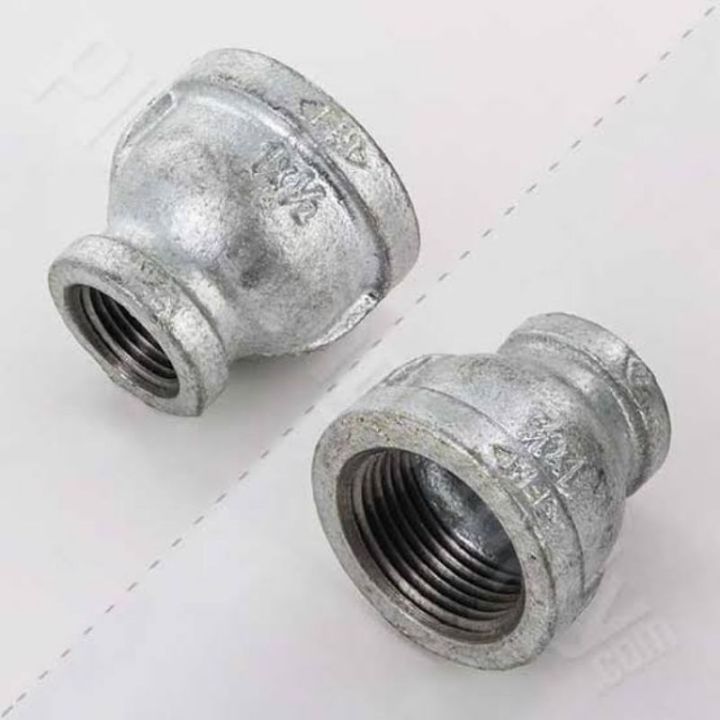

What are you doing that requires galvanized? Plumbers would use a galvanized bell coupling and nipple of the appropriate size and length.
You should not be using galvanized plumbing fittings for hydraulics. Most plumbing fittings are only rated for 150 to 300 PSI working pressure and the galvanizing can flake off and cause problems. You should use fittings designed and rated for hydraulics. Your equipment, your choice.On hyd equipment that stays outside
that sure is a small fitting, not sure what its used for ? but there is all kinds of hyd. fittings available. plus black pipe. what your showing is brass , no good.why don’t they make a fitting like this in galvanized a reducing street nipple ? Had to buy coupler and close nipple ??

I've also heard that the galvanizing can react with the oil and cause problems.You should not be using galvanized plumbing fittings for hydraulics. Most plumbing fittings are only rated for 150 to 300 PSI working pressure and the galvanizing can flake off and cause problems. You should use fittings designed and rated for hydraulics. Your equipment, your choice.

This thread kind of got off track I was wondering why they make a street “L “ but not a street coupling in pipe fittingsI'd tend to agree with those that say get a proper hydraulic fitting, and especially avoid galvanized. Regular sched pipe is sometimes used in ag hydraulic systems. It really shouldn't be, because 95% of hydraulics will have relief pressure of several hundred to several thousand psi. But folks still use it sometimes, and mostly without issue. As noted above, it's plenty thick and probably a similar alloy. It's not that sched pipe can't handle the pressure - it's rather that it just isn't tested/QA-checked for those pressures. Similarly, you can buy round structural tube that's exactly the same as sched pipe in every way - it just hasn't been pressure rated/tested with the same QA. If you were to use it in plumbing instead of sched-rated pipe, it'd do fine in 99% of cases. But you may get the occasional weld defect on the seam, etc, because QA and testing procedures aren't the same. I've used regular sched fittings for hydraulics myself several times. But most importantly: If you are going to use regular sched pipe/fittings, you want black pipe - not galvanized. The galvanizing can flake off - especially from internal threads and elbow fittings.
When I bought my Allis 180, one of the remote pairs wasn't working properly. The loader the previous owner had on it had several home-brewed galvanized pipe lengths and fittings (I left the loader for him to scrap, because it was a cobbled-together mess). When I took the coupler apart on the bad remote, I found a pile of galvanizing flakes jammed in it. Cleaned it up and it works now, but I'm sure those flakes floating around the hydraulic system didn't do it any favours.
Similarly at work we often used to (and still do... for some reason...) use galvanized sched 40 for running a lot of pneumatic lines. Twice in the past few years we've had to make warranty trips to customer's sites to repair/replace pneumatic solenoid valves and cylinders that have had galvanizing flake off and bungle them up inside. The galvanized elbows seem to be the worst offenders.
Even if this is a low-pressure system, the proper hydraulic reducing bushings are only a couple dollars. Better to just do the thing properly in the first place. But if you are going to use regular sched fittings from the hardware store, better to use black instead of galvanized. See link below for an example: For less than $2 you could get the proper hydraulic bushing:
