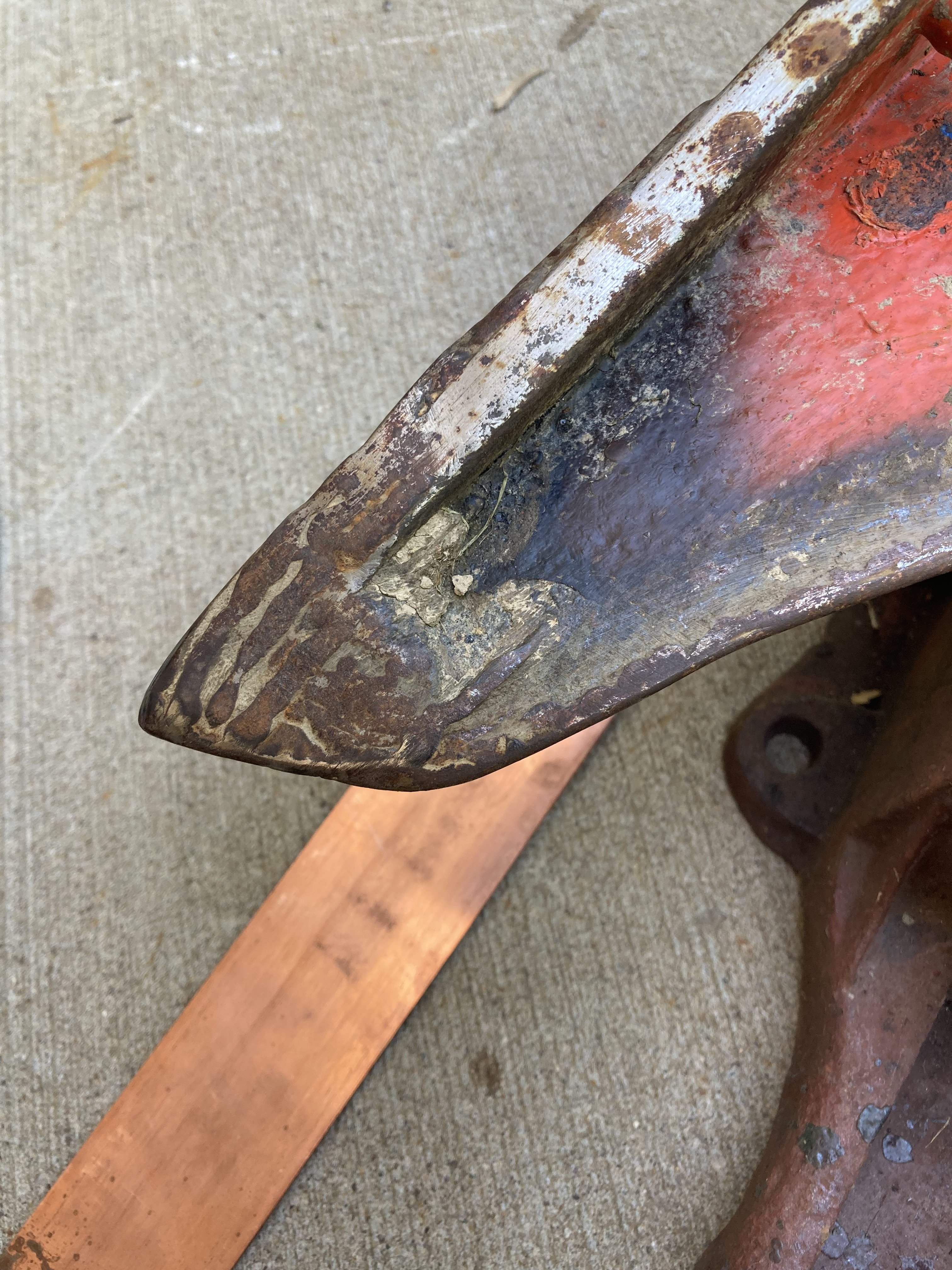

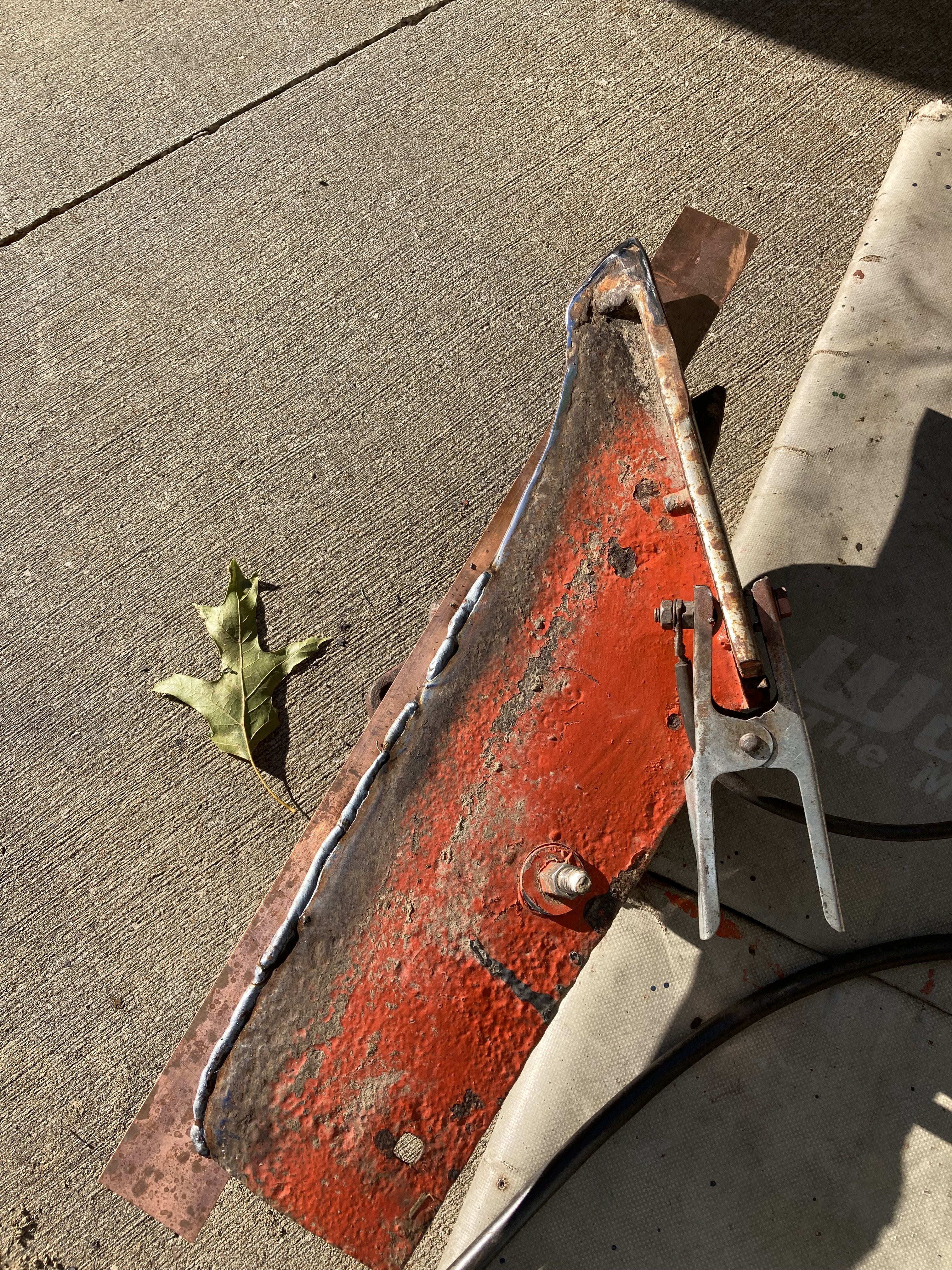

Example of blacksmith share sled runner and how I repair the share . Maintenance to your plow will yield you amazing results .
