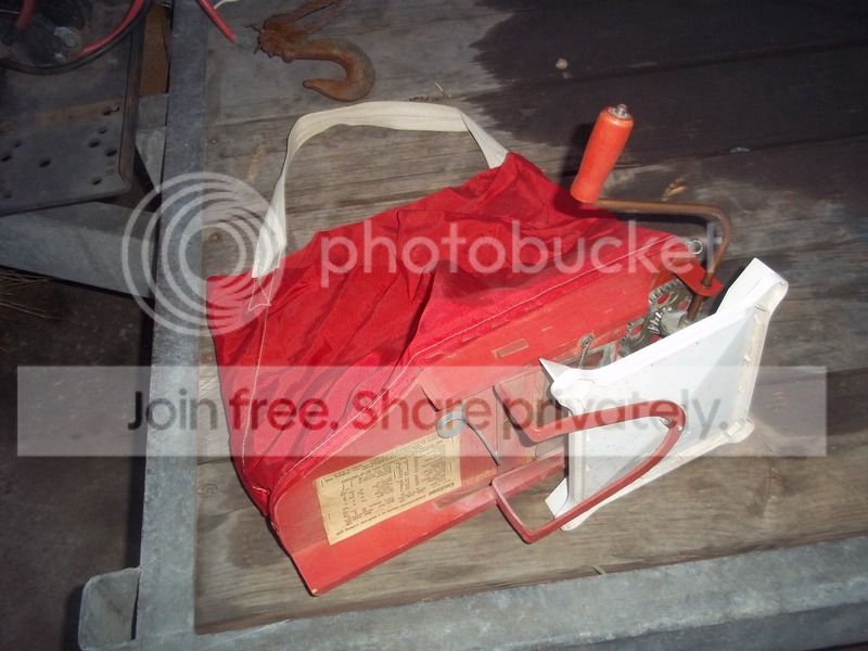

For seed I just go in to the local feed/seed store and buy their big rack mix. It's tuned for your climate/area. I've tried other things but get the best results from a pre mix. It's a mix of clovers, alfalfa, timothy, rape and turnip. About $40 for a bag - enough to do 2 acres. I use a broadcast spreader that I bought on Ebay a few years ago. But when I first started I just broadcast the seed by hand.

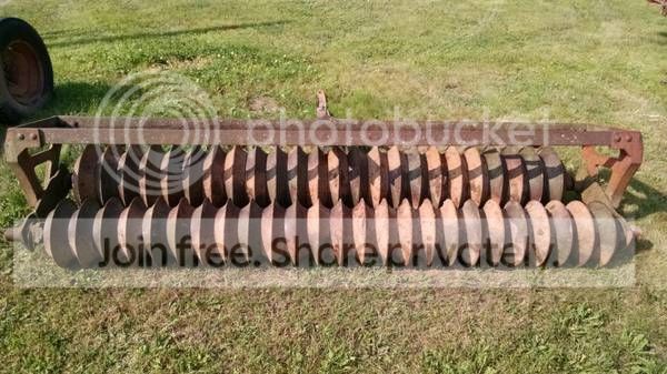

Last summer though I found this 8' cultipacker and made some repairs on it.
A cultipacker will give you a better germination rate as it presses the seed into the soil instead of covering it. Fine seed does not like to be covered too deeply.

Great pictorial, I get cranked about plots, its a great hobby, is that a McCormick Deering cultipacker, ( soil pulverizer as they call it LOL !) ? I just picked mine up, 7' I think, had it 2 years but it was at the other place, I just disc'd up my lawn for overseed and smoothing, will be using it for the first time, though I've run a 12' Brillion, this one I own, needs a few wheels and one axle endcap has a piece of out of, looks repairable or I could make a new cap without too much trouble. Friend has the same cultivator in a ferguson, not the wide shovels, the narrow cultivator type, though its not my first preference, it was a good find and we have used it quite a bit with good results for sure, he's got some nice garden patches, we want to set it up for row crops. I don't see those very often, he was lucky to find it, but between us, we have all the implements at least.
