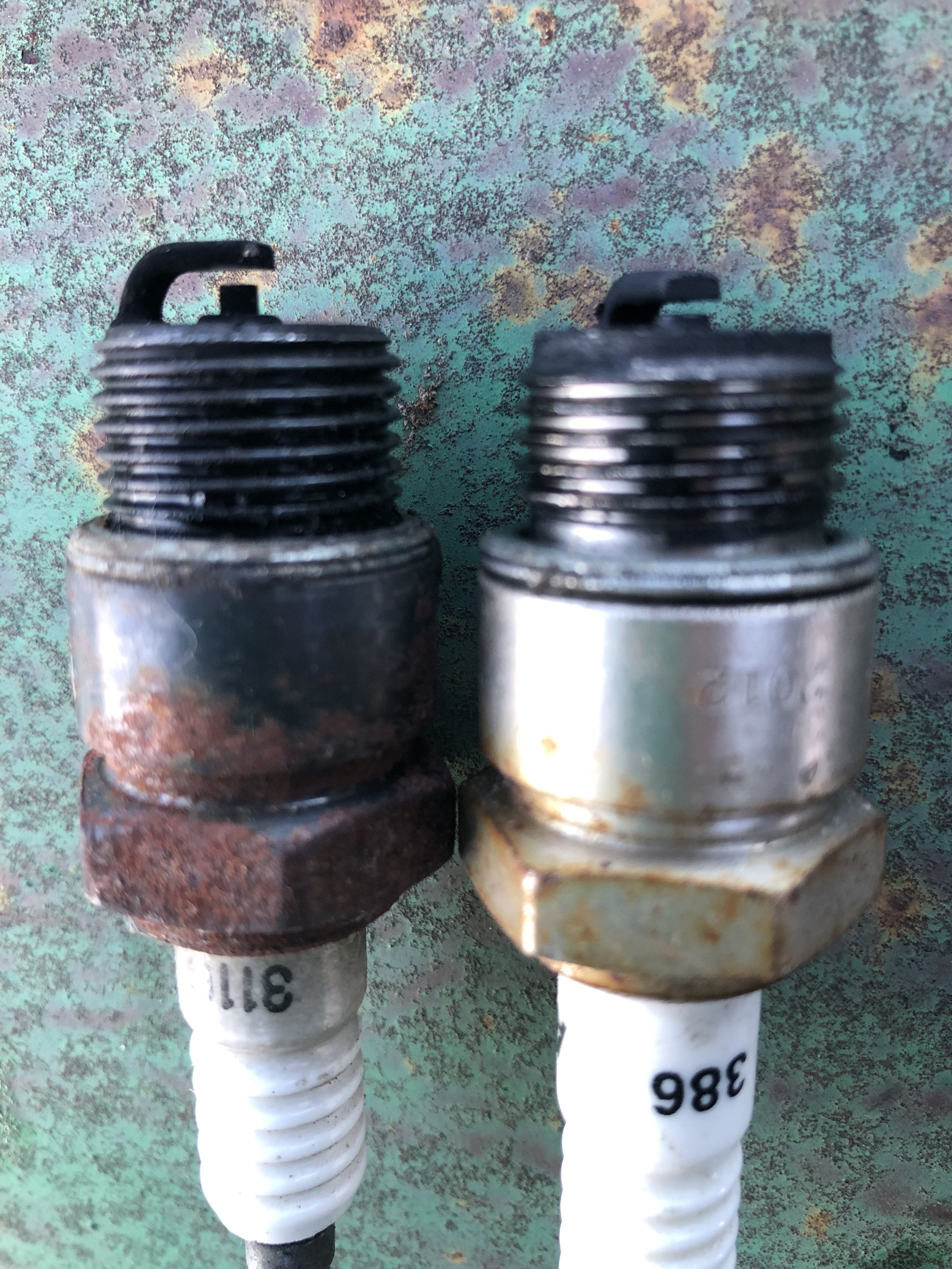

long reach is not just the electrode. the actual thread body is longer and the threads screw into the head threads to the required depth. using just a D16 plug does not use up all the threads in the head and the remaining ones fill up with carbon. the when u want the correct plug it wont screw in all the way.
For 7/8" heads , use a no.2 commercial, which changes to a W-18.
For 18mm heads, light duty, no. 10 commercial, which near as I can tell changes to a D-21Y.
These are your choices in Champion .... I have no idea if this brand was in the tractor when it left the factory.
Showing the difference in autolite 386 and 3118 plugs. As you see the 3118 is a hotter plug. And I think the 386 is also resistor plug. Better off with the 3118 for light work.
