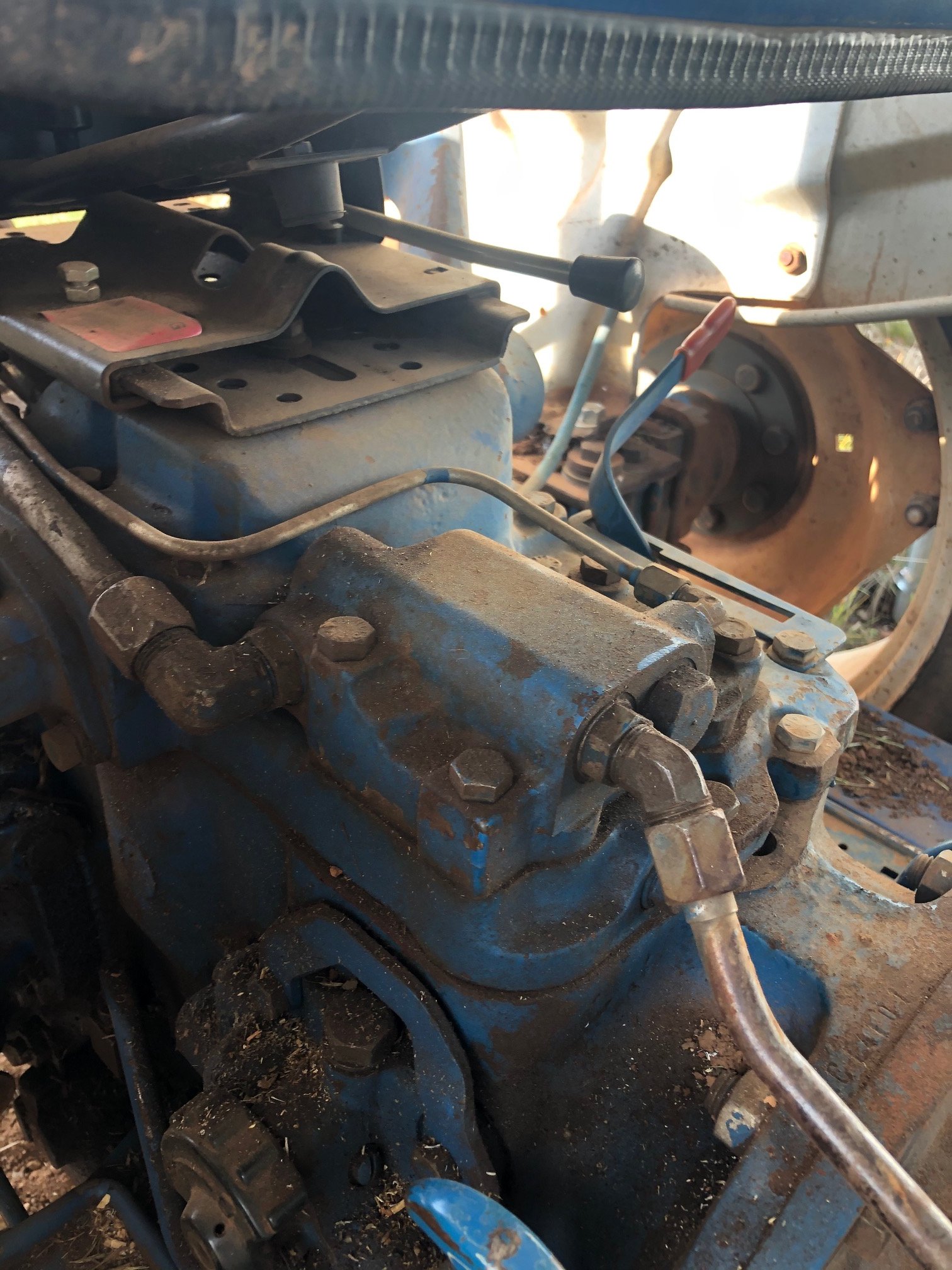

Hey, not by the tractor at the moment but it’s got this cover in the picture below. I would assume it would still work, but like I said before I can talk to our local dealer too.

You have a different style remote valve assembly on the back of your tractor from the one I posted but the block I'm talking about should work the same.
