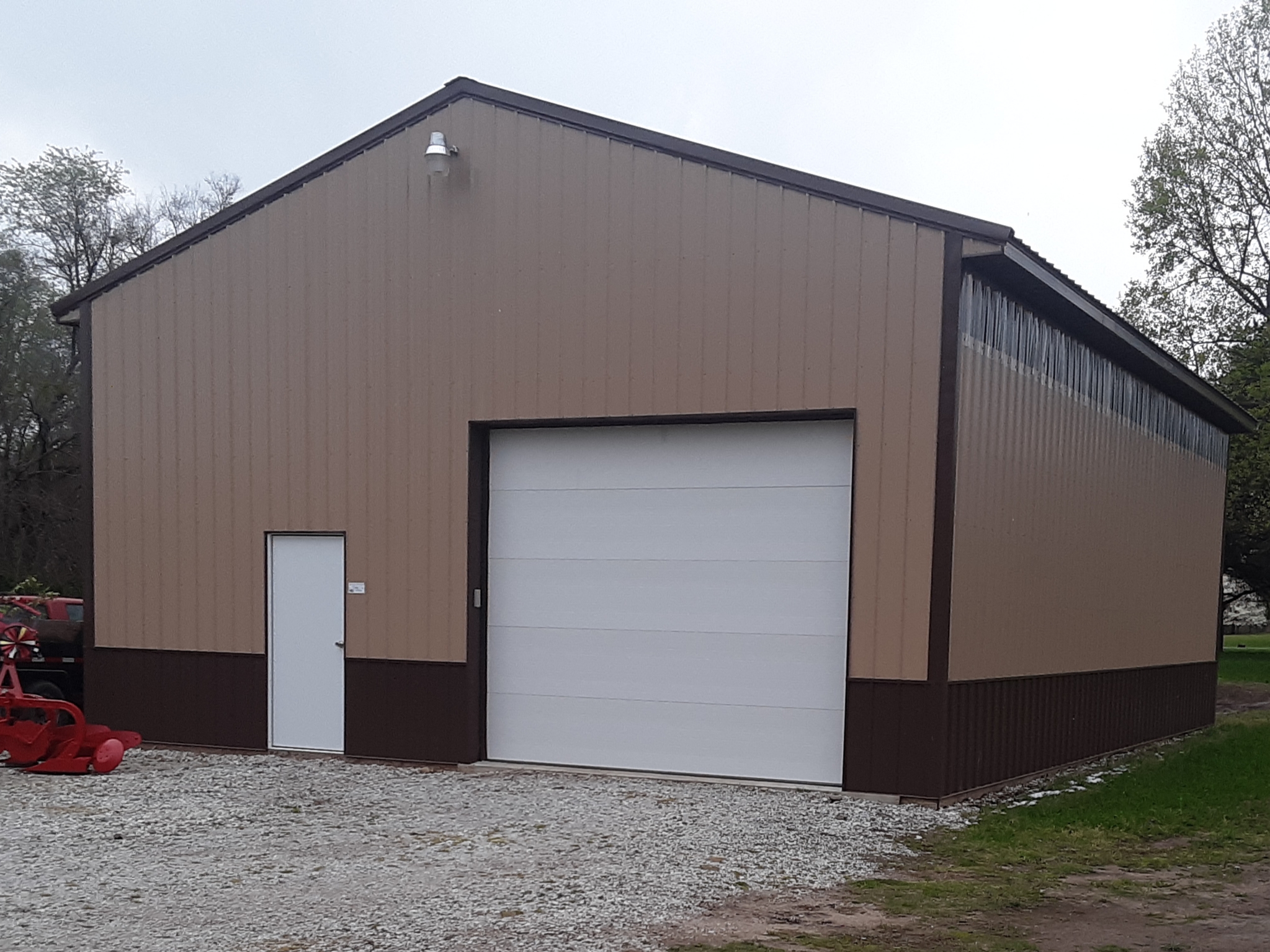

I wanted to build a pole barn on an empty lot next to my house.
Area planning said no pole barn unless there is a house on it.
I had my empty 3/4 acre lot attached to my houses lot.
So do your homework before building.
I know a man who didn't do his homework and was forced to remove his pole barn after it was built.
Talk to your county assessor first, I wanted a bigger pole barn than a 30x40.
The assessed value of a large pole would cost me more in property taxes than my 3 bedroom brick 2000 ft house with basement and 2 car garage.
I settled for going taller and adding a loft. I use my Kubota to lift objects to the second floor.
That cut my property taxes in half. Go taller vs bigger.
If I had it to do again, I would have gone 14.5 feet vs 14.
I strongly recommend having vented eaves, ridge vent, and clear siding under the eves,
The Amish built this barn in 2 days. The cost in 2019 was $16500 without the floor. I did the wiring.
Please do your homework,

View attachment 115284 View attachment 115284
