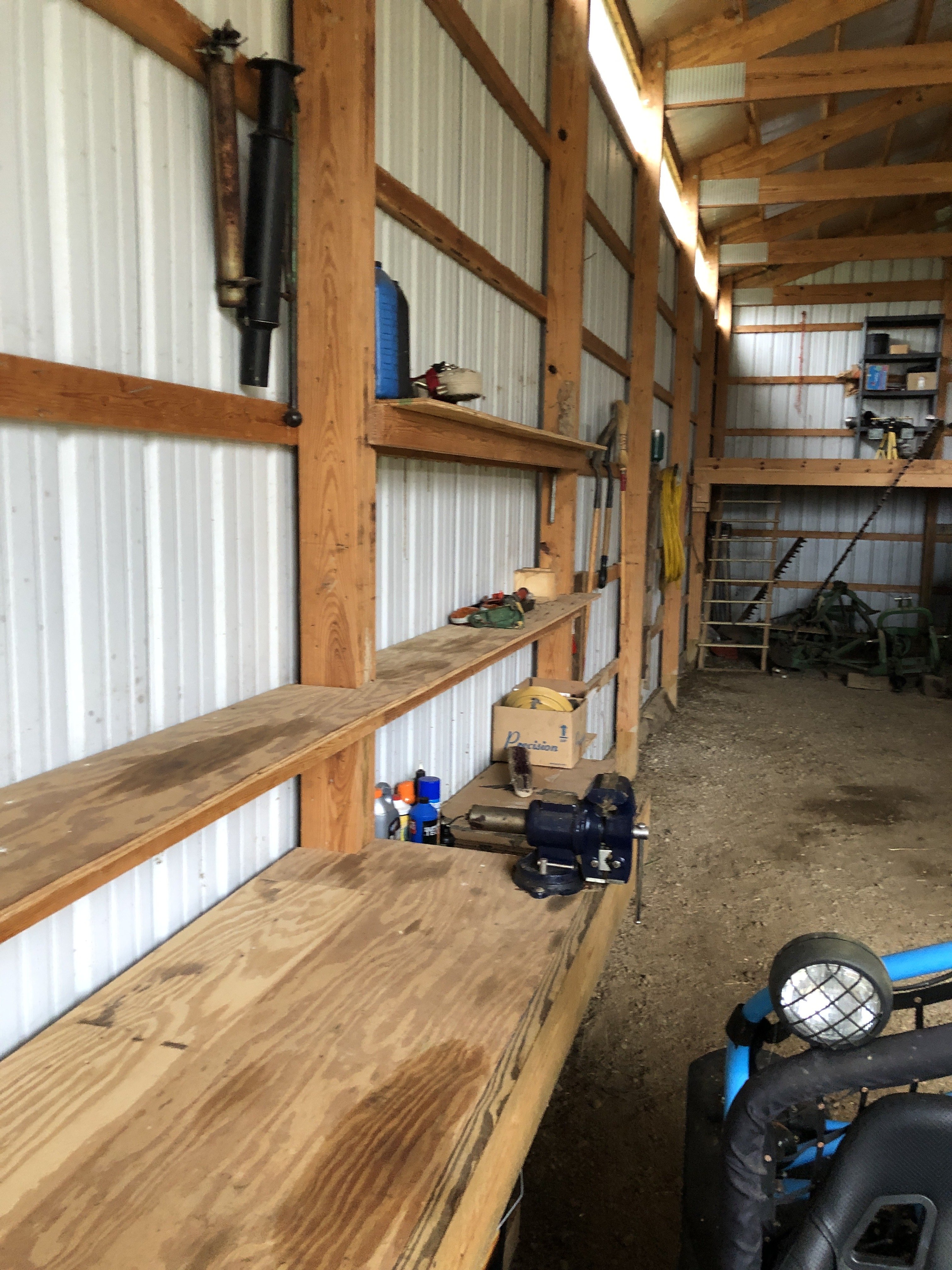

Oh no! You are going to get a lot of opinions. Much of the “best answers” will come from local folks that have built recently. A few (perhaps unsolicited) comments on pole barns (again, opinions will vary)—-
1. If you can, go 14’ or even 16’ eves. Height is usually cheap, and opens up a lot of options
2. I like 8’ centers trusses. No need for header boards, as trusses fit on top of posts.
3. Use clear panels on top (1-2’) of each side wall. Lets in a lot of natural light, and is not prone to future leaks the way that clear roof panels are.
4. I used the wall purlins to help build wall shelving (see photo)
Good luck!
