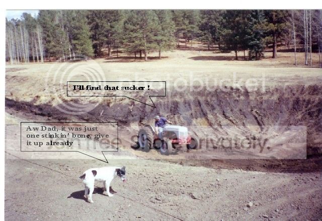

Used one for hundreds of hours over the decades, but I will say that if you are thinking "ponds", just remember that using one of these is akin to ants moving sand, one grain at a time.
