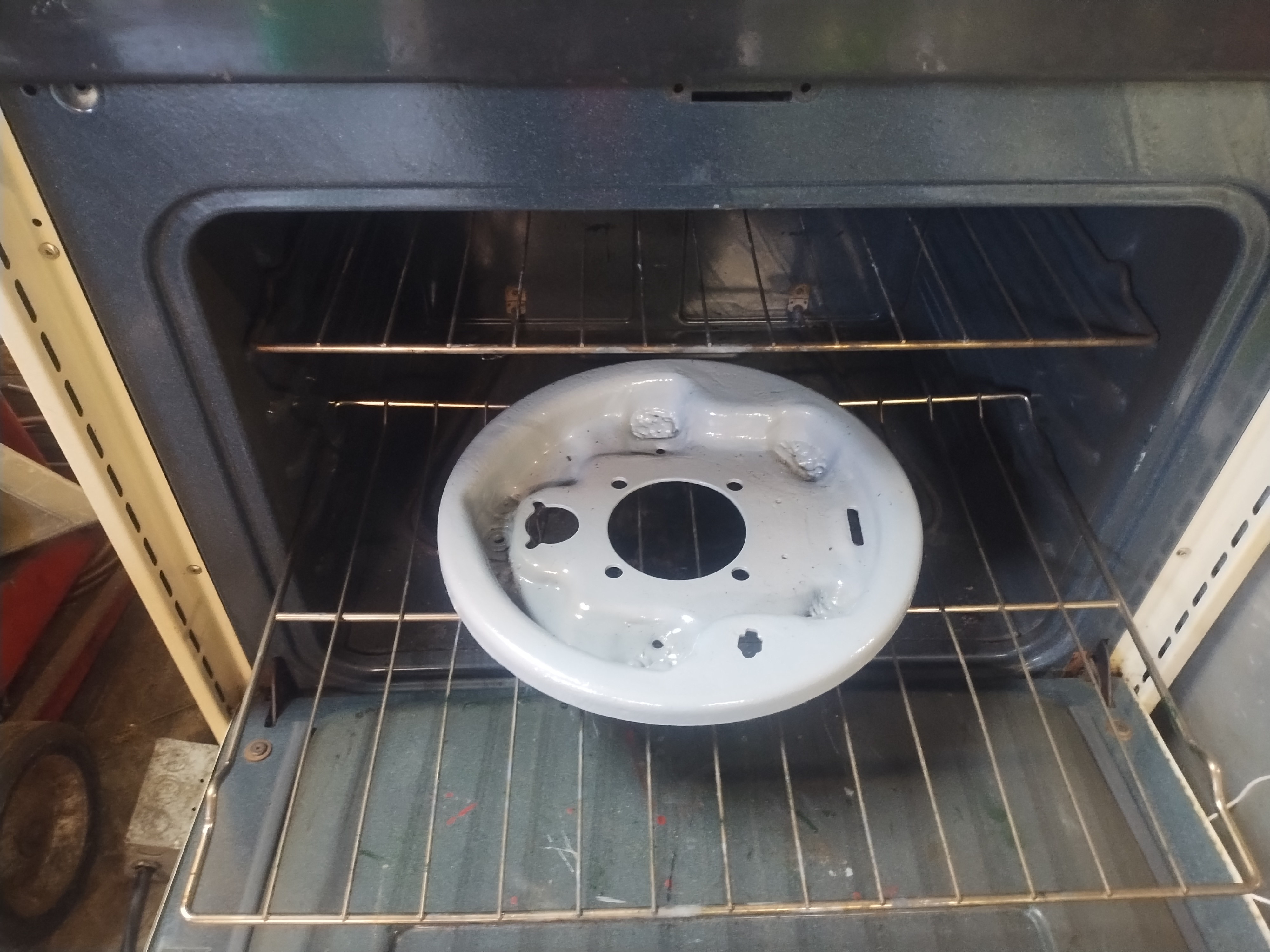

The $40 oven I got from CL still working somewhat. It's a free standing one with a stove top. I removed and scrapped the coils. It works ok for hanging parts from the racks with hooks made from cut up coat hangers. But if I have to use the racks like you would with cookie sheets and slide something in on the racks it's not ideal. It has an upper and a lower heating element. I've never seen the upper one lit up. I had a pair of 3/4 ton truck brake rotors in there. (I just coated the fins and the hubs) and I keep track of temps with an infrared temp gun .. the lower rotor was 50* hotter than the top one, the lower one being closer to the temp I have the timer set to.
And im tired of dropping my freshly coated parts because of having to bend over and hang them from the racks with needle nose while wearing welding gloves.
So for the price of an upper heating element from the local used appliance place I found a "built in" style double oven that even came still mounted in its kitchen cabinet.... So I can load and unload parts straight in and out without so much bending down. With the double configuration each compartment is smaller but overall I have more top to bottom space. It is narrower, as it's only a 24" oven vs the free standing one being 30.... I'm gonna see if I can squeeze both of them in the space I have since the first one does still work....

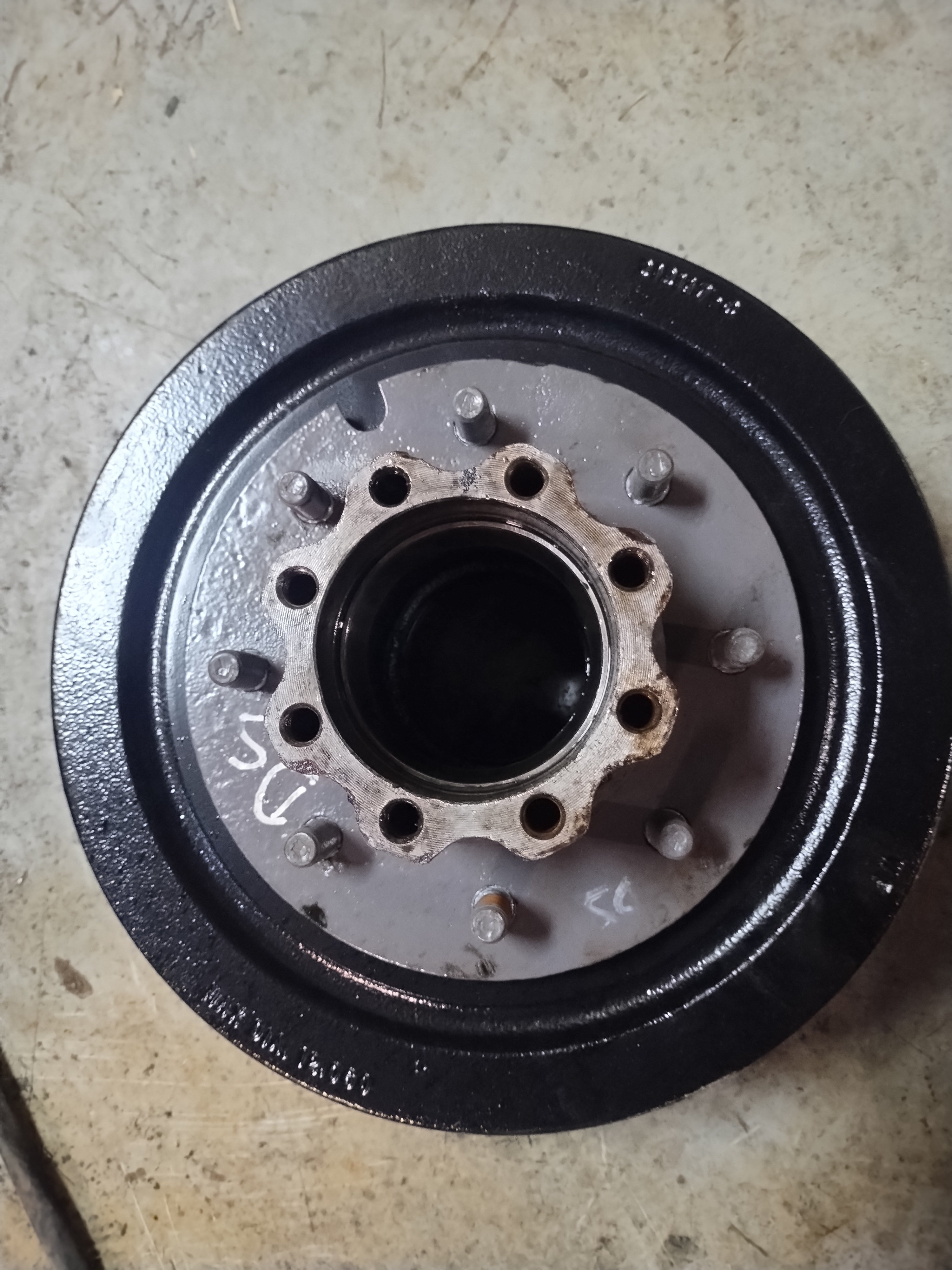

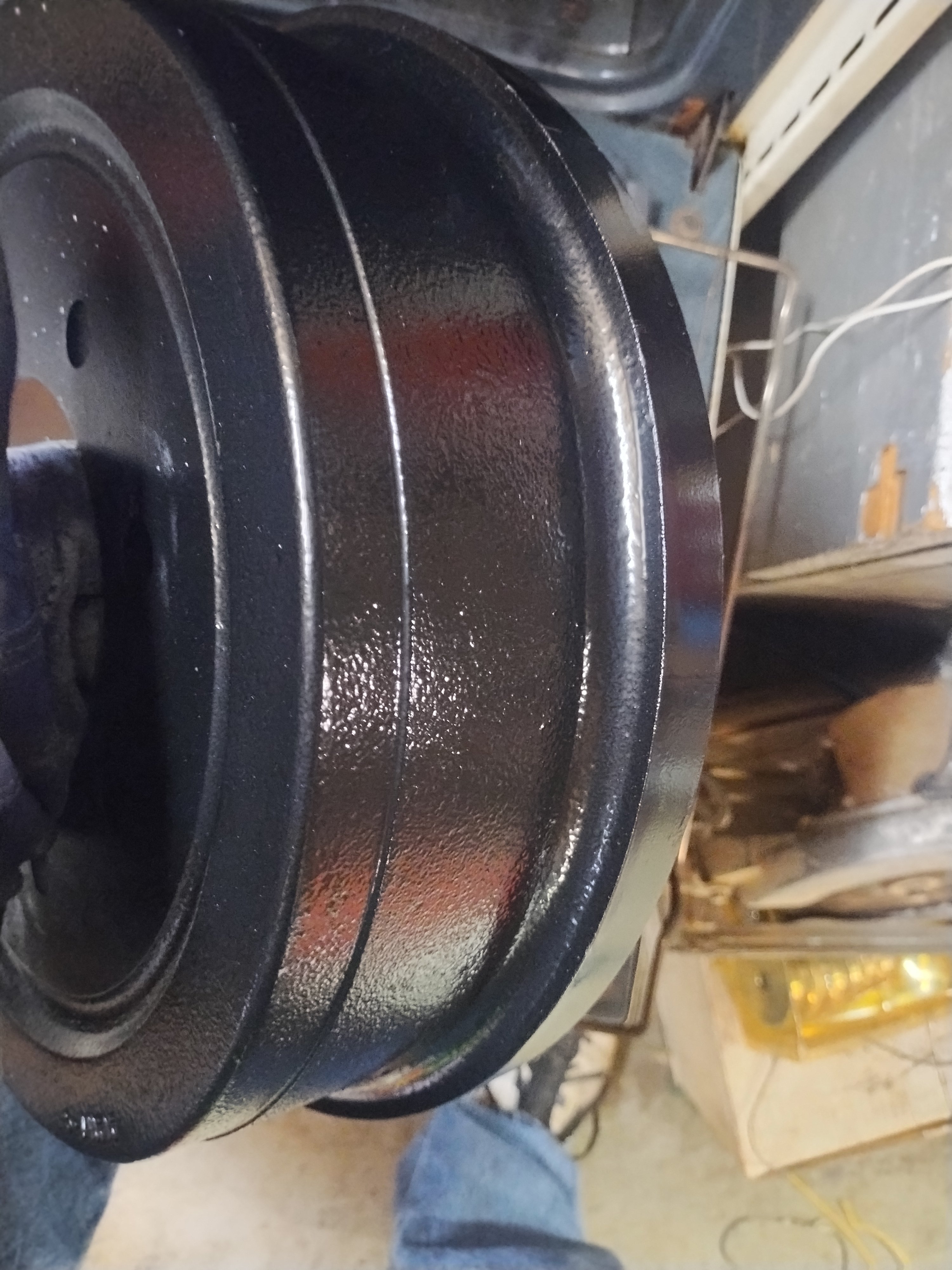

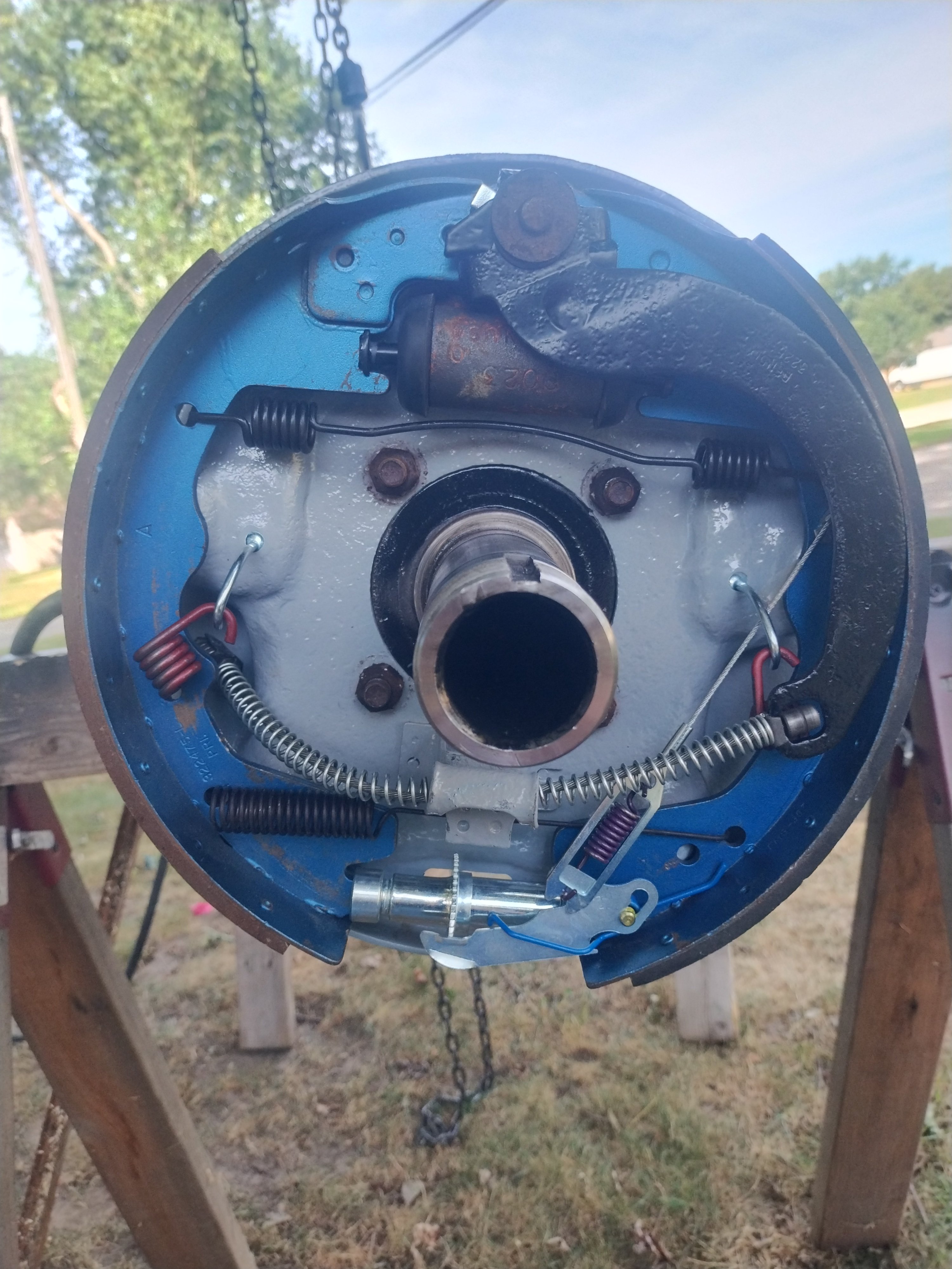

I powder coated the drums but not the hubs (I didn't want to have to fight getting any leftover sand crystals out of the cavity that would eat my bearings) the wheel studs hold the drum and hub together. The backing plate (gray) is powder coated as well as the e brake lever and the little plungers that stick into each side of the wheel cylinders. The hub is 2k epoxy painted after the whole rear end was blasted and painted with that while the whole rear was still together and sealed up... That 2k was actually a primer (Sherwin Williams industrial/Marine grade) but is still said to be a 15-20 year paint product. I did spray paint the rest of the rear end housing over that 2k primer in semi gloss black with another industrial epoxy 2k Sherwin Williams paint called high solids polyurethane.
(A Dana 60 won't fit in a standard kitchen oven)
Everything I powder coated here was primed with powder primer and cooked/cured as label said which was a little cooler than the black and gray you see for about half of the time of the coat you see in the pix. I pulled these parts out warm and put the color coat on "heated up" and then put the parts back on the oven at the full 400* for 20 minutes after the parts were at oven temp as monitored by a hand held infrared temp checker. I got the oven cheap enough from Craigslist, cheap enough it craps out I go get another one and the gun I got from Eastwood is always on some kind of sale deal..
