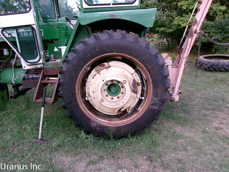

Power Adjust Rim Jackscrew
Never got around to putting this up. Probably a year ago I'm thinking.
Needed to switch out a tire.

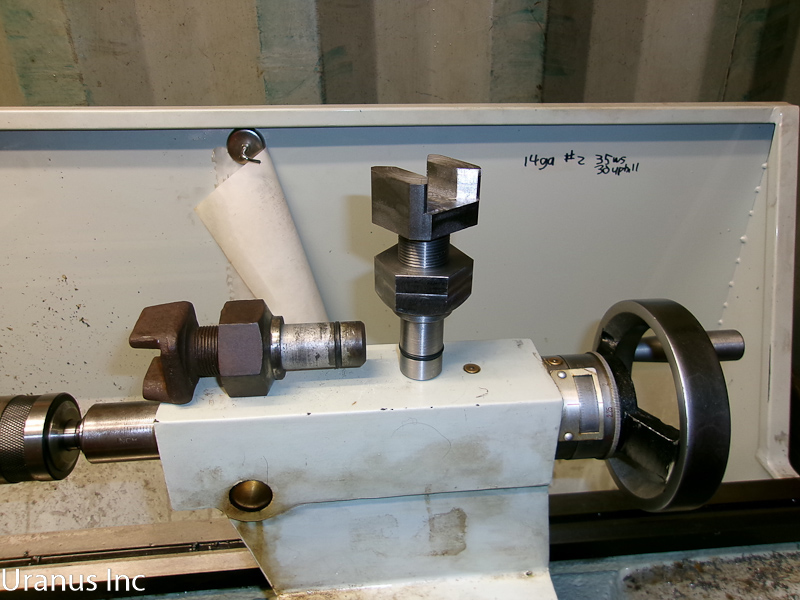

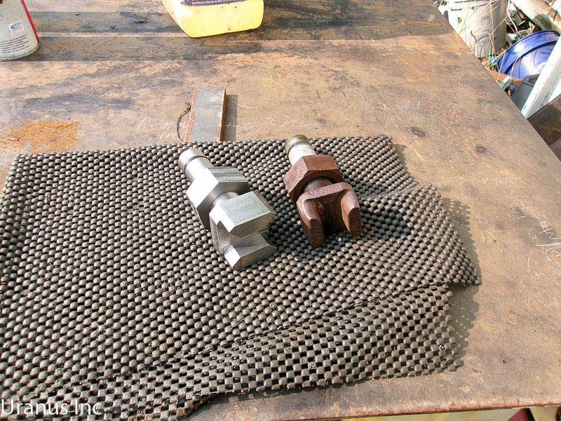

One of the jackscrews was cracked clean in half. No.........you can't buy a new one........most are different sizes. Second hand ones are usually in bad shape if you can find the right size. Believe me......I tried going down this road. Spent half a day on the phone, and in front of the screen,, then decided it was just as easy to make the stupid thing.
The thread was cut to tolerance, as spec'd in Machinery's. This is a situation where I'm not going to simply cut the thread to fit an old bolt. All of the bolts remaining on the tractor were in pretty lousy shape (machinist wise). This thread must fit any commercially available nut in the size. Thread mic's are VERY nice if you do a lot of threading

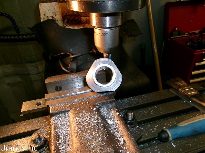

Being as all of the nuts on the tractor are old, and slightly damaged, it's time for a new nut. Might as well go all in if you're gonna do it.
Because the screw was cut to tolerance, it could be used as a gauge for the thread in the nut. No need to make a plug gauge.

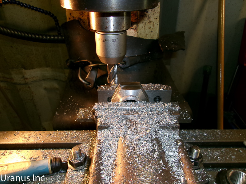

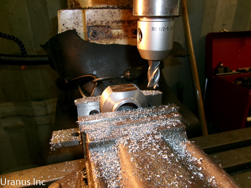

Can't turn a nut without flats.......................................................

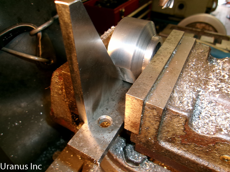

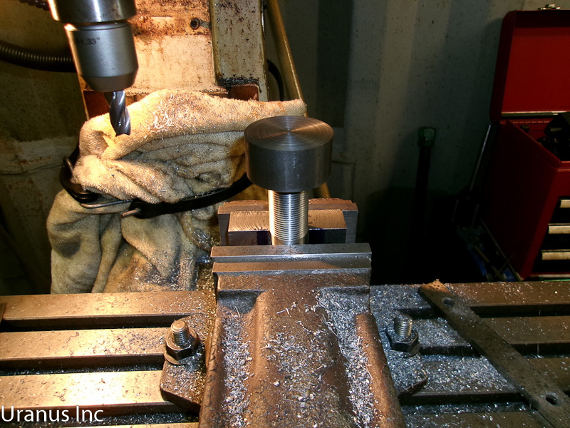

At this point, it's time to finish the head of the screw.
Had to knock out a V block to hold the thing, then machine it

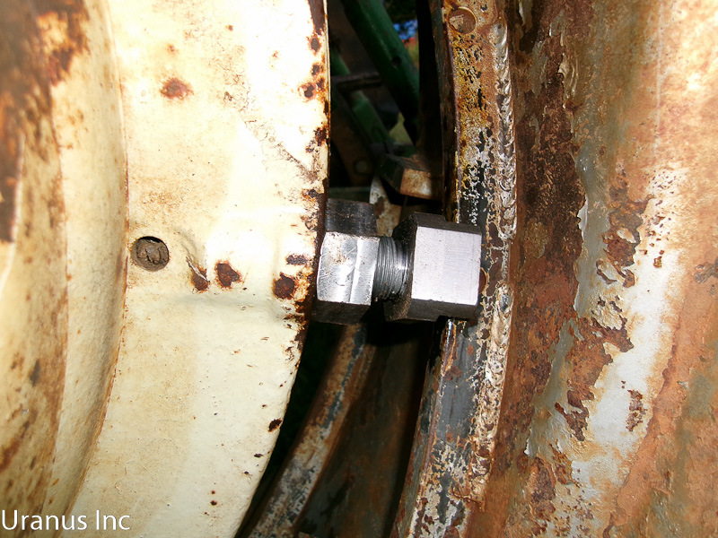

Not familiar with Oliver spin out wheels, what is the purpose of this part?

They were pushing to be the plow king at that time, goes back to 56' on the Super series. Then the three digits and on. Set wide tire tread for discing, pulling, stability, set narrowing for the correct plow settings or picker too, or cultivating. GG Wes
I know what spin out wheels are, but any of them I dealt with you didn’t have to have a tool to do it.

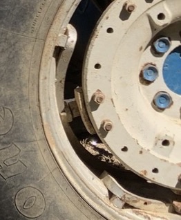

Looks like the same jack screws my 4000 Ford has
Probably "look" pretty close to what you have. I've seen some from Miller Tire that look to be the ones for a Ford, or something that like the Ford. Mine are larger diameter. Almost impossible to find, unless you can get them used.
This is the only new stuff out there,, as far as I could discover. They're not suitable for the Oliver.
