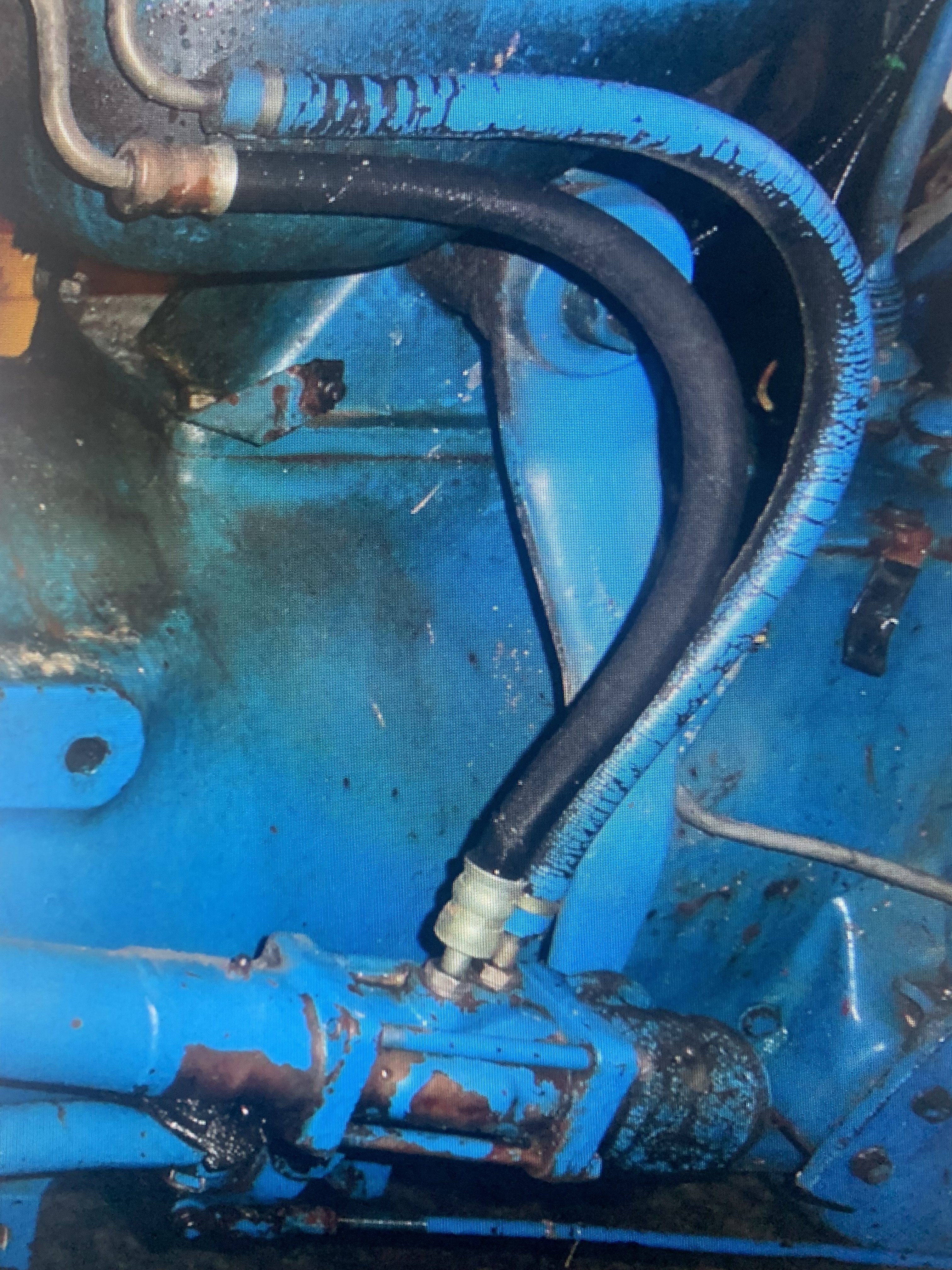

Hello everyone this is my first post. I have 1968 ford 4000 3 cyl diesel. I have been having issues with my power steering cylinder. The power steering works good not great but after about an hour of running the tractor, the cylinder is very hot to the point where if you left your hand on the cylinder it would burn you. I have searched for answers but have not found any similar posts thats why i am making this post. I have attached a picture of the cylinder. Any help will be appreciated this is my first tractor and am willing to learn and work on it.

I have a leak on the hose that is clamped now. Should this hose be clamped? Or should I replaced it with a crimped fitting?
It looks like fuel hose, that is the wrong type of hose. Should be a pressure rated hydraulic hose with proper crimped fittings. And I am guessing the brass adapter does not have the right threads and seating arrangement to match the port in the cylinder. It should be a hose similar to the other hose.
Thank you. Looks like I inherited someone's handy work lol. Is that pressure or return line? The other end of the line goes to a metal line where it is hose clamped again and that metal line goes to the reservoir. I assume its return line.
The parts drawing says that line is the return line. The pressure line can experience up to 850 psi if you turn the steering wheel to full stop left or right. Depending on how clean the filter is, that return line can experience up to a few hundred psi. The cleaner the filter, the lower the pressure on the return line.

It’s a heavy nylon braided hose with clamps, not a crimped hydraulic line
I would find a good straight fitting and use at minimum fuel hose rated for fuel injection which is at around 100 psi rated
