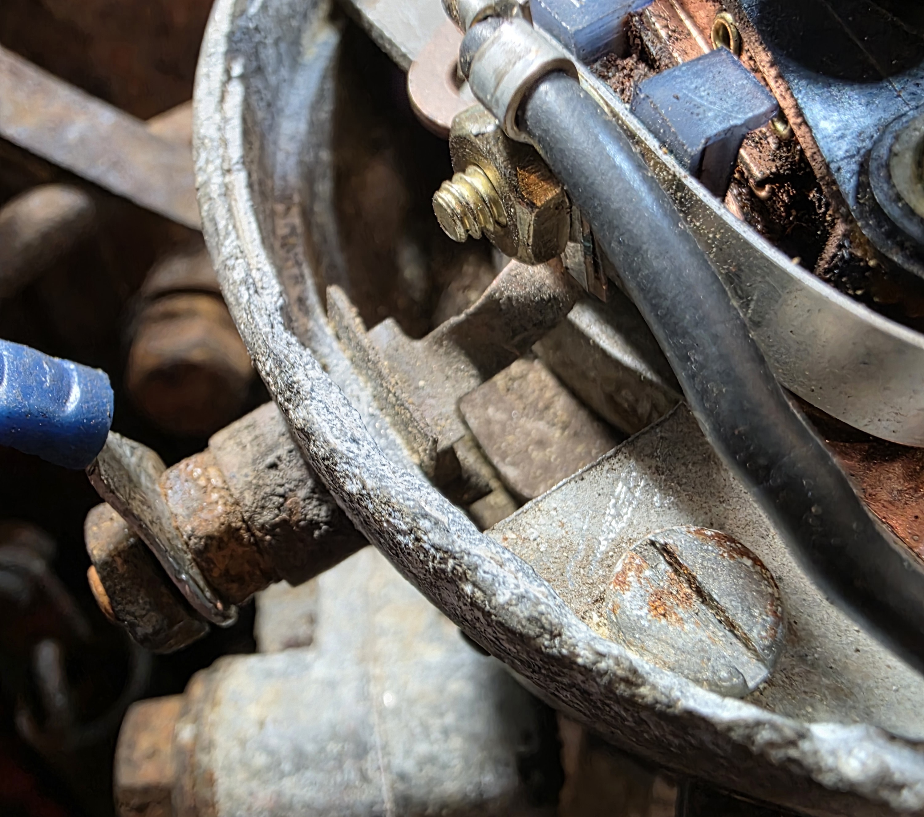

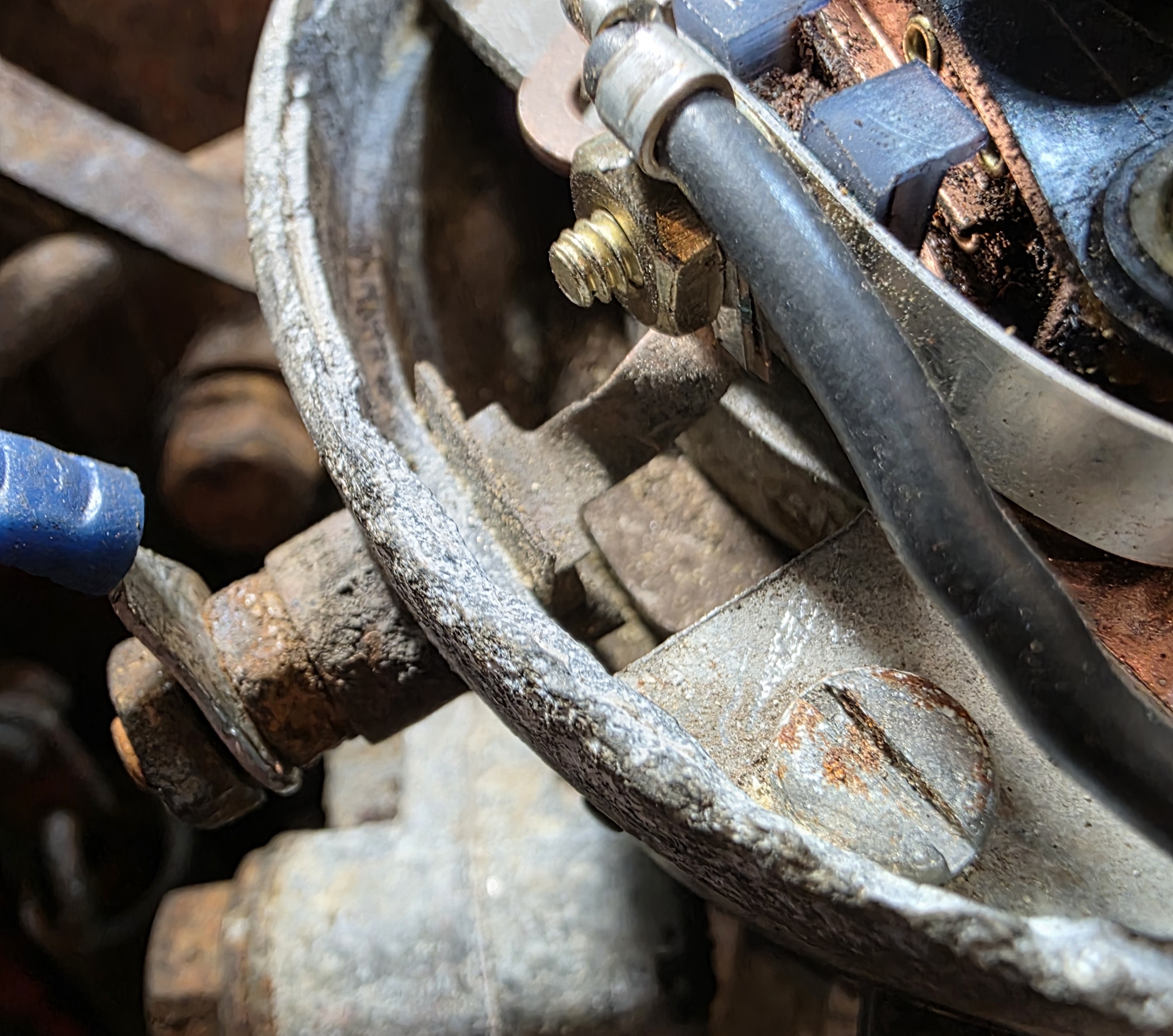

Months ago I purchased a new primary conductor and insulator/seal my machine never had one when I bought it. I just wanted it back to original. Have read since that many would rather just use a grommet to seal the opening on the distributor. My ask is this: can anyone take a picture of the proper orientation of this aftermarket part when installed? I get the basic idea, but it appears to only go one way Correctly. I have searched high and low for a good photo.
Hi TJ64,
The black bushing large diameter is to the outside, and its smaller diameter goes into the dist hole.
Here is an old one
Copper strip goes on the terminal first, then the squarish insulator, then through the bushing, then first nut squeezes tight--- in theory.
