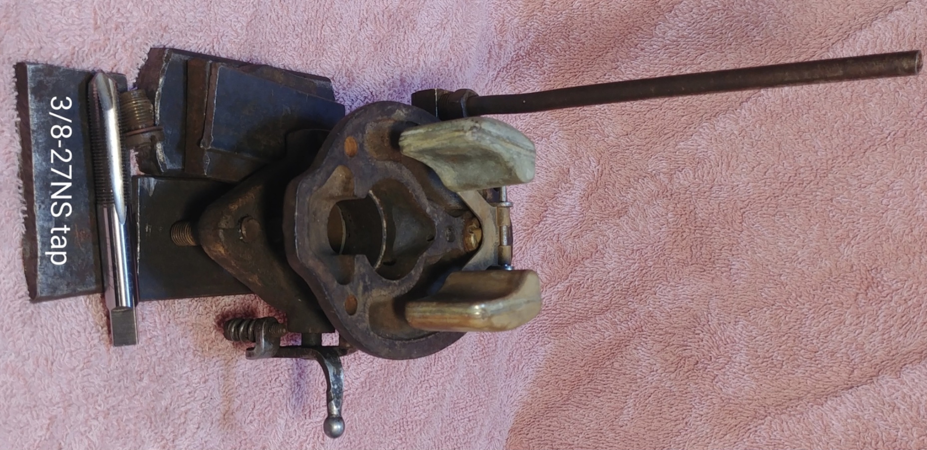

Hi Jim,
Did you run a 3/8 - 27NS tap down the threads for the float seat?
Sometimes the old cast iron threads grab the seat tight, but before the crush washer can seal. Gas leaks out past the threads and loose crush washer and is difficult to find.
If plumb a short bit of fuel line, to the upside down top half, and place paper towel or TP under, gas from the fuel line will either leak out, or not. Wet paper is easy to see...
Pic is rotated on its side to save scrolling...

Thanks soaked,
I would have used the tap route if I had one, but I realized the washer was loose after my first attempt and gradually got it tightened down enough to stop a leak. That left several more days of trying to find where the new stuff was leaking. I made a jig where I could work on the carb right side up at eye level, using various strength rubber bands to control the float.
The new drain plug may have worked with tapping the hole, but I went back to using the old plug with an o ring. I am still not sure if the new plug might not be pipe threaded, but I never got it to seal.
I have a graduated feed tube going into the fuel inlet. I thought the drain plug would stop the leaking, but I still can't get a 12 hour period where the needle system seems to hold.
Any other thoughts would be welcome. I am an old man working on an great old machine and I have plenty of time to get it right.
Hi Harry, I've been meaning to grind it down also, but there is room to run it down far enough to chase the threads as is:)

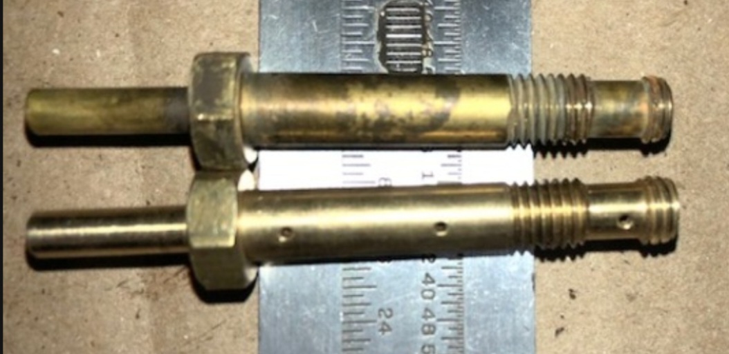

Your Marvel Schebler carb came with 1/8 pipe on the drain plug.
One of my older aluminum clones has BSPT thread-- and no crush washer.
Had a newer clone with crush washer, thinking it was British Special straight thread, but not positive.

Wonder if the nozzle crush washer is sealing. Is the new nozzle identical to the old one? I seem to remember a post where the new nozzle had longer threads at the bottom, allowing it to touch the main jet before the nozzle crush washer could seal tight.
I will check again.

Found the post from TJ in KY, this was his pic.
New one is longer...
Main jet tube? Does have any effect on fuel level or needle valve closure?

If the nozzle washer leaks fuel into the throat, the needle will stay open trying to fill the bowl to the 1/4" setting. (The lower part of the washer is .5 to .6 below the gasket surface.)
Of course it would have nothing to do with needle to seat fitment, or leaks found there.
