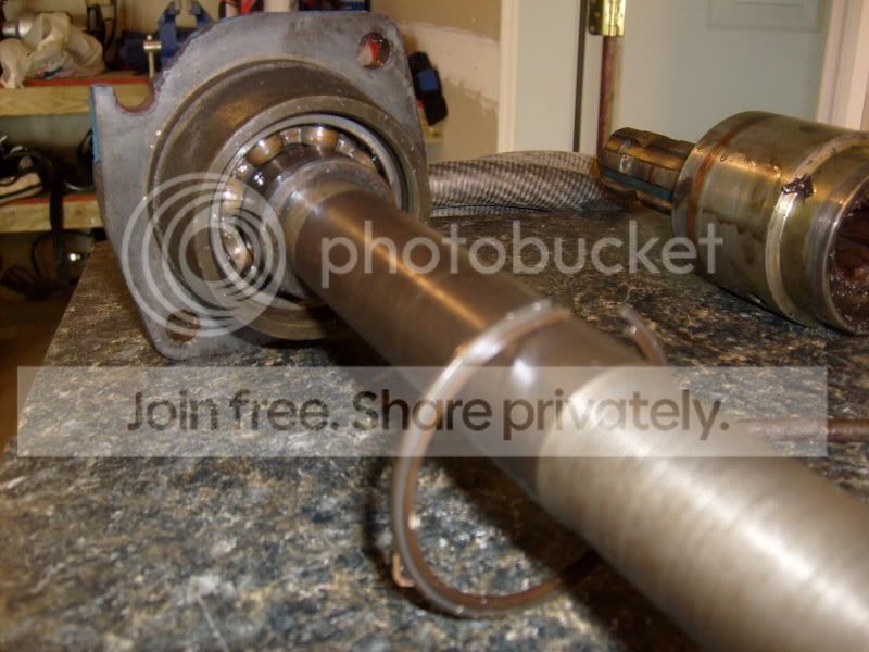

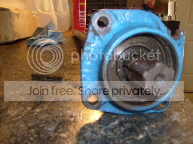

How the heck do I get this bearing off? According to the
manual you take the one snap ring of (which I did), then the
bearing, then another snap ring and then the oil seal (which
is ultimately what I'm trying to accomplish here).
Thanks!
Now you pick up the pto shaft by the end that goes inside the tractor, bang the outter splined end down on a block of wood to pop the bearing out of the housing, remove and replace the seal and put it back together. You're almost done.
Ahhh thanks a million!
Usually whenever I use blunt force I end up destroying something.
Figured I'd ask this time around. :D
