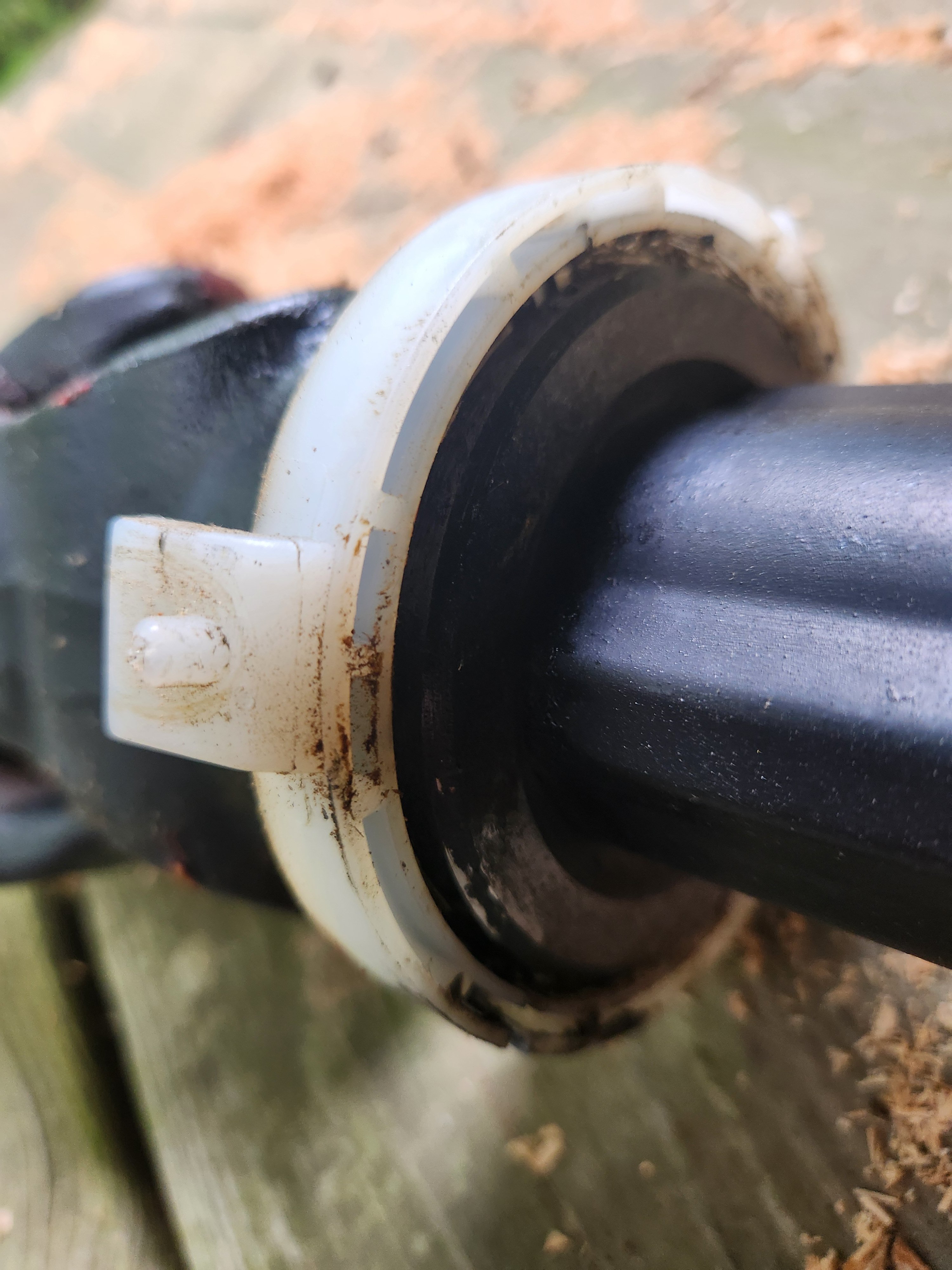

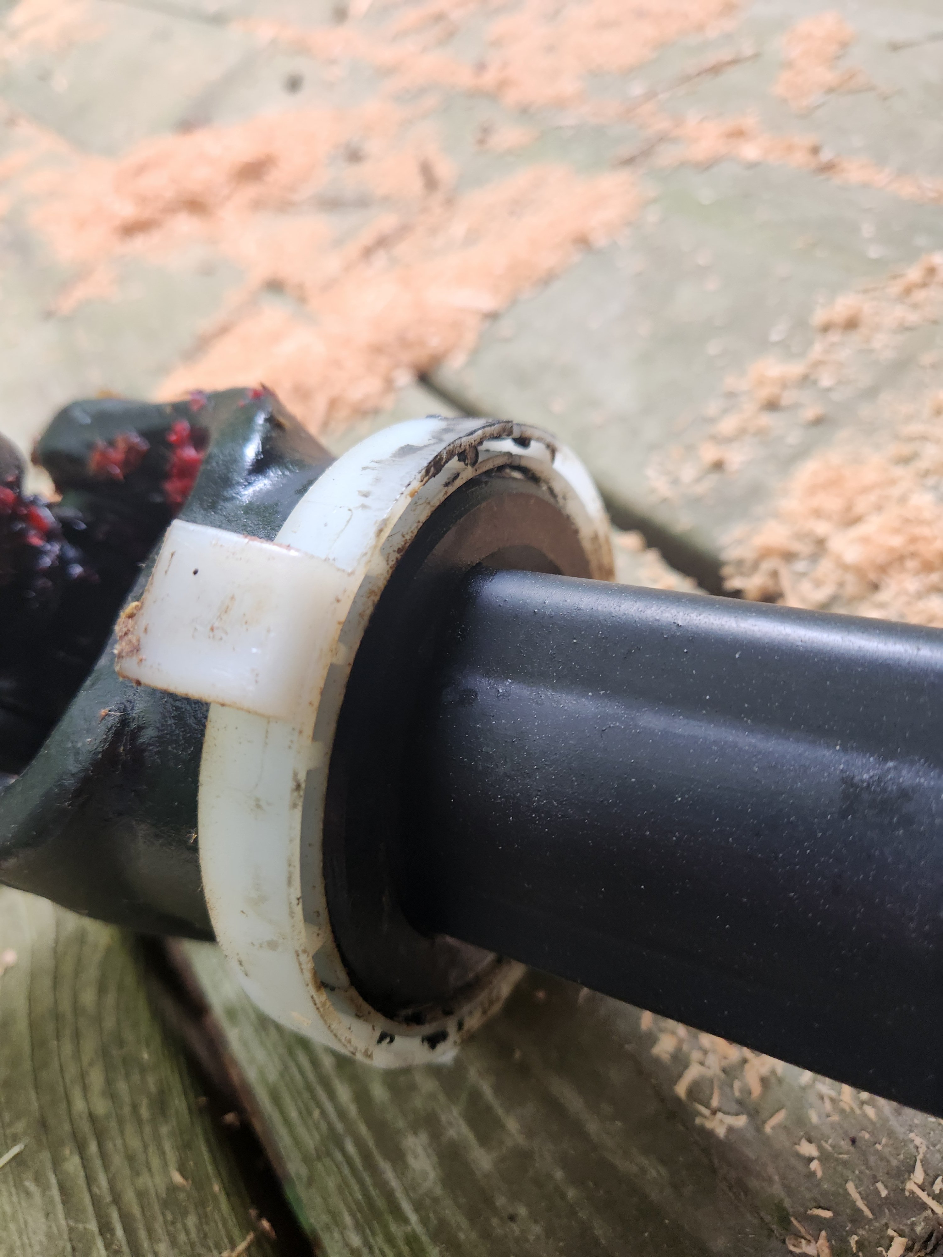

This "coller" for the inner shield is missing. Been doing some online shopping but can't seem to locate an exact match.
Any assistance as to proper name and source would be much appreciated.
At the risk of being piled on for criticizing spelling, it's "collar." Of course by the looks of things that's a Euro style PTO shaft so it's probably called a "dzusenflurgenschnitzen" or something...
There are at least a dozen different styles and at least 3 sizes per style so you're going to need to be more specific. What piece of machinery is it off of? What shape is the shaft? Got a wider shot of the entire assembly?
Yeah, spelling has fallen by the wayside this morning trying to cover too many bases.

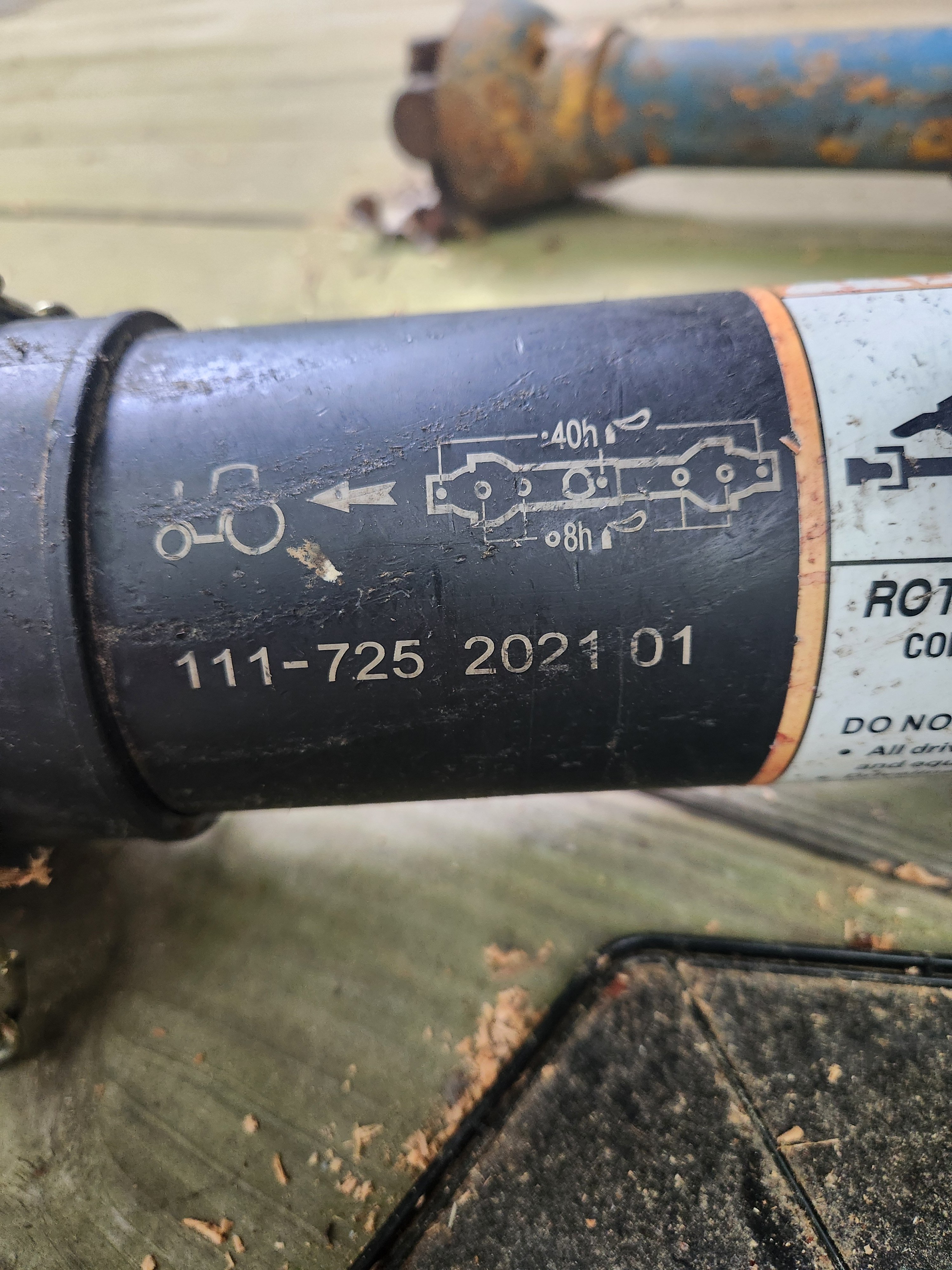

The inner shaft is bent and is at my local guy getting the pin driven out so we can remove the yoke. Rough measurement look like it's a 7 shaft size.
The shaft is new enough that the paint is still good; only about 8 hrs run time. My best guess is the dealer cut the shaft incorrectly. It's only been on 1 tractor. They did the fit up at time of delivery. The other half [external] looks fine and true.
It's off a Titan flail mower.
Can't photo the entire assembly since the inner half is in the shop in town.
