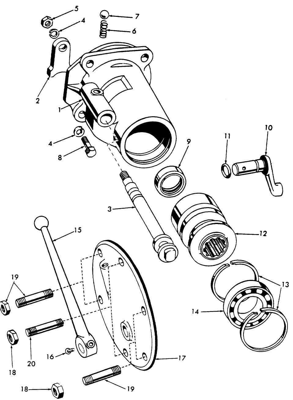

On the splined shafts above, the collar slides back and forth, in my mind I believe that the PTO clutch #12 is hanging up.
The bar on either end puts a strain on the shifter shaft, then once it breaks free, it slide to the other end, and the same in reverse.

Part number 12 in that diagram is what I was calling the coupler in my earlier post. What part number are you calling the "collar"? If part #12 does not slide freely when it is at one end or the other of its range of motion, then there ares a couple of possibilities. The first one is rust, and that can be overcome using good penetrating oil and moving the coupler repeatedly over time. The second is that the splines on one, or both, of the shafts are damaged in some way, most likely slightly twisted.
Isn't #12 located inside #1. There is a coupler that slides back and forth to the right of #13 & #14, that is not shown.
#3 is connected to #2, and #2's curved end is in the slot of #1 and in the grove of #12 in #1 and slide back and forth, move the lever #15 which rotates #10.
