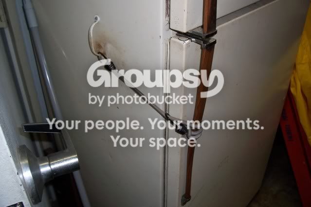

A bungee is not the answer,,, Fix it leave the riggernig'n to those that don't know chit about what they are talk'n about....
Their are places they work tho
