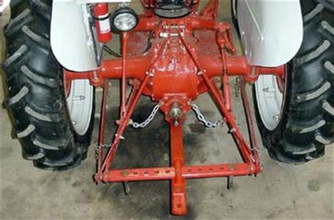

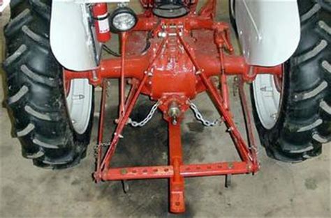

What, no stabilizer arms from top link pin to drawbar? Every old Ford and Massey Ferguson came with them standard equipment.Unless you've invested in stay bars, the drawbar on a 9N has nothing to keep it from rising up. It floats on the three point arms, and can end up as high as the arms go. if the chain slides up the tree, it will pull the drawbar up with it. that's how. the only N without that issue is an 8N with a drawbar bolted to the bottom of the differential casting. You can't do that with a 9N.

I'm not sure if I've ever seen an old Massey of Ford with those bars. Usually all the stabilizer bars are missing, and the lower 3pt arms are just dangling.What, no stabilizer arms from top link pin to drawbar? Every old Ford and Massey Ferguson came with them standard equipment.
No, they did not. I have no idea what Massey Fergusons came with, but Ford Ns absolutely did not come with those as standard equipment.What, no stabilizer arms from top link pin to drawbar? Every old Ford and Massey Ferguson came with them standard equipment.

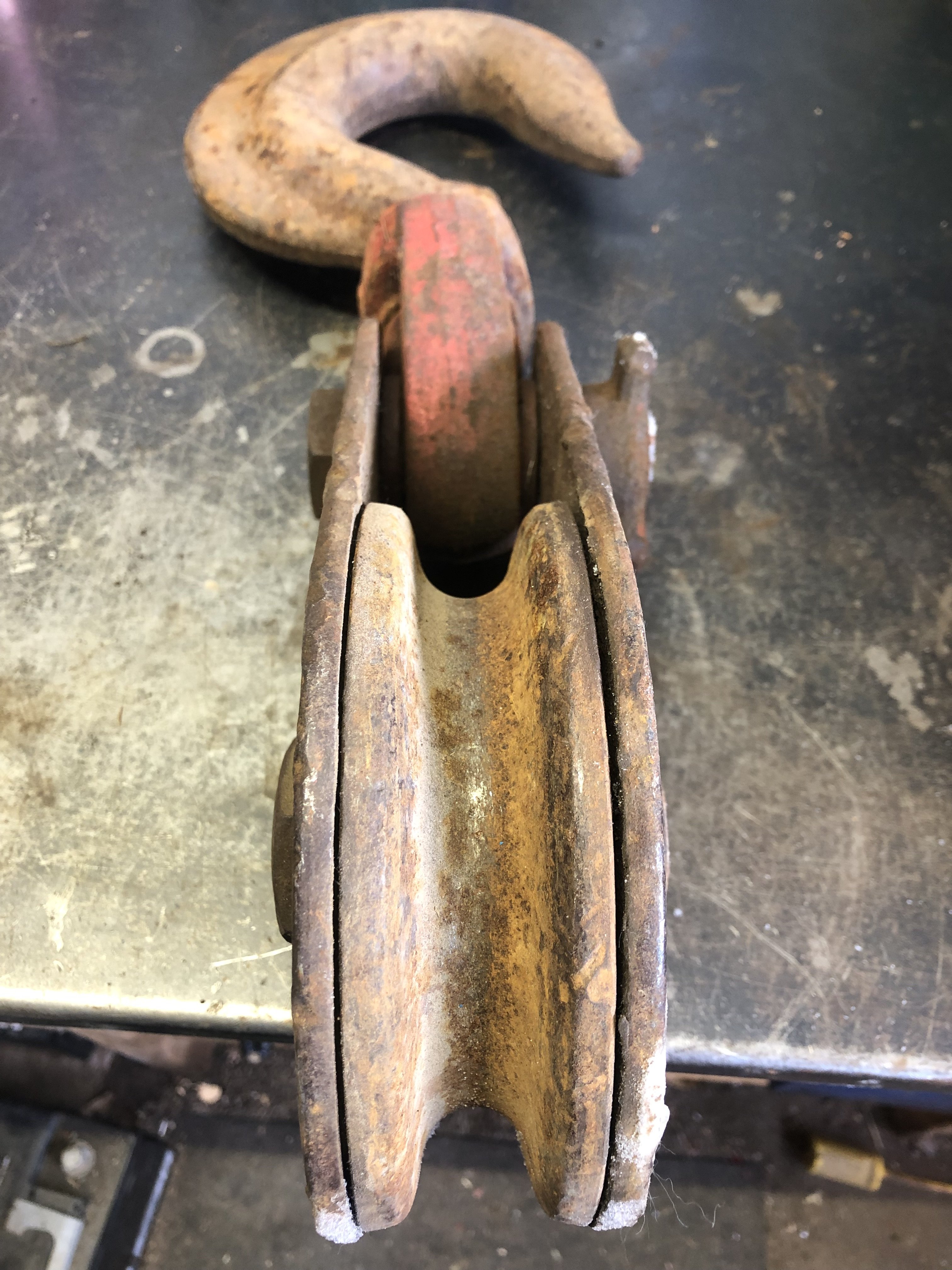

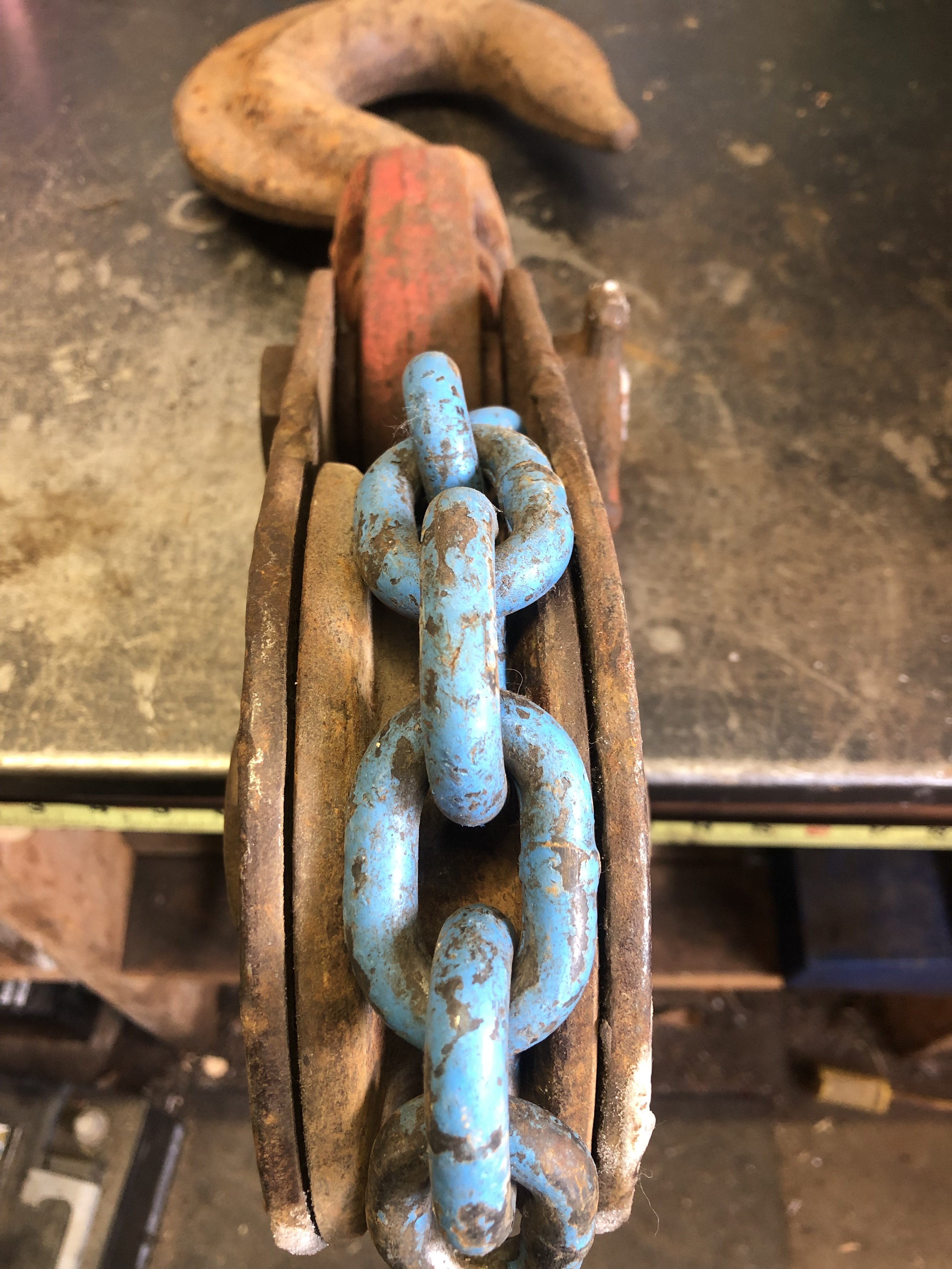

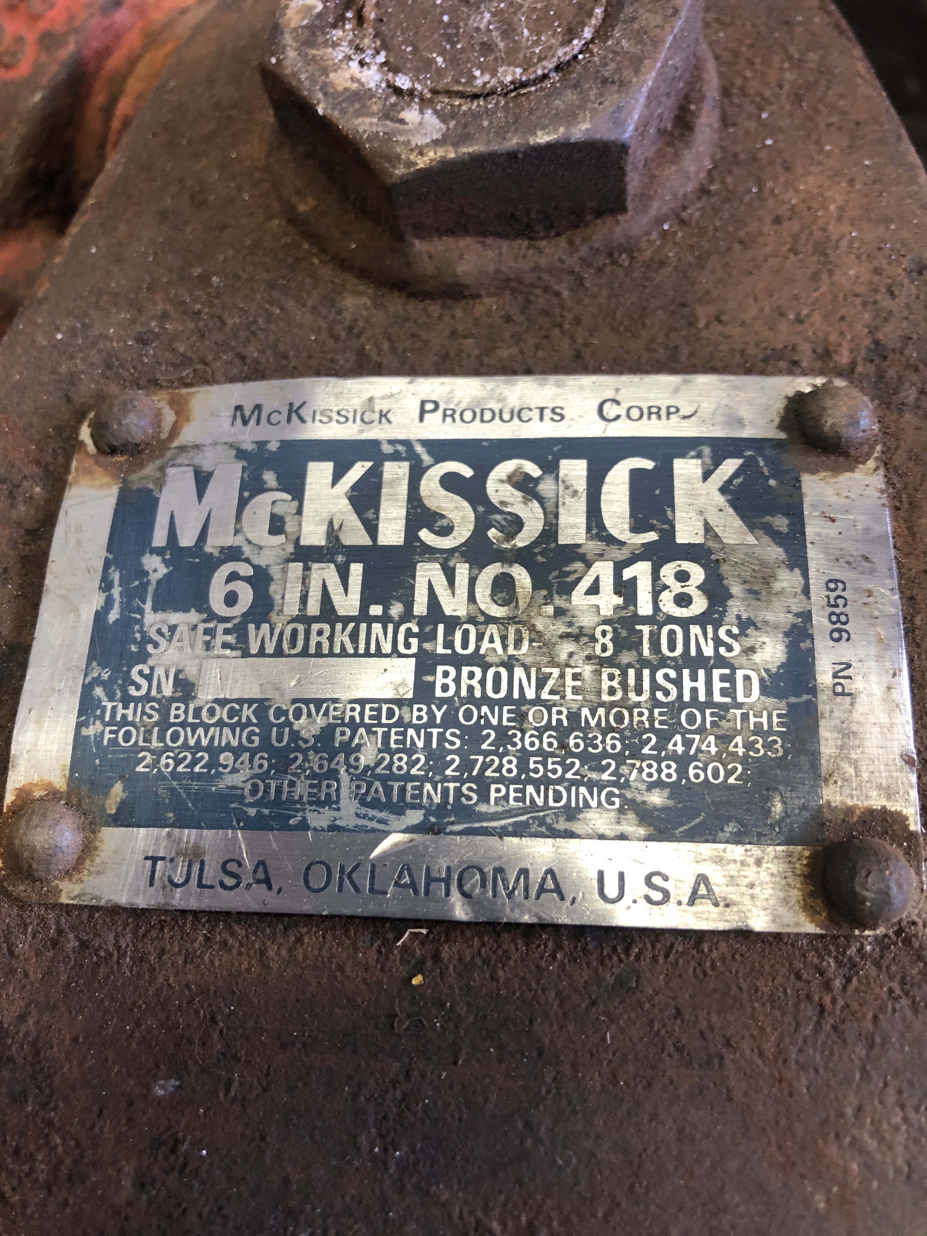

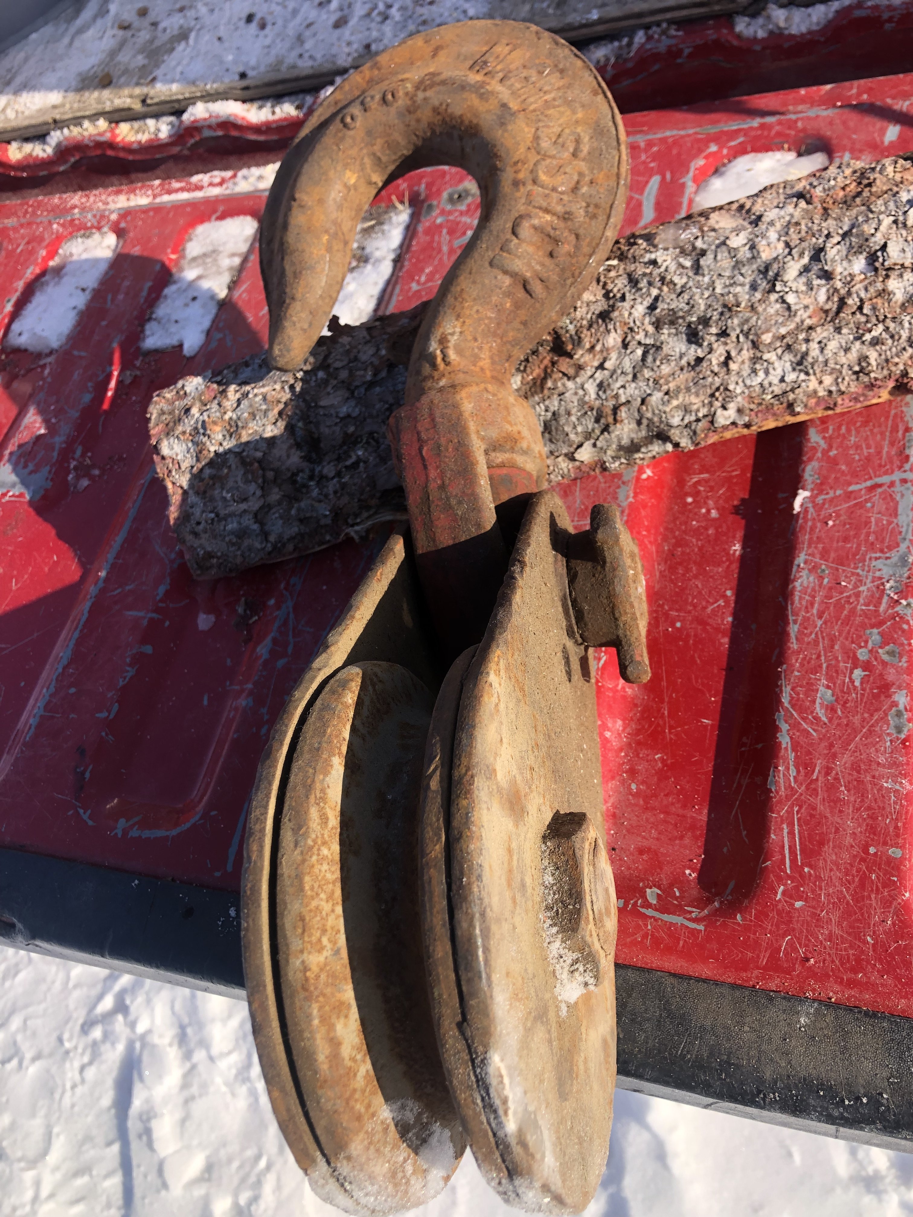

This is what I got. 6 inch 8 ton mckissick snatch block. And yes it handles a 3/8 chain. These are the top of the line equipment even made in the USA , not China.
Yes. Because they did. Neither of those sets of bars are original factory equipment, no matter how many times you choose to insist they are. Sorry. but you are mistaken about this.I wasn't referring to a specific Ford model.
Think about this; do you really think Ford or MF would sell you only the 3-pt drawbar to pull a wagon with, and no way to hold it solidly in place?
BTW, that picture is of a fully-restored, all original Ford tractor.
For reference, the drawbar stay bars are shown/listed in the Ford parts catalogs for the 2N, 9N, and 8N tractors. Also, they are in some of the instruction manuals for those tractors. They may not have been shipped with every tractor, but it appears they were available as OEM equipment for/on those tractors.Yes. Because they did. Neither of those sets of bars are original factory equipment, no matter how many times you choose to insist they are. Sorry. but you are mistaken about this.
And again, you are the only one talking about MF tractors. Maybe that's the source of your confusion.
I stand corrected. Ty, Jim. But I wonder if they were standard or optional, since, as Barny pointed out, most of the Ns one sees don't have them. Mine certainly didn't have them when i got it, and aside from the pics by a former member here, iI can't remember ever seeing an N with them. There are plenty of Ns in my area, and i've yet to see one with them. So - let's ask about the particular tractor in question. Mountain - does yours have them? If not, I would either buy a set - pretty sure they're still available as aftermarket - or, as In my case, I made my own. Without them, don't try to pull those stumps.For reference, the drawbar stay bars are shown/listed in the Ford parts catalogs for the 2N, 9N, and 8N tractors. Also, they are in some of the instruction manuals for those tractors. They may not have been shipped with every tractor, but it appears they were available as OEM equipment for/on those tractors.

Hard to say how many were shipped with the bars included and have had the bars set aside or discarded in the 80 years since the distribution of the 2N started followed by the other N models. My guess is If they were shipped, they were often soon seen as a nuisance and set aside.So I guess I should have added the word "standard"
