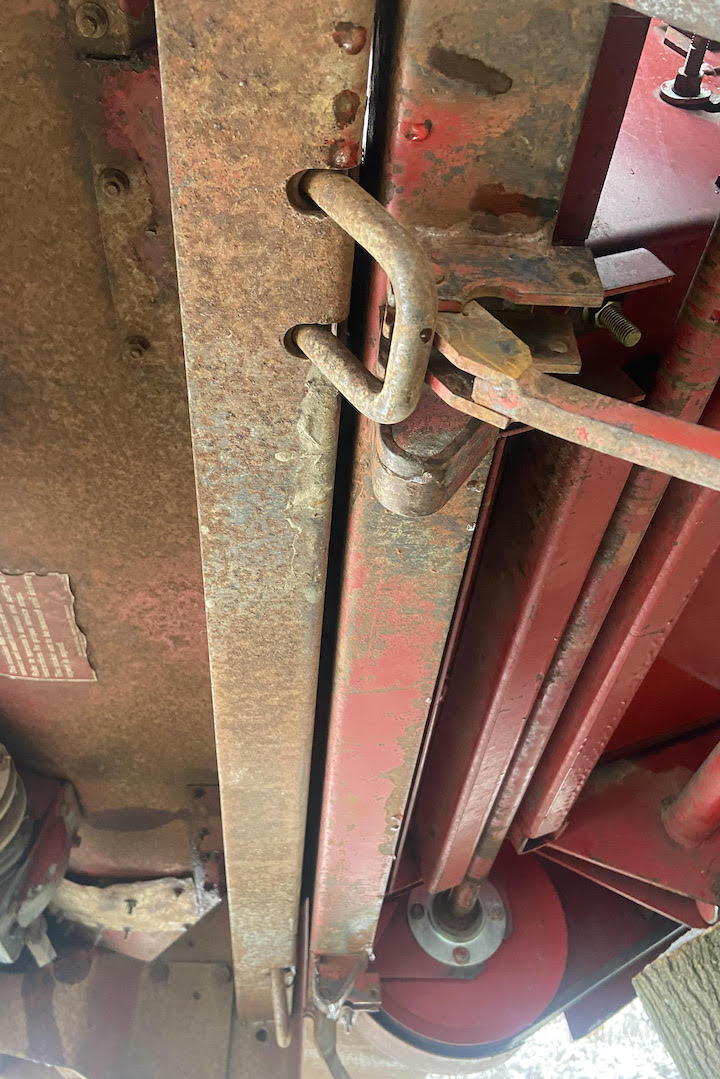

I'm trying to get an 863 corn head onto my CaseIH 1660, but there is a gap at the bottom, so I can't fasten the bottom clip.
How do you push the head on all the way, so the clip at the bottom will fasten? Is there a trick? Something I'm missing?
Or could something be bent/tweaked? Bought it used, my first time trying to put it on. It's on, just need a 1/4 inch more, the combine will lift it, I can drive it around.
Thinking about buying some kind of clamp, maybe a big C clamp to try to push it together, 2 clamps, one on each side
Is yours a pain to put on? Thought about pushing it into something, like a tree stump, but concerned about bending/breaking something.
Thank you for any tips!

Won't your fastener pull it that much?
Drive it around over rough enough ground that it will move around a little. Lift it up and find the shiny spots where the rust has worn away.
Set the head back of and inspect all the mating surfaces to make sure a bolt head isn't sticking out or dirt is keeping it from sitting down.

when putting the 1063 head on my 1460, a short cheater bar helps. The center section from an IH 966 tie rod works perfect.
I would think there is something sticking out where it shouldn't be, like the others have said. Sure wouldn't try the tree stump method- takes a long time to straighten snouts back to usable condition.
Loosen the two nuts on the U-bolts on both sides of head until both clamps on feeder house
will over center. Then tighten all four nuts . Your picture only shows one side so did you clamp
one side on and now are trying to get last side fastened ? Because you must be under the corn head
to do this job have blocks in place to prevent being hurt if head falls off or suddenly lowers. Believe
1660 has hydraulic locks to prevent lowering when machine is off. Better to be safe than sorry.
It is very important to remember to tighten u-bolt nuts after getting clamps on. Failure to do so
can result in accidental on the fly head removal followed by yelling, screaming and loud questioning
of genetic background(family tree) history of head installer. clicked on photo ,neither clamp is on.
Love this editing ability.
Sooooo I'm not familiar with either subject. Question: does the bar next to the square ubolt go inside of that ubolt and then come back and tighten down like a chain latch does? Thanks for info. Pembroke
In the picture, the swinging latch jaws are hooked over the U bolt. Slide a piece of pipe over the square handle of the latch, push up, and it will over center into latched position. Notice the little hole in the anchor plate for the latch. A safety pin is placed through the holes so the latch cannot release. Once the U bolt(s) on the header are adjusted to the combine, it doesn't have to be done again. Unless, of course, the header is put on a different combine.

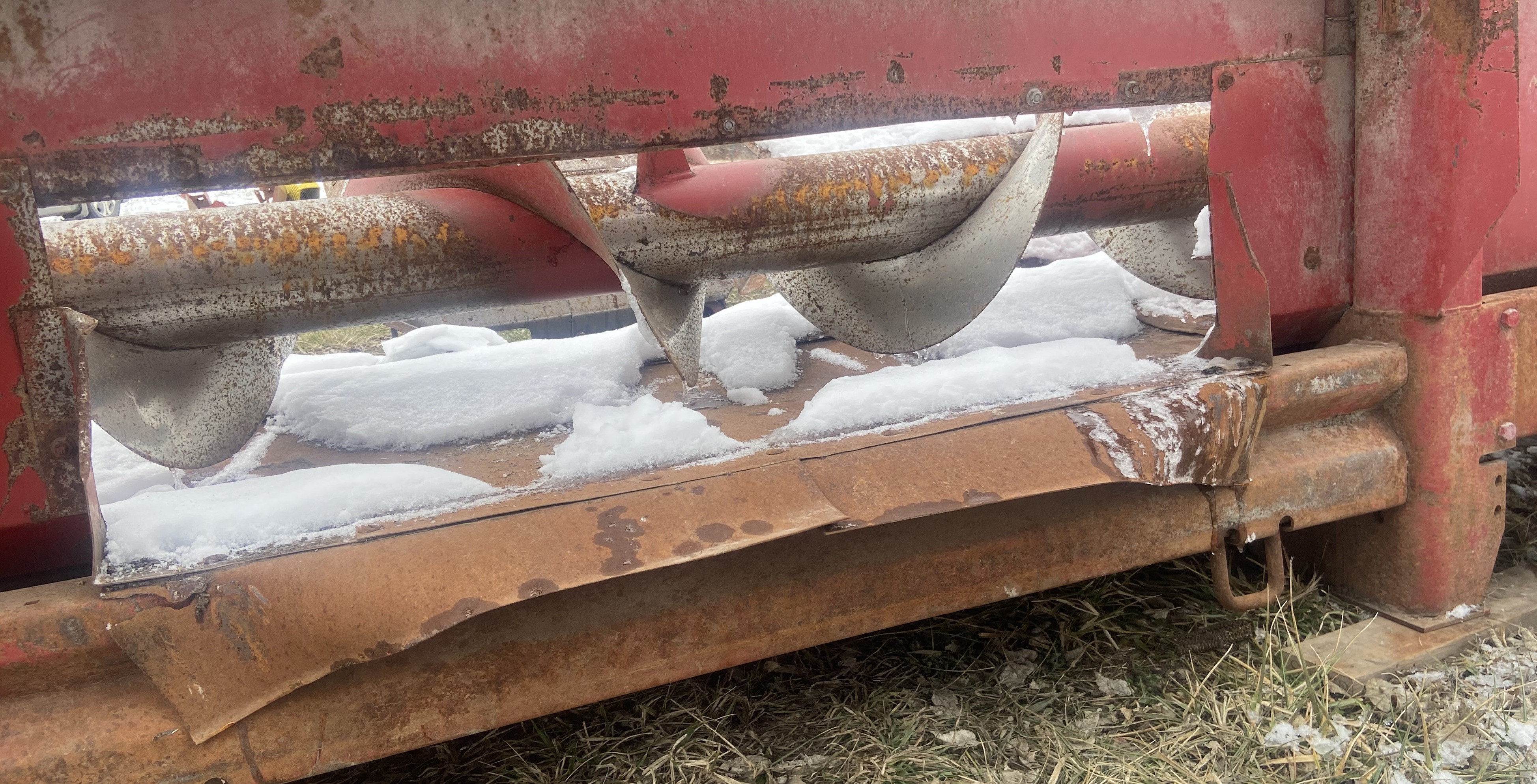

Thanks for all the answers, turned out I needed both. I got a flashlight, got under it and looked up, saw some metal, so I put the head down and backed the combine off, here's the picture. Turned out that the throat was set up for a 42 inch opening, had a 42 inch lip, must have been for a different model combine. My opening is only 36 inches. So I bent it back, got out my grinder and cut off the extra metal on the lip/bottom metal piece. Then I was able to put the head on and fasten it on correctly. But I still had to loosen and tighten the bolts, so thanks EFV for that advice. Thanks to Aaron and Bill for suggesting to take it off and look closely at the mating surfaces.
