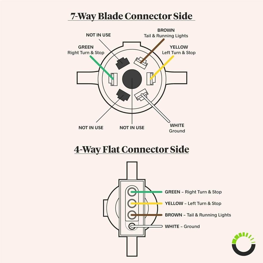

I'm not understanding here, as we suggested to get a battery and ground the trailer with a booster cable. then go to each input plug terminal off the pos. with a wire and touch each terminal and see if the lights work, as which they should. then you know the trailer is all good. we have no info if you have did that. sounds like you just replaced the harness for just because, ? with out knowing if its bad. and to add brown is tail lights, green right signal, yellow left signal, white is ground, so hooking if you can see the colors then you are double checking yourself it is correct. if the lights work accordingly ,there is nothing wrong with the trailer.

Did you install a purchased 4-wire harness or make your own harness? Did you wire it by a standard diagram (and colors) for a 4-wire harness with the common functions four wires support (Tail/marker lights, left and right signal lights and ground)?

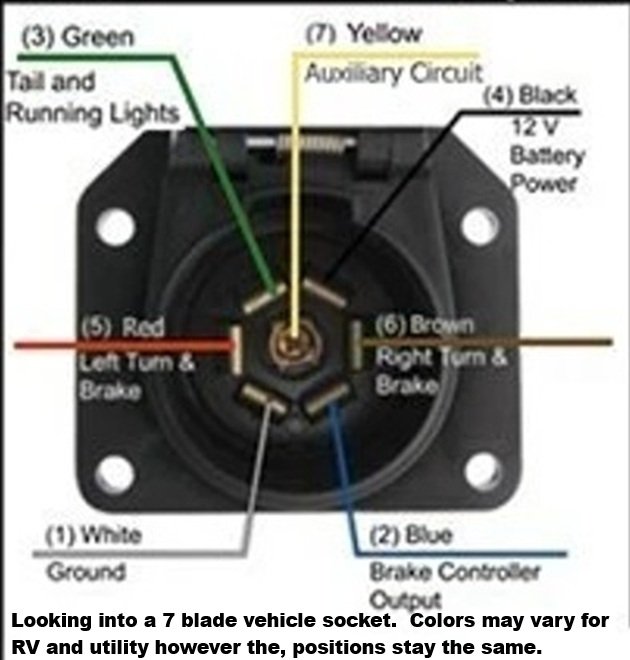

Take the adapter out of the truck socket. Check to see if the ground in the truck socket is good by turning on the truck parking lights and checking between the parking (tail) light blade and the ground blade with a test light or voltmeter. The picture below shows you which blade does what to aid you in testing the socket.
Then test with the adapter plugged in between the ground and taillight terminals of the adapter output.

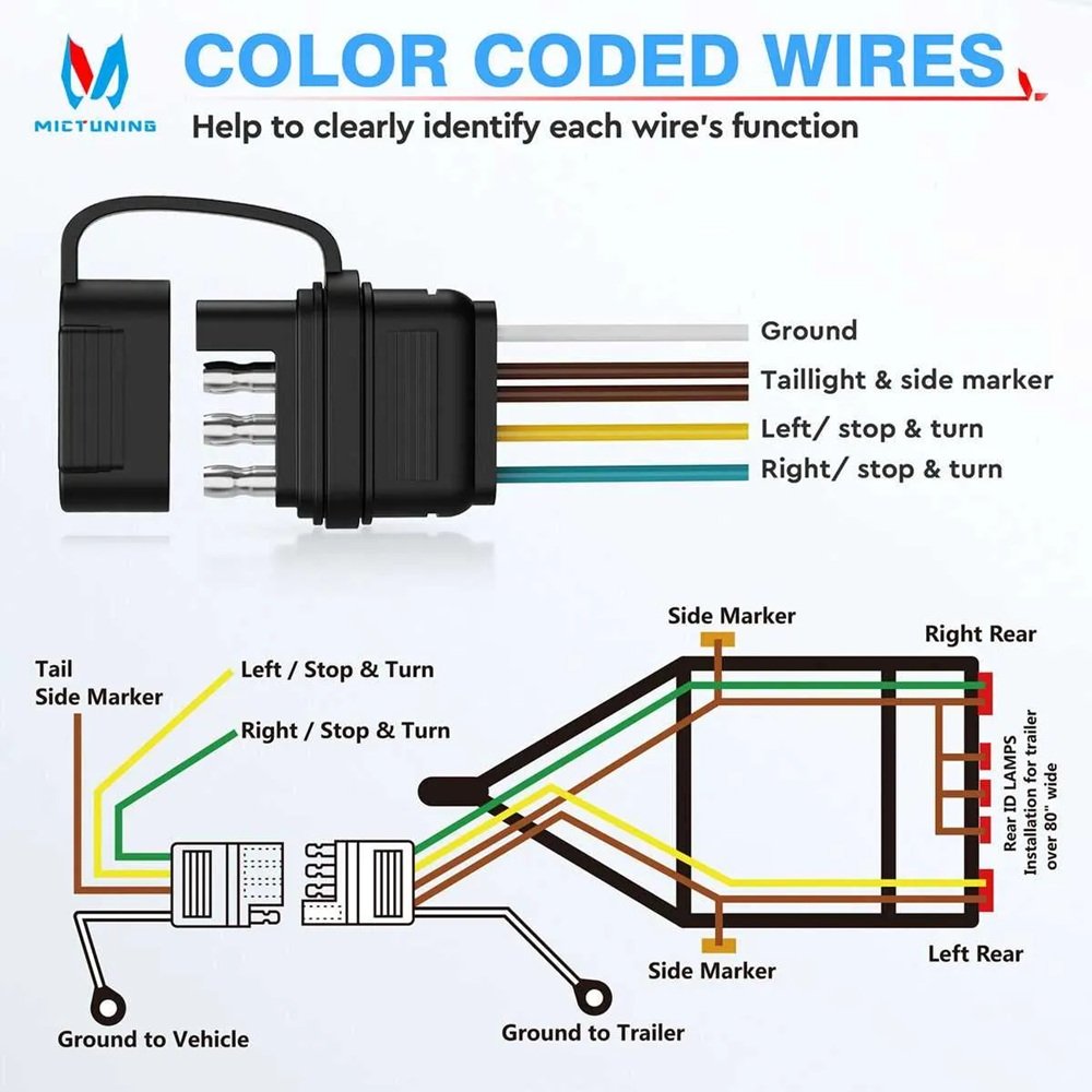

With the trailer unhooked from the vehicle, use a battery and jumper wires to test the trailer wiring. One of the drawings I posted the other day shows you which wire from the trailer plug goes to which light(s). Use the ground terminal of the trailer plug and the plug terminals for testing to check the entire circuit.

What did you install for a harness? One of the ones with the wires made to the flat 4-pole plug and the wires are long enough to reach the length of many small trailers. Or a flat 4-pole plug with short pigtail wires that you spliced other wires to for going to the taillights. Did you use and follow a trailer wiring diagram like the one I posted.

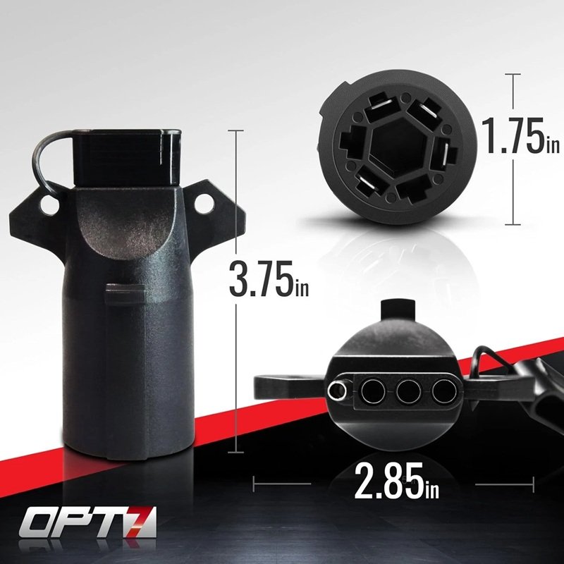

From what you have, I assume your tow vehicle has a seven-pin round trailer connector and the trailers use four-pin flat connectors. And between the two you have an adapter that has the little LEDs to tell you when there's power at the adapter. I also assume you have some sort of multimeter to check voltages.
