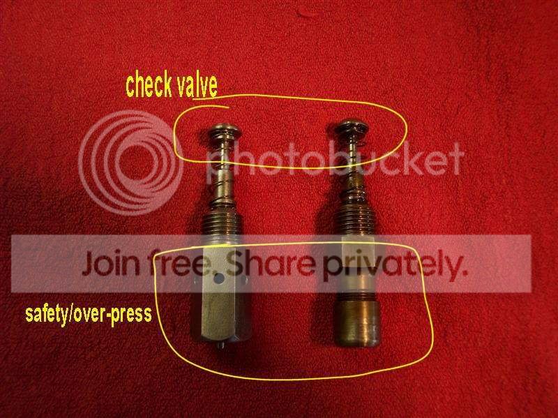

Correct me if I am wrong
The check valve is the valve that connects to the tail of relief valve...
WARNING :shock: all I know I read on the Internet,,, do it enuff and you can become a guru also,,, not responsible for damages,,, I read it and just pass it along,,, proceed with caution
(quoted from post at 08:58:27 02/16/10)
I guess it depends on which end we call the head and which end we call the tail, but you know how I love pictures, so:
