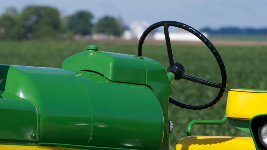

What is the filler cap (assuming that’s what it is) at top rear of LP tank? See pic. I’m obviously not a JD guy but would like to know. Thanks

It’s a knob on a threaded stud that holds the cover down. Unscrew, lift the cover up (it’s hinged at the end by the dash), and the tank fill valve, vent valve and safety popoff are accessible.

Thanks for info. Nice engineering by JD.
