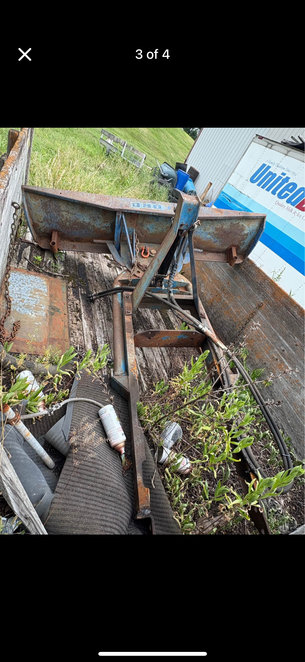

Stumbled on this front plow setup local to me and wondering if it might be for a 3000. I have a front blade setup for a 800/801 and I know this is different. Looking.
I asked the seller and they don’t know.
I found a pic on the forum from years ago and if definitely looks similar.
So, thoughts? Or if anyone had a front setup for a 3000 is there somewhere with a tag I can look for a model number?

Looks just like the one that I bought and put on my 2000, it had been on a 3000. There should be a tag riveted on the right side of the main frame on the R.H. side frame behind where the front push attaches. The numbers on my tag are Series 705 component 19-568.

It is definately for a 3 cylinder tractor. The blade is the dozer version and not the snow blade.
Snow blade has trip springs and is a bit taller.
