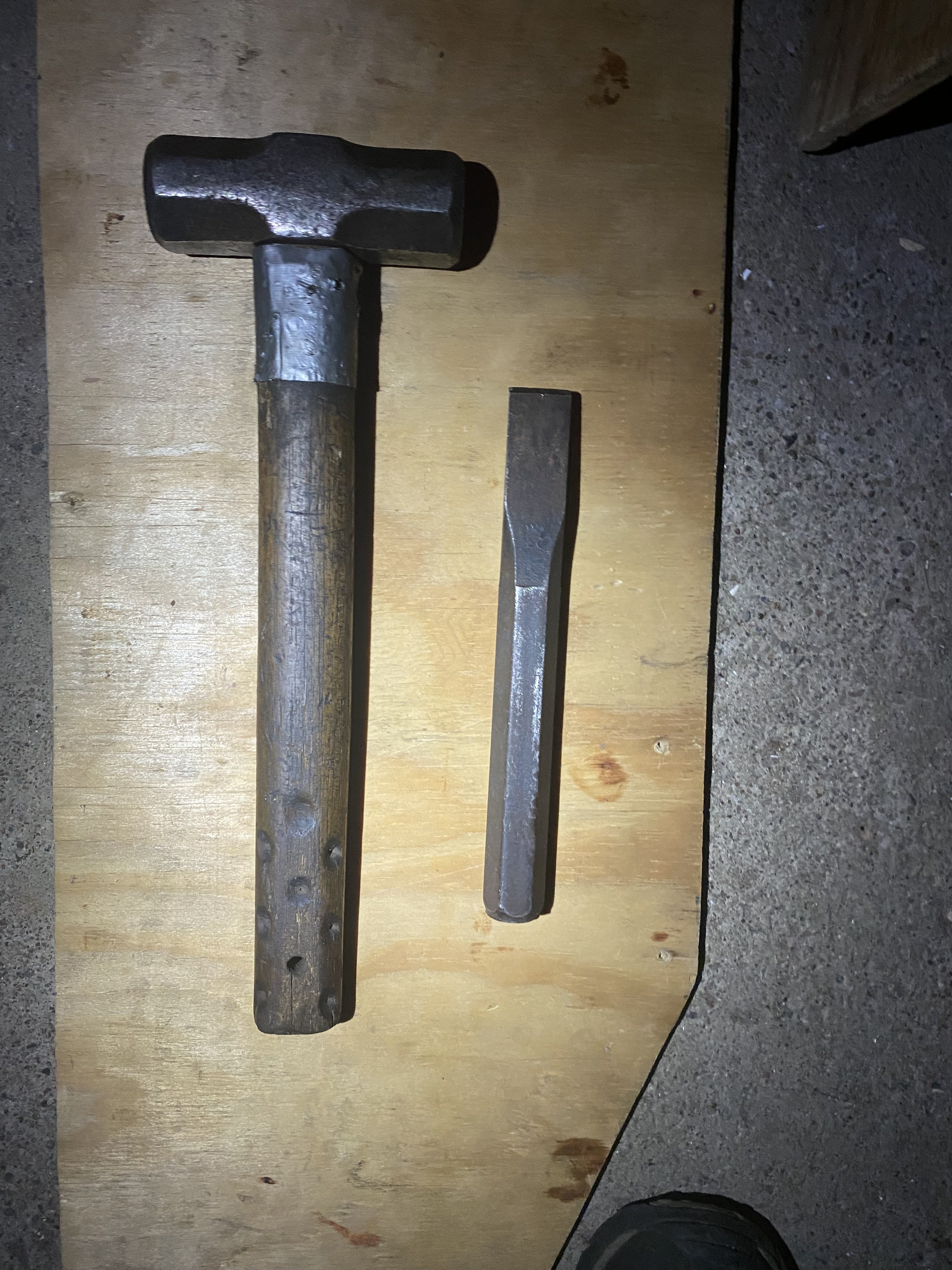

is it a serial number or a part number? Pictures?
Might as well say, here put on these handcuffs! :D In reference to the photo “I know nothing”! :oops: That hammer has given persuasion to many a pieces of stubborn iron.
