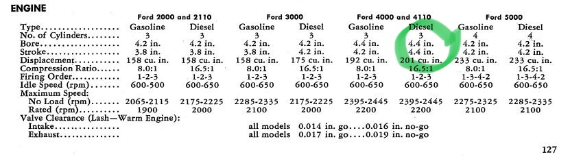

Thanks everyone, looks like it s a 4500 for sure! Now I ve got to ask Santa for a new crank shaft, get the block sleeved, and find under the tree a 201cid piston gasket set!
Thought I had it all figured out but one more wrinkle. The service manual does not agree with the stroke of the crankshaft in the backhoe. That is, assuming the 4000 engine is what the 4500 backhoe uses. Service manual says it’s a 4.4 inch stroke but the crankshaft seems to have a 4.2 inch stroke. Did the 4500 have a 3000 engine in it?
Finally got all the numbers off the bell housing behind the starter
Behind starter numbers
D5011K
2E15B
C3(or 5)41009
Engine
Casting C7NN 6015 AK
Stamped D380108
D5011K
2E15B
C3(or 5)41009
Engine
Stamped D380108
D5011K is a 4500 with a diesel engine, no PTO and a 6x4 manual reversing transmission.
The stamped number on the engine is the engine serial number, and the D at the beginning says that it was made for a 4000 series tractor, so it should be 4.4 inch bore x 4.4 inch stroke. I guess it is possible that it was rebuilt at some point and they used a different crank shaft with a 4.2 inch stroke, but that would be strange.
What is the bore?
