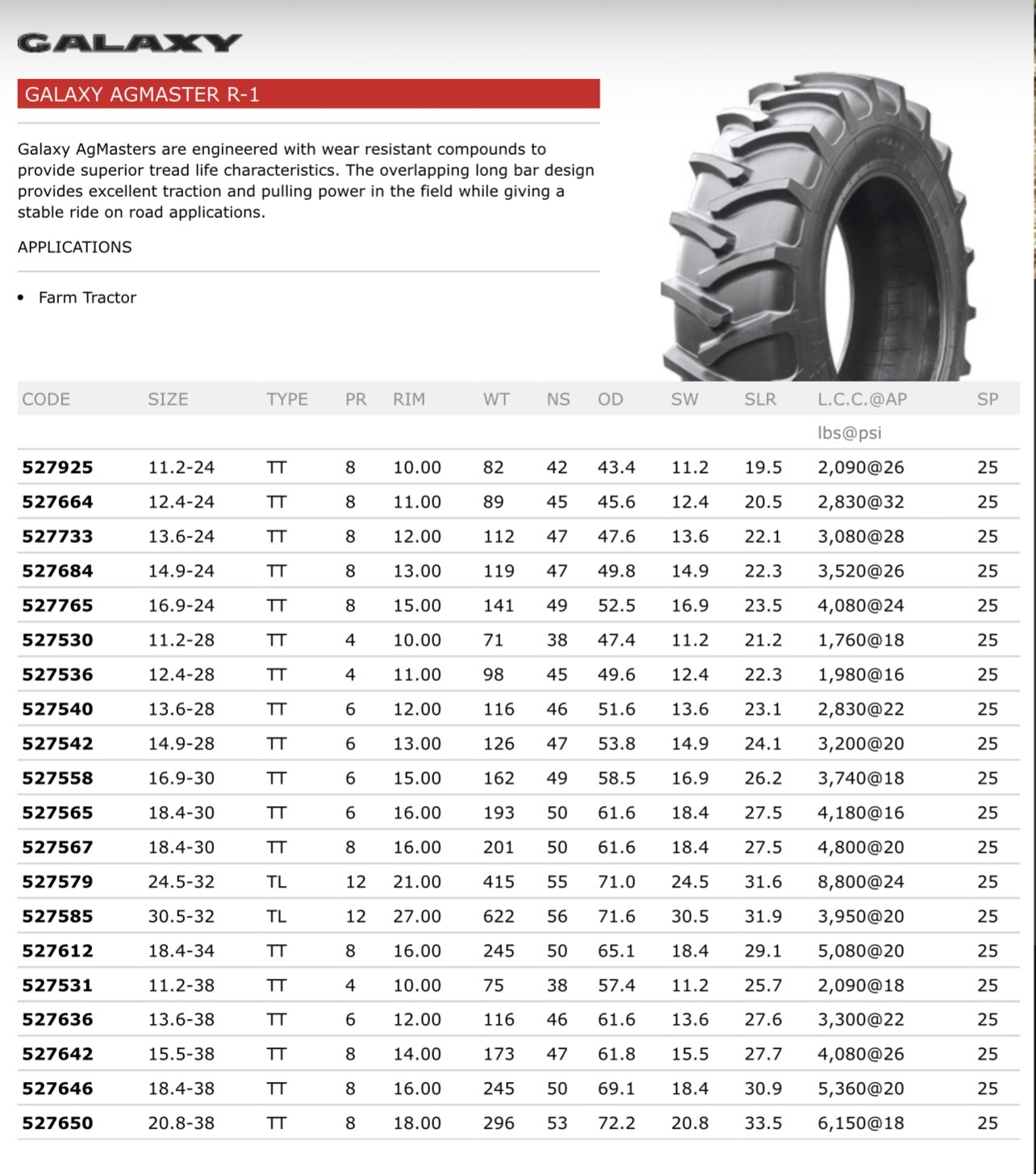

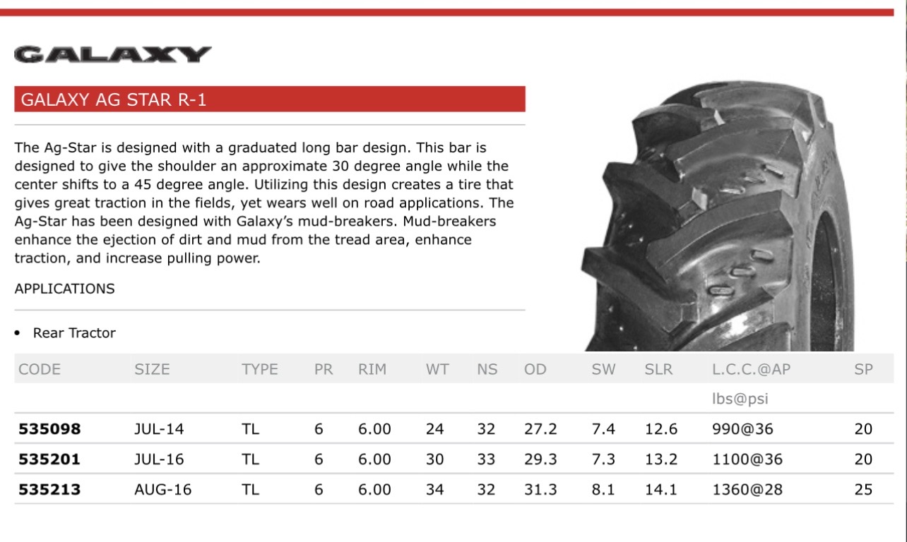

Could depend on which model of Galaxy tire is chosen . As to the bar spacing , compounding and weight .

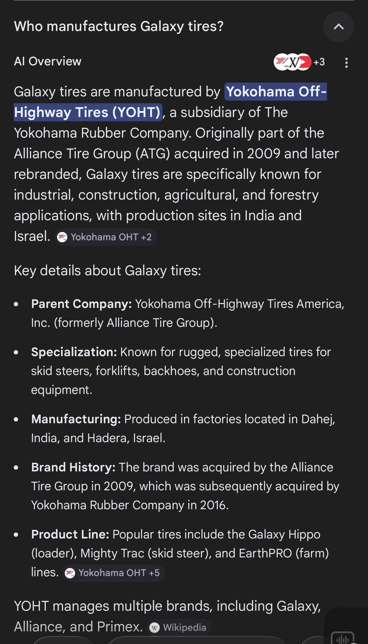

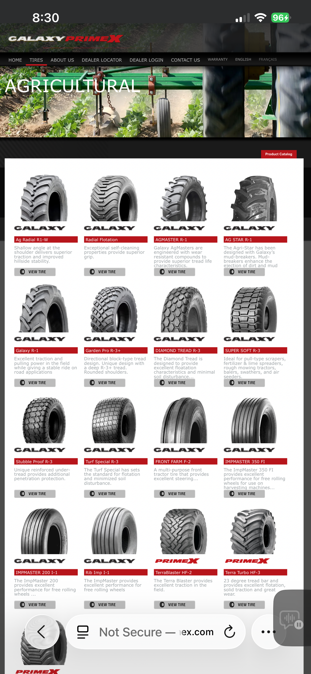

Ag Radial R1-W is an economy radial .
Agmaster R-1 is an economy 23 degree bar that has wide bar spacing .
Galaxy R-1 are 45 degree tires designed for vintage equipment . Some claim that these keep the rims from being damaged by running on the ground .
