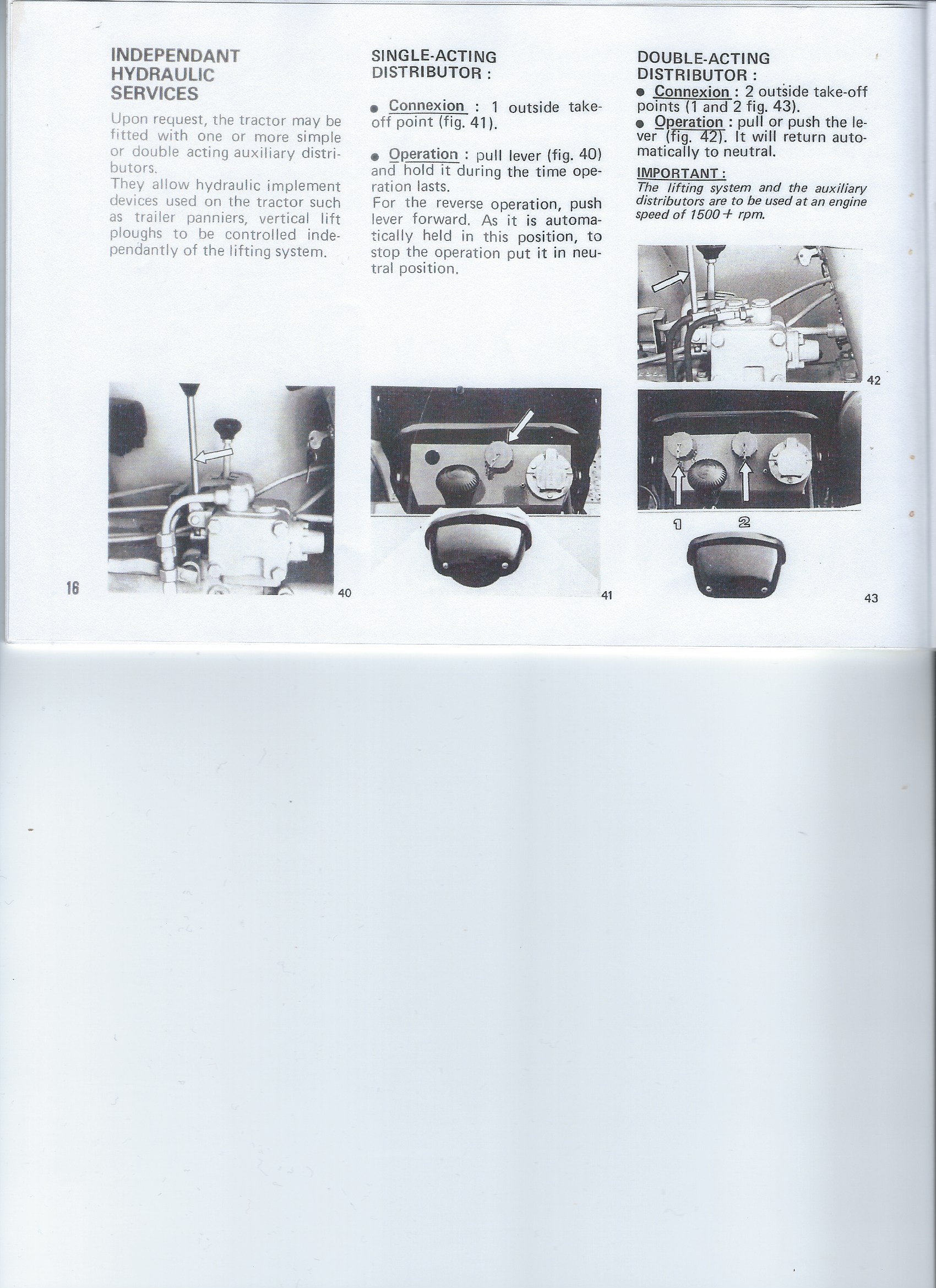

Old Renault 80s tractor has single output hydraulic which I wish to convert to two outputs
pictures include of distributor which has outlet for second line. Pictues show dismantled single outlet has complex fixings do I need something like these to attach second outlet
Thanks Andrew

It will require more than removing a plug and adding a fitting. The inner workings of the valve will be different. Specifically the part called the spool. When you compare a single acting valve to a double acting valve of the same brand and series (i.e. a Gresen 400-series), the valve body is the same but the spool is cut much differently for single-acting. The design of the spool is to allow free return of fluid when the lever is moved to the "lower" position without applying pressure anywhere else.
If the tractor doesn't "grunt" and make "hydraulic noises" when you push the lever to lower, then it has a single-acting spool in the hydraulic control, and it will be a lot of trouble to convert it, if that is even possible. This is an older tractor I assume (can't really find any information on a Renault 80s, all I come up with are Renault cars from the 1980s) so unless there are a lot of them in scrapyards, finding parts may be difficult.
My recommendation is, put everything back together the way you found it. Use that single acting valve as a pressure source, and add on an aftermarket double-acting valve. Connect the output of the factory valve to the "IN" port on your aftermarket valve, and run the "OUT" back to the hydraulic reservoir (through the fill hole, or level check plug, or even the drain plug).
The aftermarket valve you are looking for would have the features "Open Center" and "Dual Acting." From there you can have one, two, three, or even more spools/functions.

What are you going to use the 2nd remote for? You could buy a separate double function valve and run the hoses from your remote to it. You will have to lock the original lever into operation. This would work but you would have some additional clutter on your tractor. I was going to say your tractor might look a little “boogered” but I looked up the Brit meaning and that is probably not what you would call it. I am sure Majorman will get around to this eventually.
Running a benn or tipping bucket on back. Thanks for all the good advice. I'll probably add the second valve as recommended thanks 👍
Just so your aware and understand clearly, I mean a valve like this. Two spool double acting valve I suppose it is understood that if the one remote you have is hooked to the double valve it can’t be used for something else. You will have to determine if you want “detent” style that will hold the lever engaged until the cylinder ends it stroke or the simple spring centering type.
