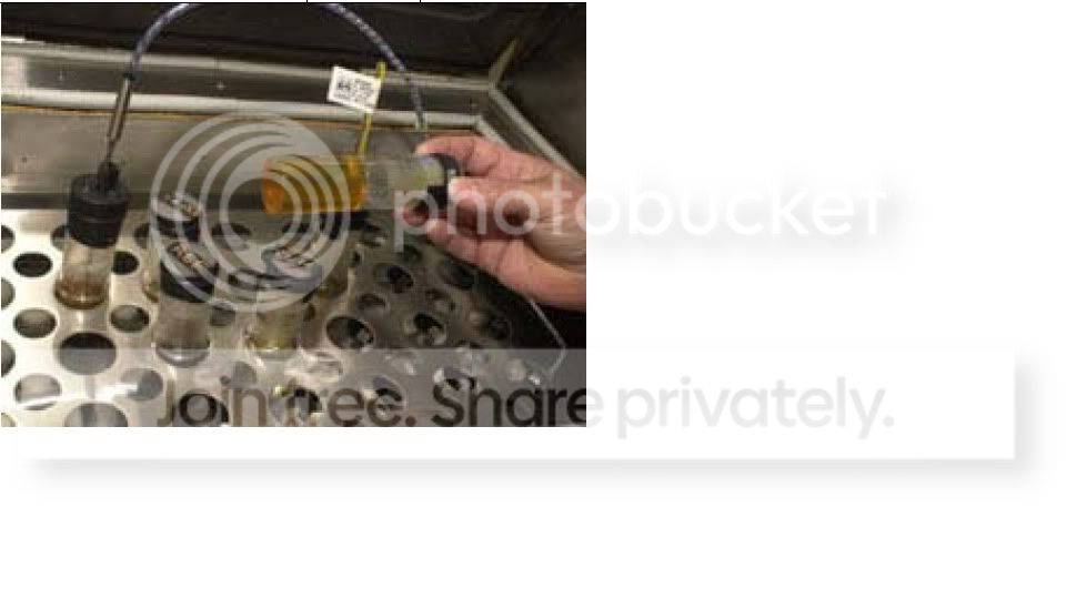

My statement is based on what I saw on the oil pressure gauge on cold startup after an oil change.Ill keep the 15/40 out of the crank case now.A freezer test of 3 oil samples will prove my idea.
(quoted from post at 06:03:52 12/14/11) My statement is based on what I saw on the oil pressure gauge on cold startup after an oil change.Ill keep the 15/40 out of the crank case now.A freezer test of 3 oil samples will prove my idea.
Places like SWRI are in the business of rigorously conducting ASTM D-97 pour point "freezer tests" and I gave you the published results. No need to try and duplicate that at home - their tests are very well controlled and quite accurate. All three of the different grade oils I listed have the same pour point.
Your basic idea vis-a-vis SAE 15W40 and SAE 30 has already been proven and I gave you the data to support it. But your analysis is focusing on the wrong property. Kinematic viscosities at 40C and 100C (e.g. viscosity index) is what you should be comparing - not pour points. Just FYI the Rotella SAE 10W40 and Valvoline SAE 30 viscosity curves cross at about -10C (14F). So at temps below 14F the SAE 15W40 is actually thinner than the SAE 30 while above 14F the oppositie is the case. Get it???
If you really want a grade 40 oil for winter use in your truck use something like Mobil 1 SAE 0W40. It has a viscosity index of 184 and will work just fine on the coldest winter day.
TOH
[size=18:488b39655e][b:488b39655e]PICTURE OF A TYPICAL "FREEZER TEST" AT SWRI[/b:488b39655e][/size:488b39655e]
