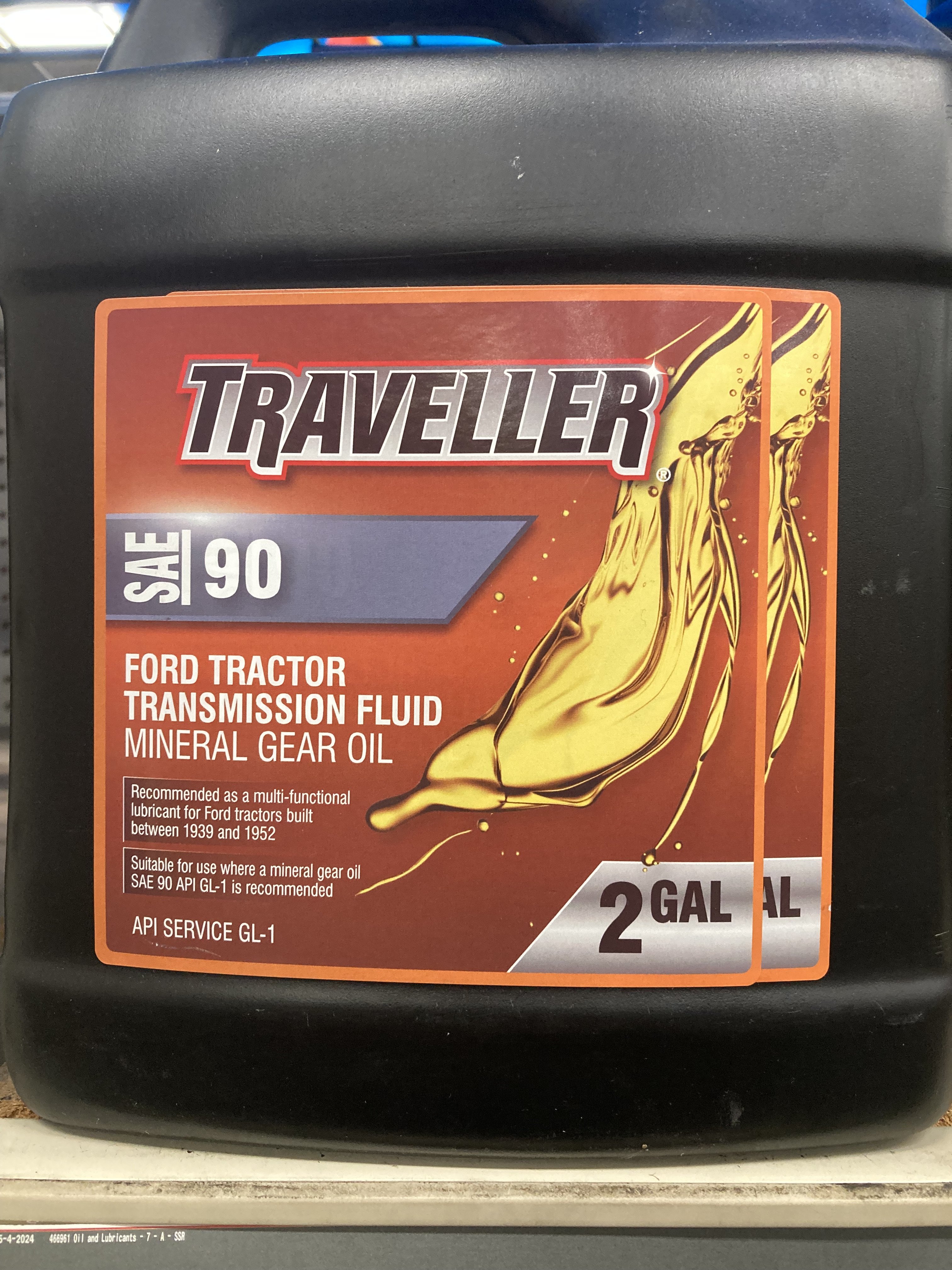

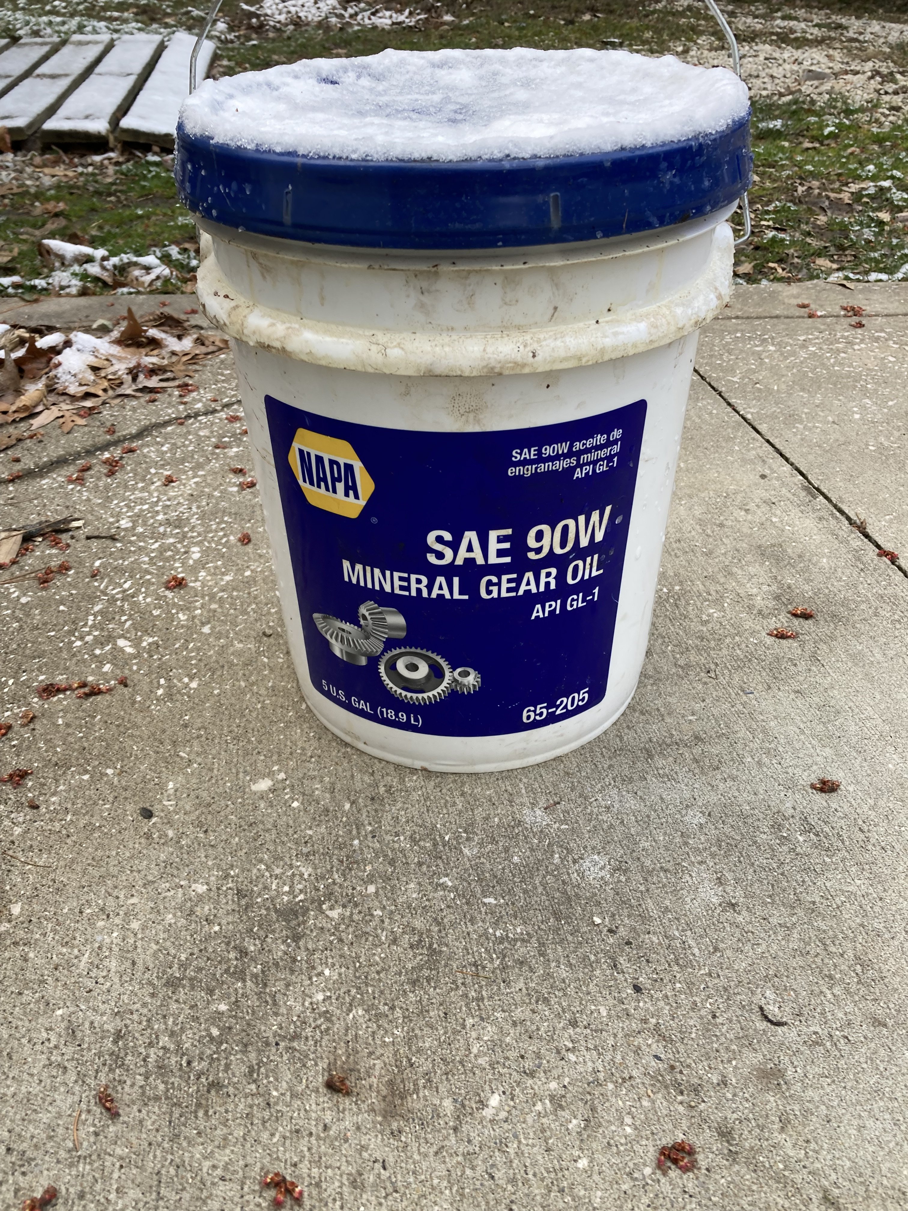

Hi, I'm getting an old Farmall Super A ready to work in the garden. It has sat for a few years, but I did get it fired up yesterday. Carb needs some attention, but it does start and run, and will pull itself around the yard. I will have a look at the carb, and change the engine oil & filter, grease it, etc. I will change the tranny and rear end oils and the hydraulic fluid. What should I be putting in the tranny? The rear end? Thanks.
Transmission and rear end are the same fluid cavity. It also lubes the belt pulley. Takes 1 gallons I think. You should also change the final drive fluid. You have to take the pans off the bottom of the final drives and dump the old oil out. Then clean up the inside of the pans and put them back on. Don't over tighten the bolts. Refill thru the plugs on the front side of the axles just above the pans. Each side should hold 1/2 gallon.
Dave
I recommend like the manual a sae 90 weight gl1 mineral oil that bronze compatible ,you got bronze bushing in the tranny .
