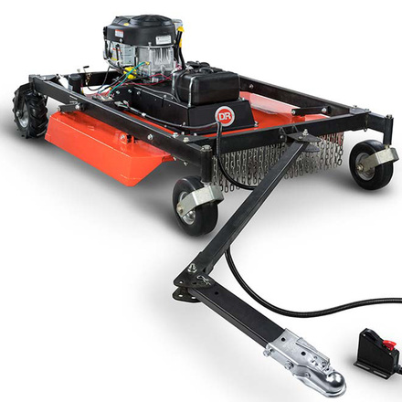

I have an Agri Fab tow behind finish mower that I use for field roads and along woods edge. Mine is made so if you get to close to tree on woods edge it deflects off the tree with out damage to anything. I pull mine offset behind a riding lawn tractor. so I have an effective working width of about 80 inches.
Once I got used to the offset I can't imagine not using it to mow all the lawn.

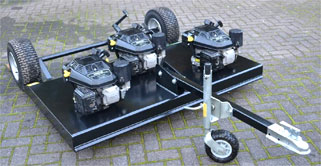

When I first moved to our property I hired one of these mowers which has 3 normal push mowers side by side. It sort of worked ok but had to drive very slow and as mentioned above when one mower stalled which was quite often in long grass you get an unmowed strip and you couldn't tell straight away. The mowers felt a little underpowered for the application and I found it too frustrating to use.

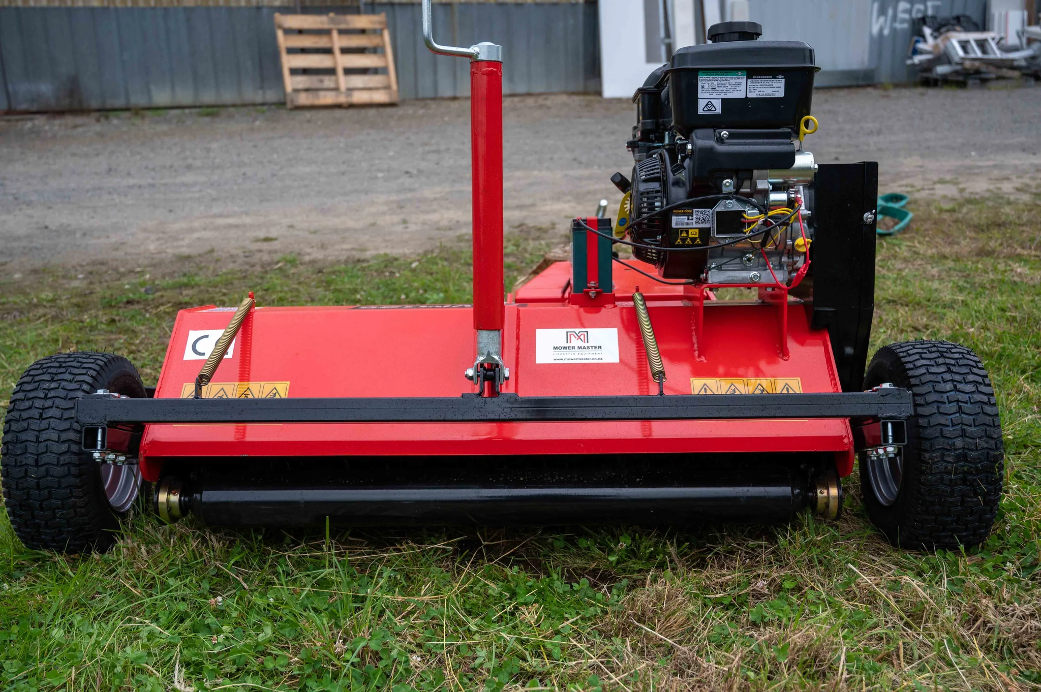

I ended up buying a Chinese flail mower (similar to the photo below) which could mow a wider strip with a single large engine. I can mow faster with it and if the going gets really tough you can hear the engine loading up so you can slow down a bit so it can catch up. As a mower concept it's really good. I've had to beef up the steel in a few places as it was under engineered but it works great.

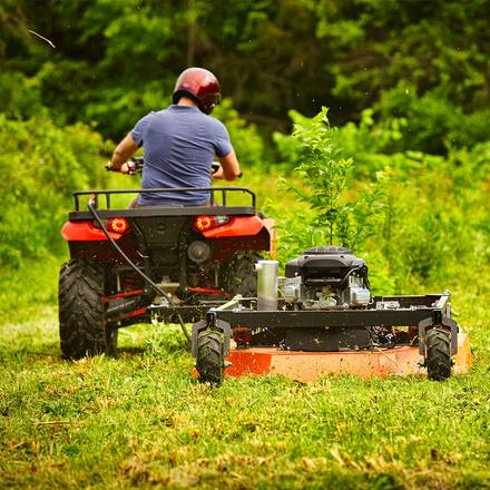

Brother uses one on the trails. It's a rough-cut version, two wheels. It's not bad.
What I found frustrating was pulling it with the ATV "four-wheeler". The thumb throttle was tiring because you couldn't go fast. The pull-behind mower would do a lot better with a geared machine.
I really like the deflector in front of tire for what I mow woods edge, under bushes etc. The added wheels help for scalping on uneven ground.
