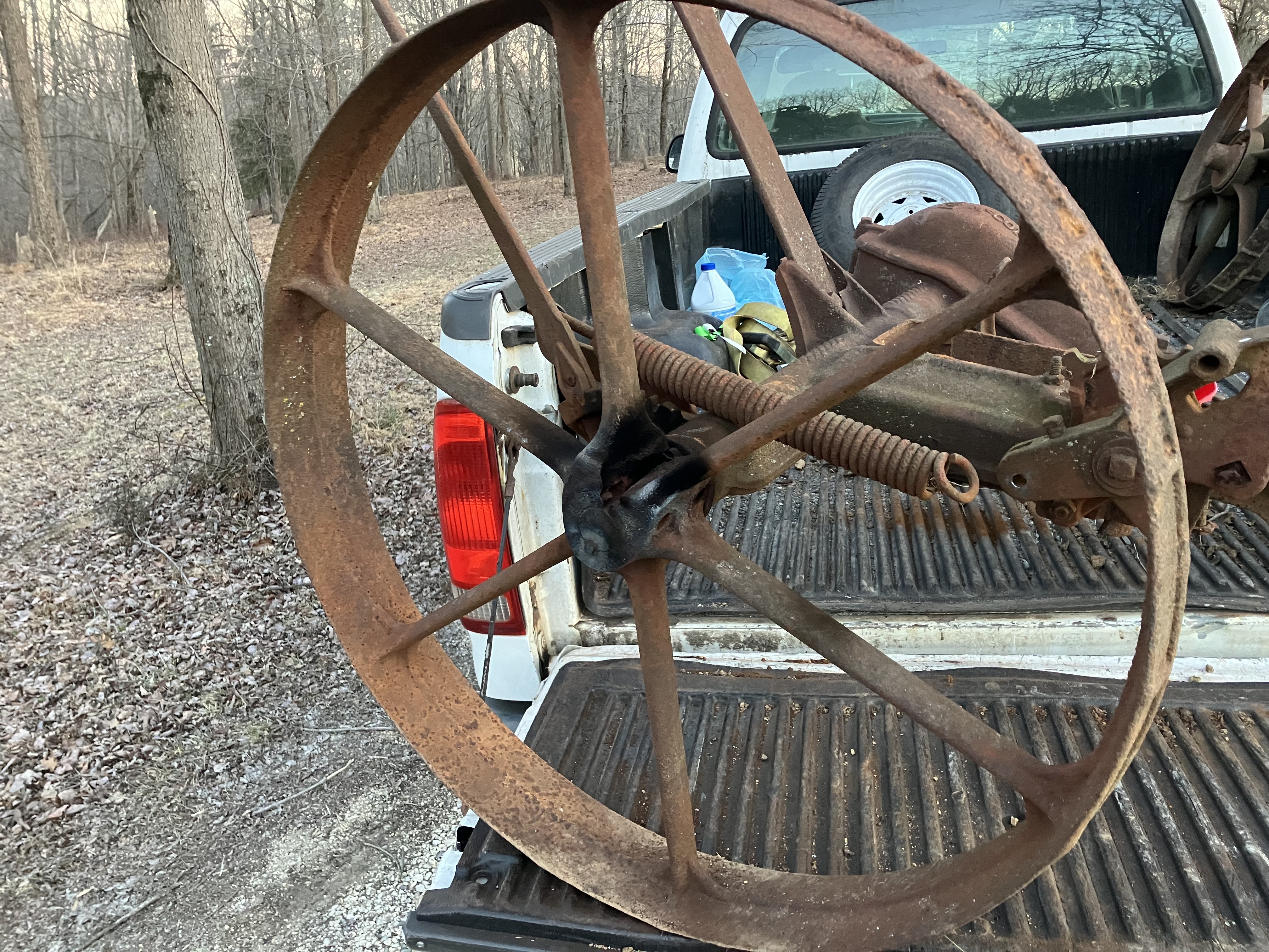

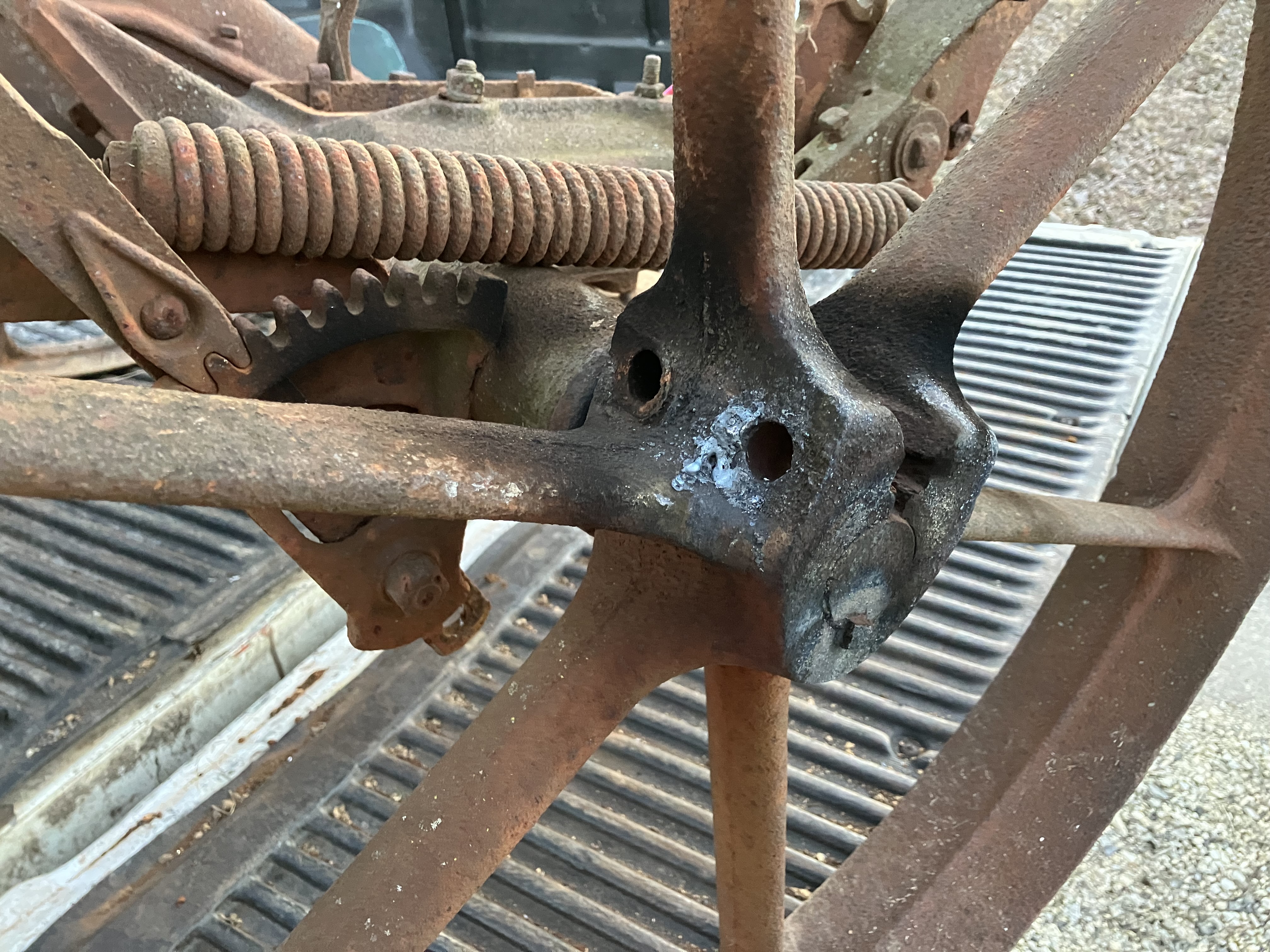

I have a junk #7 sickle mower that I’d like to save one wheel from. I have air and fire and an assortment of BFHs. My main concern is breaking it apart if I strike it too hard. The other wheel was already broken when I got the mower but it came with a spare so I have 2 to put around as yard art or just something to look at. Any chance it’ll come off or should I just cut off the axle? Thanks for any suggestions.

Cut the axle. Save yourself the time, effort and having to monkey around behind the wheel. Once you have the axle cut it'll be a lot easier to remove the axle stub if you still wish, and you can pound on the axle stub instead of the wheel.
I would cut a half inch plate so it would fit over the axle then with 3 holes for 1/2or 3/4 bolts and a second plate put a socket or a piece of shaft close to the size of the axle unde the front plate and tighten the bolts .IT will now come off or can be warmed up slightly and slow ly so it will come off. I would also probably squirt some diesel fuel or waste engine oil in the slot and clamp bolt holes then some heat it will soak in better and faster. No broken wheel and a good axle for parts if needed. As it comes off if needed longer bolts can be added or longer piece under the plate to reach the end of the shaft. No hammers needed. A lot easier top just pull it off. More time consuming but easier in the long run.

Lube the axle on it in that split.no sign of lube I can see. Tie the mower to something solid and then use a chain and tractor on the wheel and jerk it off. Try easy off the bat.

Gently drive a wedge between the bolt holes and squirt with diesel and leave for a few hours. Maybe tap again. Ellis
Wedge and heat, but heat opposite the wedge area. Lots of heat maybe, but I'd bet the wedge will work.
edit to add: rather than one piece wedge, fill most of the opening with a piece of plate or two , then use a slim wedge.
The key going to be what will hold the wheel on the shaft till you figure a way to get it to loosen up and slide with the wheel off the shaft . recommend heat up with a penetrating oil , might take a couple of days of heat and soak ing good , if you got two torches , you and a helper , the length of that hub will make very difficult to get it hot enough . Concentrate heat at key first ,keep torche moving or it will melt the wheel like at the bolt ole .

If you have air, do you have an air chisel or air hammer?
You might be able to vibrate it loose by hitting the end of axle with the above.
Well, it's the next day and I still stand by my comment. Cut it off and work from there. 5 minutes later and anything you decide to do will be so much easier.

You need to decide what's saved for parts and what's scrap. If saving I'd heat til red then try some sort of bearing splitter/puller arrangement. Be patient, getting in a hurry is probably what gets us all in the trouble the most.
I've had good luck with a pro level air hammer but they need an equally stout air compressor to keep up.
If the rest of the machine is scrap cut the axle.
Wait a minute... you don't care about the rest of the machine?
Can you cut the axle?
If you do, then, in my experience... whatever method you use... heat, lubrication, etc, ect... you will have a much, much easier time pounding the end of the axle out of the wheel than any method of "pulling" the wheel off of the axle...
I've had to remove the splined flywheels from new holland baler throwers three times now. The first two times, I tried heating and pulling them... both were fiascos that were hours long. The last time, I bit the bullet and pulled the whole shaft... which takes about 30 minutes of disassembly... but once that's done... I setup a couple of stumps and some heavy pieces of angle iron between them... dangled the shaft between the pieces of angle iron, hanging by the flywheel... put some penetrating oil on the splines where the flywheel mounts on the shaft... went and ate breakfast... came back and pounded the shaft a couple times with a 3lb engineer's hammer.... done... the shaft fell out... no heat... no gear pullers.
If you are worried about the brittleness of the wheel, you can put some planks on whatever steel you use to make the "horse" that holds the wheel... because you are pounding on the axle itself and concentrating your impulse there... it will still setup a lot of differential impulse between the axle and the wheel... even if the wheel has a little give to what's holding it.
This trick came from an old timer at the New Holland dealership. He told me that, any time you want to get something off of an axle or shaft... if you can hold it from behind... you're almost always better off pounding on the shaft itself, than trying to pull.
It's worked on a few things for me now.
(if you have a welder... you could weld something like a half inch nut to the face of the axle, to give you a nice little "button" that sticks out proud of the wheel to hit with a sledgehammer... the heat and cooling from the welding itself will probably help too...)
