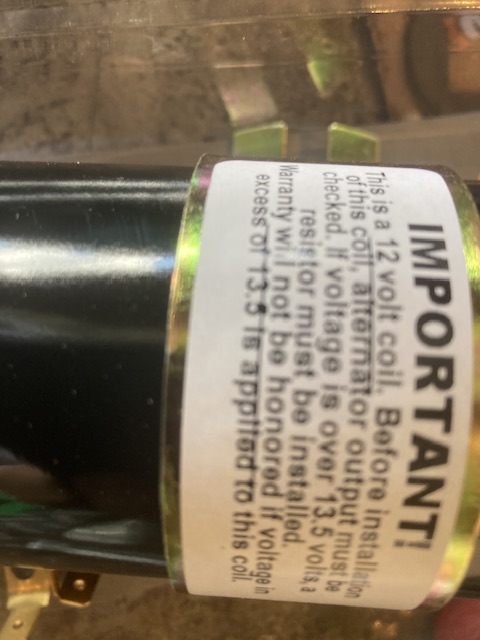

My Oliver 1550 has started missing and looses power going up a hill or under a load. The coil is not hot to the touch when running. A guy on a ride said his 1650 did that and he replaced the coil and that fixed it. I bought a coil at Napa and was going to put it on but the sticker says if the alternator puts out more than 13.8 volts the warranty is void unless I add a resistor. I checked it and it puts out 14.2 for a little bit after starting and then drops below 13.8 running. Can I use it as is or do I have to get a resistor to add to it?

Run it. There is no real issue. When it is down at 13.8, take a photo of the volt meter (with time stamp) to show the run charging is correct. Jim

I should have added that I’m not so concerned about the warranty , just wanted to make sure too many volts wouldn’t hurt the coil. Thanks
There should be a resistor wire to the coil in the harness. It's teed into a wire off the starter relay. When the relay is triggered it sends full voltage to the coil for starting. Resistor wire feeds the coil when running. That wire is gray on mine and 3 or 4 feet long, folded into the harness.

Most coils draw about 4 amps. To drop one volt, you need 0.25 ohms.
2 volts the resistor needs to be 0.50 ohms.
Use a 12v battery and measure the current.
Good luck finding a resistor small enough to drop one or two volts.
Good mornin Super 99, good questions here are my thoughts.
1) The tractors missing may or may NOT be due to the coil ?? More often its the points are burned, pitted corroded or mis gapped or there's a
plug, plug wire, condensor or distributor or cap n rotor problem, I usually check those FIRST before suspecting the coil IM NOT SAYING THE
COIL ISNT THE PROBLEM ...it may be ???????? Ive seen a bad condensor cause ignition problems after the tractor warms up or under a heavy
load. Typically the coil current is 4 or less amps to prevent premature burning of the points, so the resistance of the coil plus any ballast on a
12 volt system would be 12/4 or 3 ohms.
2) Do you have an alternator or a Generator ?? (sounds like alternator just asking) I ask because an original Generator may not be raising battery
voltage quite as high as an alternator, subject to voltage regulation and RPM etc.
3) The coil is powered by the Battery, not direct off a generator or alternator, and even if it has an alternator subject to RPM and the battery, AS
YOU POSTED the battery voltage may not stay at 14.2 very long before it settles in and stabilizes at 13+ NOTE again voltage regulation, RPM
and the condition of the battery determines the battery voltage.
4) DISCLAIMER I dont know the coil or its design or specs etc etc and dont want to offer bad advise that may void a warranty HOWEVER that
being said and noted ITS MY BEST PURE GUESS ABSENT ANY SPECS that coil will work fine. NOTE I wonder what that
coils LV Primary resistance is ?????????? If it's a lot under 3 Ohms Im more inclined to think IT DOES NEED SOME ? BALLAST
5) A typical old fashion ignition ballast resistor for use of a 6 volt coil on a 12 volt tractor is in the 1.5 to under 2 ohms range THAT WOULD
NOT be for use in your case. If your charging system and battery is keeping the battery over 13.8 volts and you wanted to use a voltage
dropping ballast to reduce it slightly THAT WOULD REQUIRE A MUCH LOWER RESISTANCE POWER RESISTOR the value of which requires
calculation. Typical LV Primary resistance of a 12 Volt Coil is around 3 Ohms WHAT IS THE RESISTANCE OF THAT COIL ????????????
SUMMARY AND SHORT ANSWER: CHECK THE COILS RESISTANCE if a lot under 3 Ohms (say 1.5 to 2+) my answer and best guess will
change
!!!! After that, I would FIRST make sure the problem isn't the points or condensor, plug or plug wire, cap or rotor
etc................I GUESS the coil would be fine but cant say for sure absent more information, its YOUR decision. Hopefully other fine gents
who have had experience with THAT COIL can offer their thoughts and opinions ?? Hope so its fun to learn from others !!!!!!!!!!! I look forward to
what others have to say
If Mike..Ohio is an Oliver guy and knows what he is talking about which I think he does, that is the wrong coil for your tractor you need a 6 volt coil that is approx. 1.5 ohms on primary circuit. I should say if your wiring is stock as Mike laid out. A 12 volt coil fed through a resistor wire feed will make your spark weak.
I am in the camp if the tractor is running good except on hills it is not the coil. Also there is a coil tester I have a snap on one. It removes all doubt and can even heat the coil for hot testing.. Best investment I ever made on coils.
This is good advice. I have seen numerous occasions on this site where improper modification of the Delco bypass system has turned a good starting tractor into a problem child. Hard starting or burning points.

super99 said at the beginning, "I checked it and it puts out 14.2 for a little bit after starting and then drops below 13.8" So why advise him that he needs a 6 volt coil? Do people read the questions or just simply blindly respond?
Exactly. If it’s a 6 volt coil on a 12 volt tractor that uses a ballast resistor that 12 volt coil he pictured will yield a low energy spark snd for sure with that ballast there won’t be any chance of excess coil voltage lol I question if the coil is even the problem but he needs a 6 volt coil if original or use that new 12 volt if he ditches the ballast.

The only reason he needs a 6 volt coil is if it’s one of those 12 volt tractors that uses a 6 volt coil plus an external ballast and ballast by pass when cranking feature. If it’s a straight 12 volt tractor coil then he obviously needs a 12 volt coil only iffff the coil is the problem which I doubt. We need to know if it’s a 12 volt coil orrrr a 6 volt with ballast. I tried to cover both in my answer above with the last PS.

It has a 12 volt coil with built in resistor on it now, that way when I got it. Wiring harness was new put on by previous owner. New plugs, wires and cap 200 hours ago. I looked at points and they look new, wondering about the condenser, I have a new one I could put in the next time it rains. Inside of the cap looks good. If had been running great, idle to full throttle with no hesitation and then started sputtering when under a load from 1700 to 2000 rpm and then smooth out to wide open, steadily got worse to sputtering anytime I push throttle all the way open or under a load. Last resort, I have another 1550 that I could switch distributors to see if it changes.

If the distributor cam shaft bushing is worn, it will act like that. If you can move that shaft Up Bown Toward engine or away it is in need of a rebuild. Jim
Is this one of them Olivers with a vacuum advance? I know in the automotive world the pivots in the points mounting plates could get worn and then the points gap would not be kept the stable through the advance stroke. Ford Autolite distributors were bad for that.
