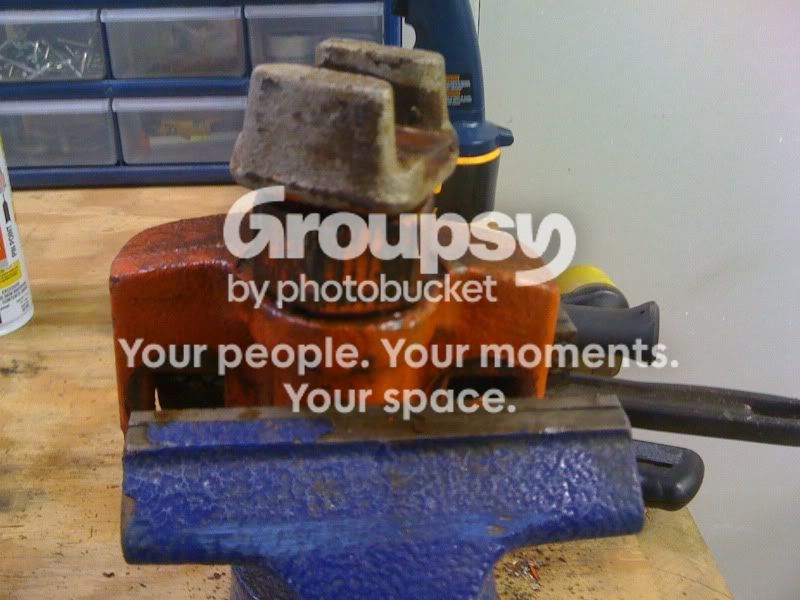

I'm rethinking replacing the power adjust rims. I got the bad one off however I can't get the clevis out of the bracket that bolts to the disc. I thought the clevis should just fall out but it won't budge. Tried heat, hammers, pipe wrench PB Blaster and nothing. Those brackets aren't threaded, are they?
Eric, online parts diagrams seem to indicate the the clevis as you call it, "jack screw" as Case refers to it is only threaded to be adjusted outward by the nut. Below that is simply an unthreaded part of the shaft extending into the casting which should slide freely (when new). May not want to wail on it with a BFH for fear of busting the casting, vast amounts of PB Blaster and careful application of heat over period of days should get these loose. Don't try to rush this, you will only break hard to find parts doing that.
