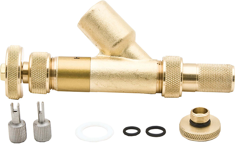

It that tire is tubed, a new valve stem can be installed, they screw-in, which is how they can be filled with liquid ballast.
This is the ballast gun my local tractor tire service truck uses: https://www.haltec.com/pc/Valve-Adapter-Gun-p808.htm
