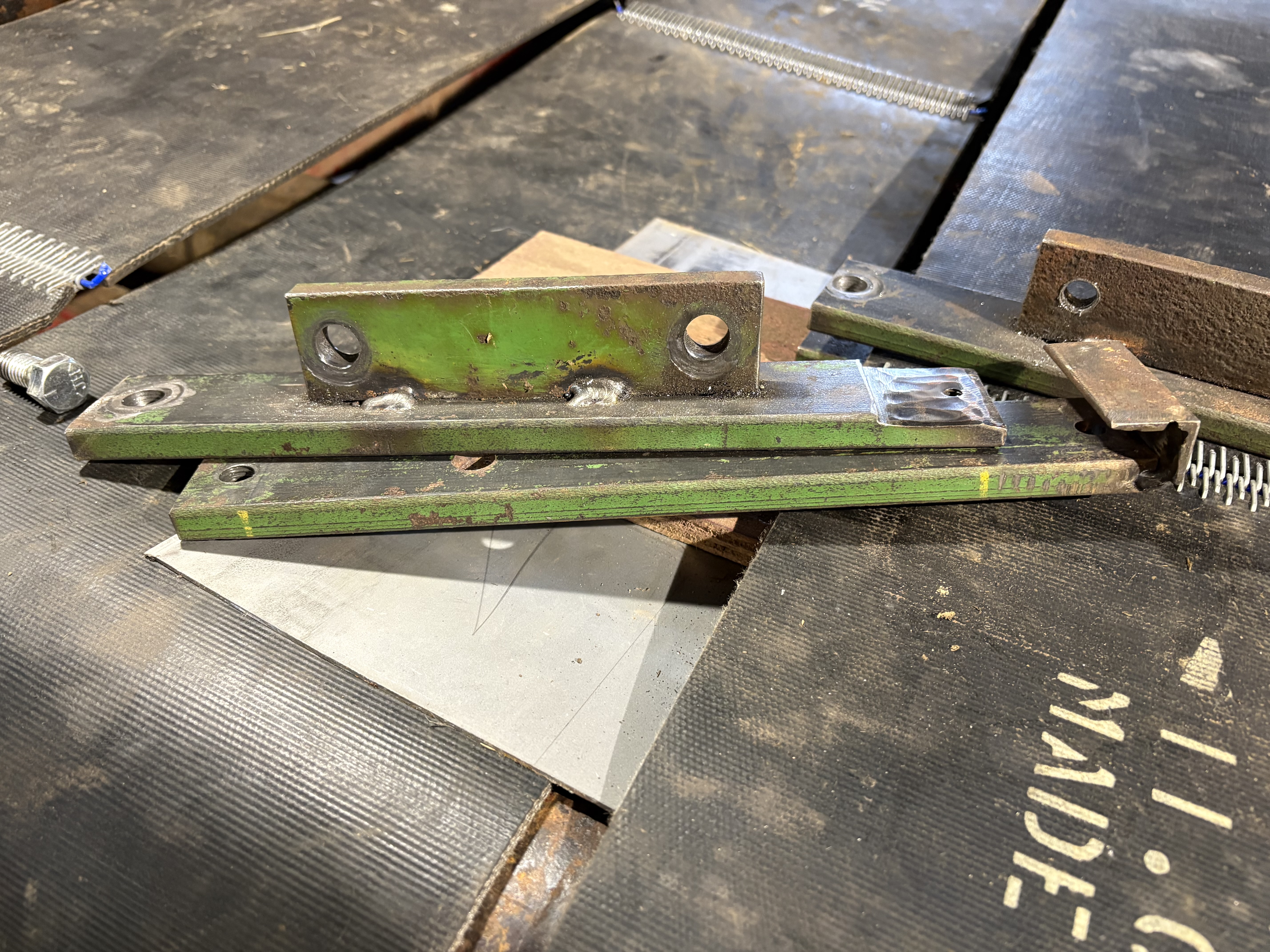

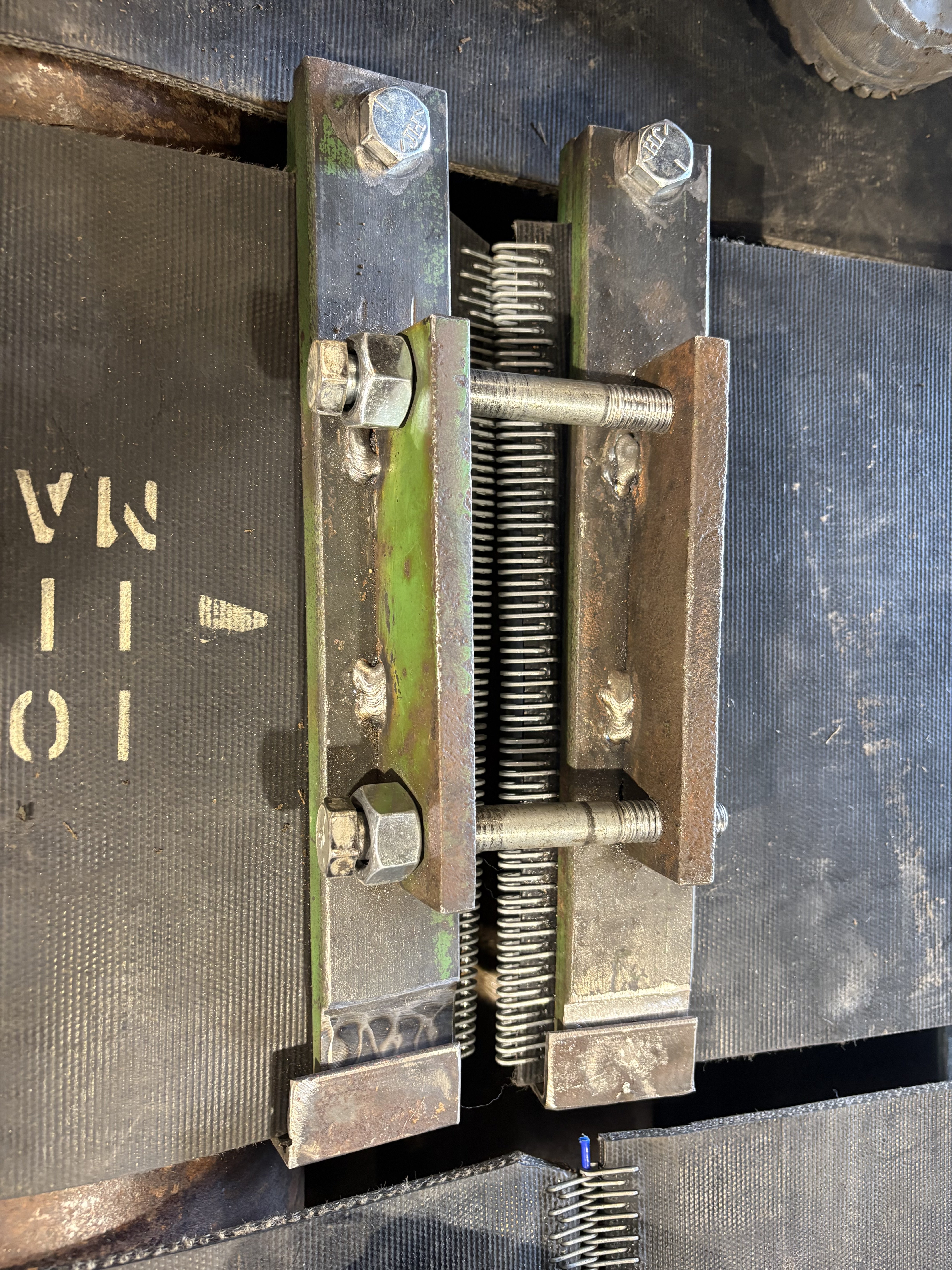

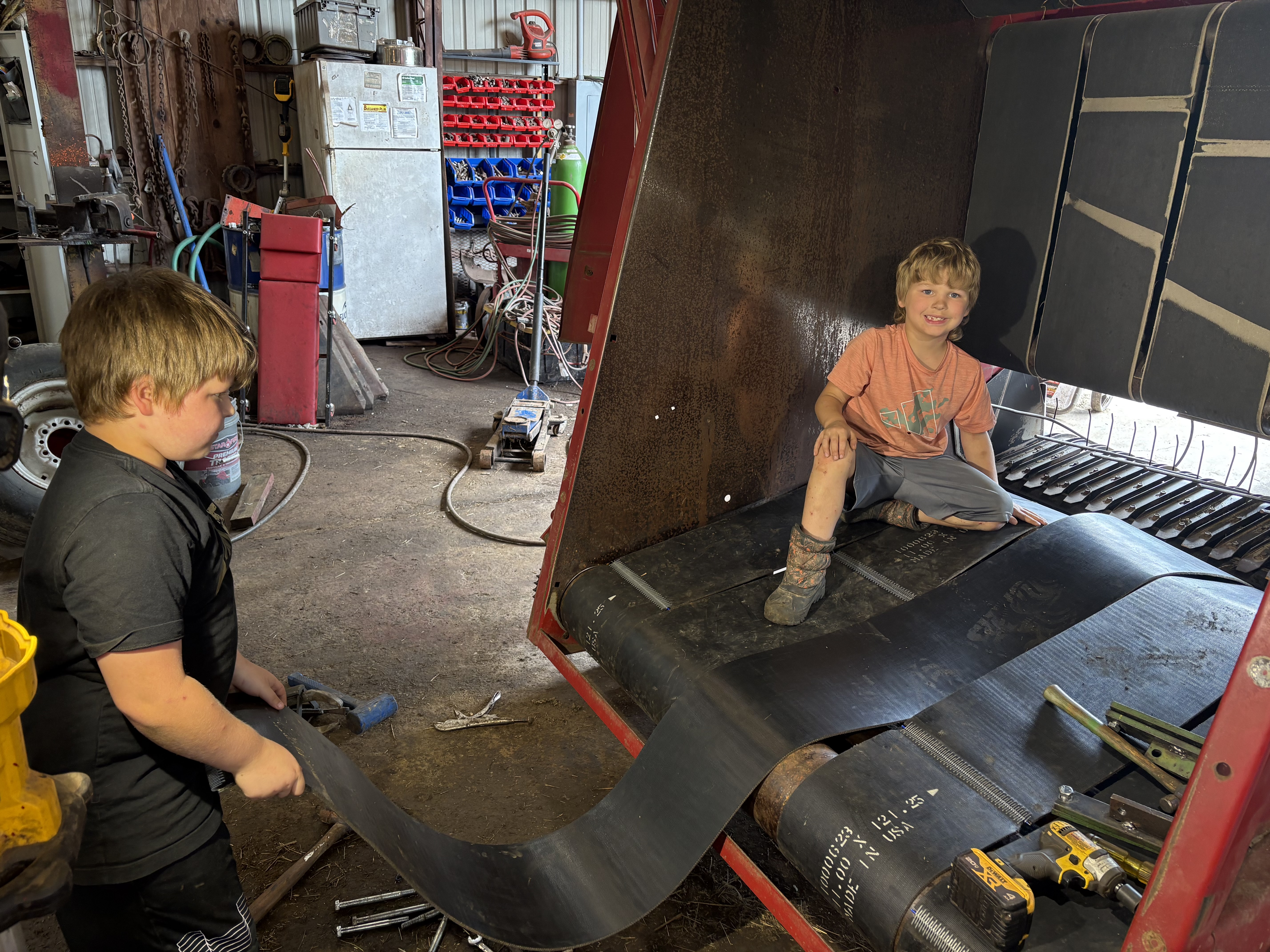

Made a tool to help pull belt together so you could lase it up. I could get with in 2 inches by myself but was over it. So made this to put on each end and pull together with bolts. The one in the pic is my second try as I had to modify. Had grandkids helping and for the most part it was entertaining at the least. Going to make a few other modification but made life easier as I most like replace another set soon.
