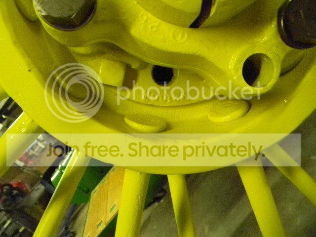

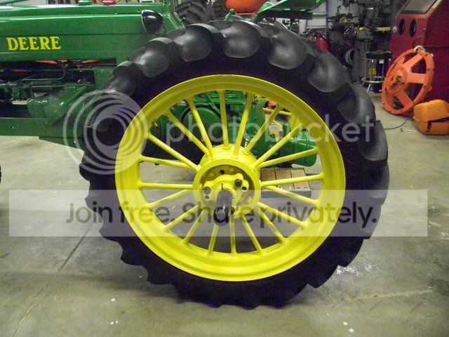

Take a look at one round spoke rear wheel and 12 spline hub.
a209260.jpg" width="650"

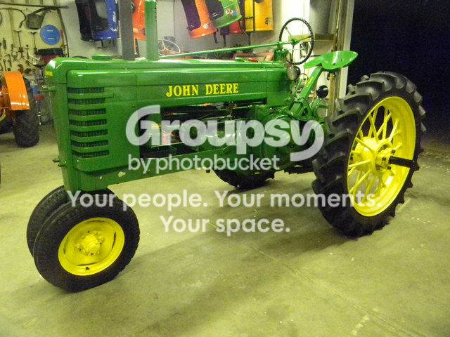

Take a look at the photo of "Uncle Earl" our 39B with rear round spoke and front round spoke wheels.
a209266.jpg" width="650"

Just to add a little more info to what James said:
French and Hecht produced most of the round spoke wheels that were available on John Deere tractors. In the late 30's Deere and other manufacturers started to move away from the round spoke wheels, in favor of cast center wheels with demountable rims and pressed steel wheels. French and Hecht however continued to produce their round spoke wheels well into the 40's and some wheels were even available into the 50's. Tire companies were still selling F&amp;H wheels and I suspect that many Deere dealers were probably still able to provide them as well. F&amp;H made MANY wheels that you will never find in a Deere parts book.
If you could post pics of your wheels that would be great. The wheels that James has on his tractor look to be the demountable hub type that usually have the casting number 100625 on the hub. These, in my opinion are very nice wheels that started to become available in the mid 40's and could be adapted to A's, B's, and G's with the correct hub. They are designed much heavier than some of the early wheels. The other wheel that you could possibly have with 12 spline axles would have a casting number of HC470 with a letter after (usually "D"). These have the 12 spline hub integral to the wheel center. The only spoke fronts that I'm aware of for the B's would have the casting number HC-176 with a 15' rim. Hope this helps. Post pics if you can.
