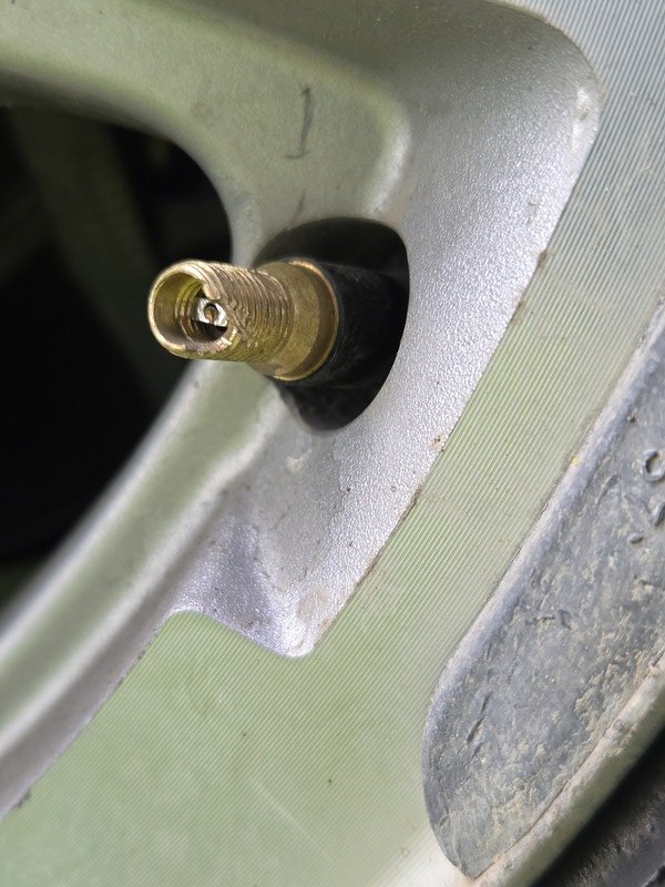

Two weeks ago I loaded up my 2017 Silverado 2500HD Duramax with tools and headed out to Colobraska to help my sister with an eviction. She was renting her property and commercial building to a body repairman/shade-tree mechanic, but he wasn't paying rent, refused to get insurance and had turned the property into a junkyard. Not to mention he had sub-let part of the building to another shade-tree without her permission. I won't go into details about the eviction, but at least her tenant/squatters are gone along with most of their junk.
So Saturday morning I packed up and started to head home. Immediately I saw the dreaded warning message on my dashboard saying the truck's speed would be limited to 65 mph in 100 miles. Oh, darn. 1200 miles from home in a truck about to go into limp mode and it's Saturday to boot. I knew the local mechanics (including the guys we'd just evicted) only knew how to delete diesel emissions systems, not how to fix them. So I searched for all the Chevy dealers within a hundred miles and found a big dealership 90 miles away. They were open Saturday morning and best of all, that town has a car rental agency. So I drove to the dealer, dropped off the truck, rented a car and headed back to help Sis some more.
Monday the dealer's service manager called and said the truck had a wiring issue and needed an EGT sensor. The sensor would come in the next day. Tuesday they had the truck running. They ended up not replacing the EGT sensor, but found a broken wire and fixed it. (The broken wire was between the particulate matter sensor and fuel pump control module.) Six hundred bucks later I was on my way! I did notice as I pulled out that the backup camera flashed blue, but I didn't think much about it; I was in a hurry to get some miles between me and Colobraska. I later realized that the camera was completely out of commission. I figured the tech had left something unplugged and I'd figure it out when I got home.
Once home I climbed under the truck and started looking. The wiring harness to the tailgate was cleanly cut in two! You can't buy just the harness; it's part of the camera. The conductors are really small so I didn't think splicing would be practical. I found a new OEM camera on Amazon for 125 bucks and ordered it. All the time I'm trying to figure out why the dealer tech would have cut that harness.
THEN yesterday I discovered another anomaly: The left rear tire's valve stem was damaged, even though there was no damage to the tire or wheel. It looked like, uh, well just like someone had taken a pair of dykes to it. Maybe the same dykes they used to cut the wiring harness. Maybe even the same pliers they used to cut a wire going to the particulate matter sensor. I showed my picture to a bunch of automotive engineer friends and they all agreed the damage looked deliberate.
So... my current theory is that one of my sister's evicted tenants identified my truck in the hotel parking lot (Michigan license plate is a dead giveaway) and took a pair of dykes to it sometime Friday night. And there may still be other damage I haven't found just yet. Does anybody have a different theory?
You were in town for the evicted party or their friends to find your truck so very possible as to vandalism. Usually, vandals are not so subtle in their damage and would normally opt to slash tires and break glass but perhaps they have improved their "game." When I was school age during the 1970's there were dirtbag young people who picked up their ways from older relatives or neighbors. Today it seems far worse as television and online have many examples of poor behavior to emulate. Far fewer examples of ethical or moral behavior in the home, school, or workplace for the young to learn. No one era was perfect in terms of demonstrating morality but I would say 50 years ago society was doing a far better job and it takes little guesswork as to why.
Not trying to give your accused party any slack but here may be some other explanations. Do you remember possibly encounter some debris on the road or hear an unexplained thump or bump during travel?

No I didn't. Which one would expect. And although it wouldn't be unusual to hit debris on a 1200 mile trip, I'm pretty sure I didn't.

I agree with the comment that said why damage a valve stem when they could have slashed the tire sidewall. One possibility there is that with a flat slashed tire in the hotel parking lot you probably would for certain be looking for the culprit and the hotel probably has security cameras.
As I said earlier, a slashed tire would have resulted in law enforcement getting involved. And they would have known that.
On the other hand whether true or not in your case often alleged mischievous deeds like this are often carried out by perpetrators who are under the influence of something. In that state whether or not they would consider the fact that the motel might have security cameras that would catch them in the act is questionable. To me the valve stem appears to have suffered from accidental contact with something.
All valid points. Which is why I'm not 100 percent certain this was all due to sabotage.

The valve stem could be from road debris
