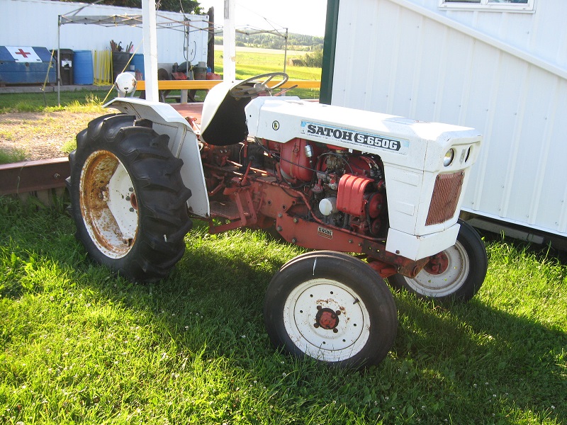

Our club has one .... great little tractors, back in the day I suspect they were as good as any on the market. The engine is a Mazda pickup truck engine .... and Australian model, 1000 cc (65 cubic inches hence the model number). Picture below ... our belt driven governor is suspect, one of these days we'll get into that, we just use it for towing duties for the most part.
