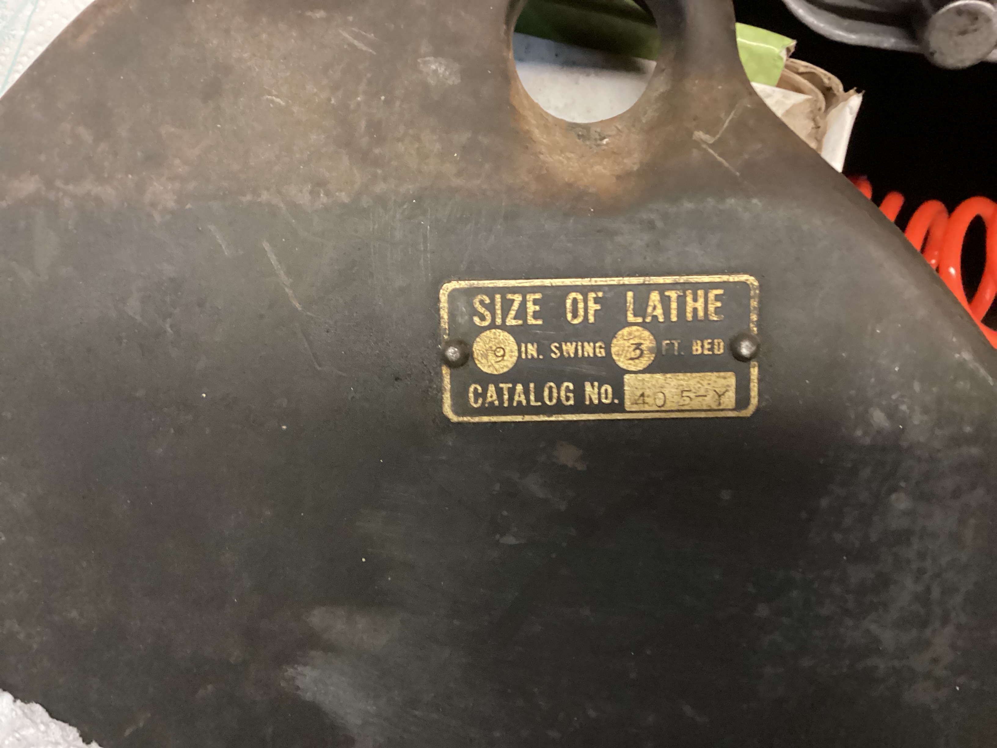

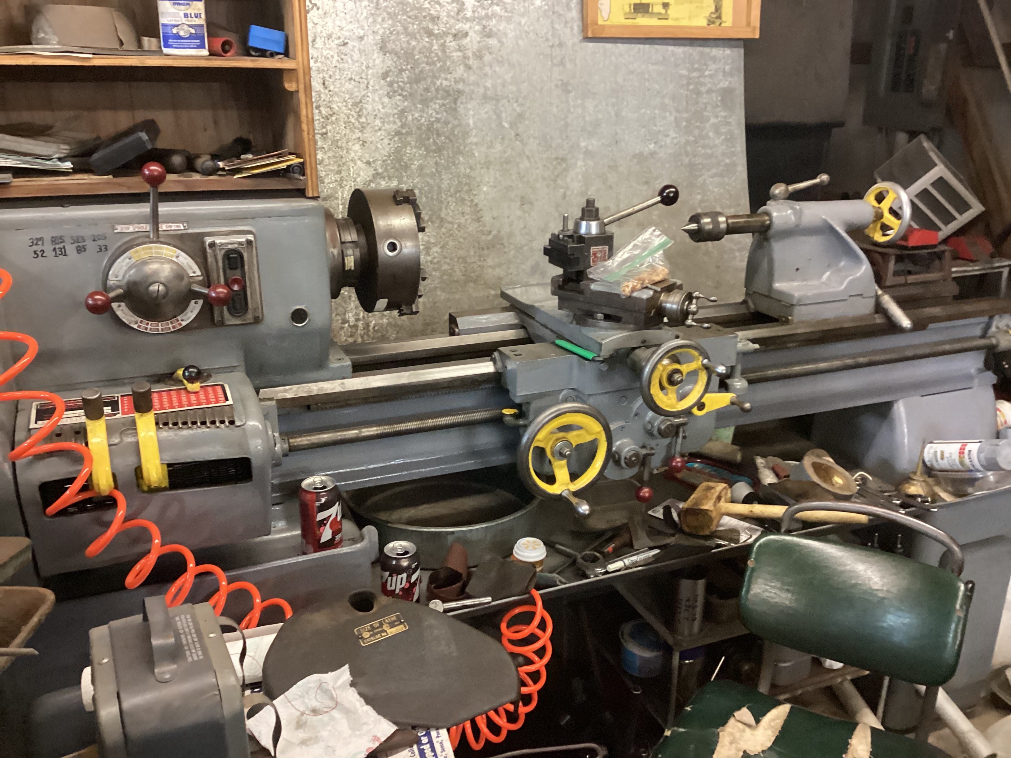

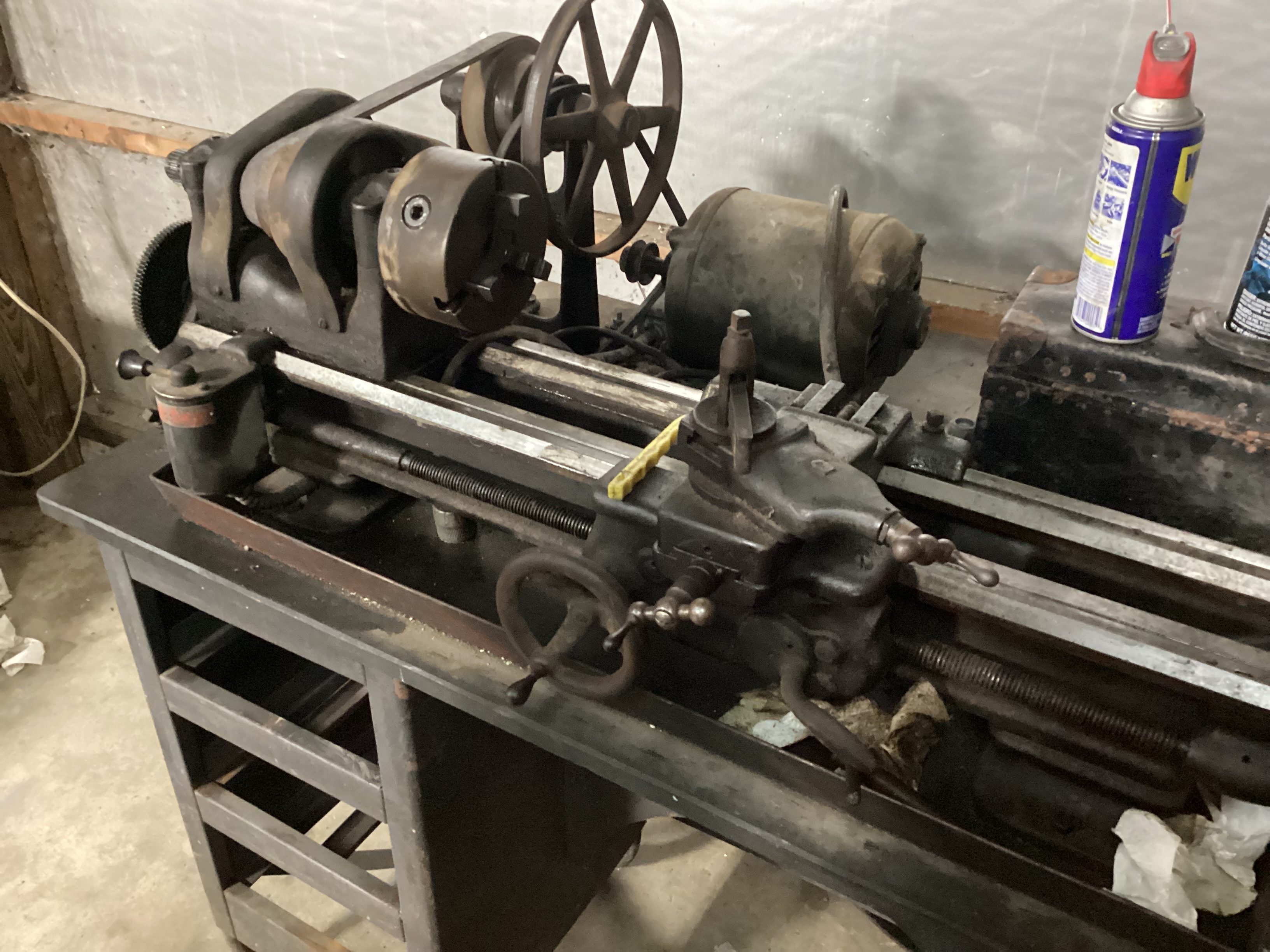

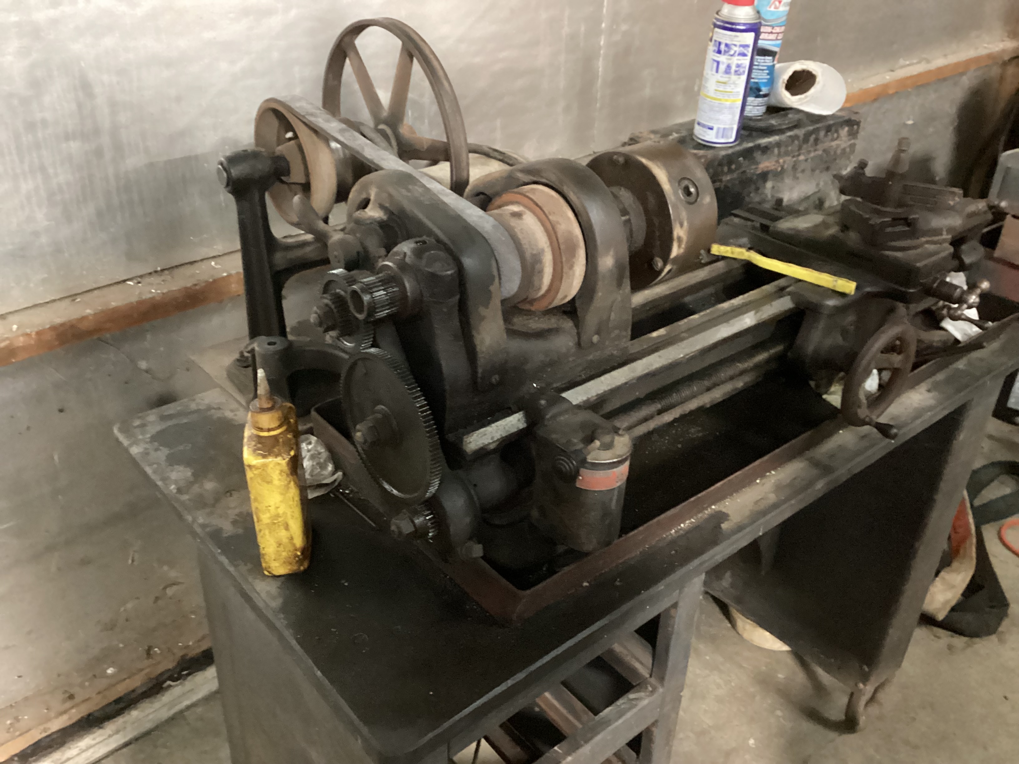

It looks like what the old tool cabinets were painted. I guess you could call it a dark gray. I have not found any info on it. Tag has catalog #40 5-y and no serial #. No serial # stamped in the ways. I do have a Sheldon Sebastian lathe. I am a YouTube educated machinist. No disrespect to real machinest. I can make drivers and bushings which comes in handy.

Note that the serial number is generally stamped on the top of the right end of the bed. Grizzly Machinery has the old records of South Bend. Get on their website & sluth around for the South Bend archives. For $25, they'll send ya a copy of the line item in the old ledger books as to when it was shipped, and to who (which is generally a machinery dealer). Found out my 16 x 60 is a 1922 !

That ol' SB 9C is a wee bit older. My neck stuck way out, it's was built in the 30's or maybe the real early 40's.
I haven't fully worked out when the spindle oilers moved from the top to the side for wick oiling.
But in 1941 the oilers were on the side.
You know this already but clean out the spindle oiler holes on top perfectly. Then oil.
If those holes for the spindle bearings are threaded, it may be easier to install BIG threaded cup oilers or even drip oilers.
With that gearing setup, was it used for cutting spirals/helixes on shafting? That lead screw is gonna spin!
Is there even a mounting bolt for reversing tumblers?
Find S Wells on his site or he's on practical machinist in the SB lathe section. He's one of the gurus about SB and should find your catalog number to say what it's options were etc. Look for wswells for good info too.

With yours, Id take a scrub brush and wd-40 after it to pop the color but that's me.

Would those gears on the lathe be a 50 and 127 tooth for metric threading?
With a few exceptions that work, turning metric threads needs a metric lead screw, and gear set. Jim
With "translation gears" an English leadscrew lathe can cut metric threads. Some of the How To Run A Lathe booklets have the gear chart necessary, it it done with the standard gears or settings and the translation gears. I believe the Logan web site also has charts for standard geared and quick change lathes too. One hundred twenty seven and 50 is an exact translation ratio but there are several that are close and don't need the large 127 tooth gear. I haven't needed to cut metric threads so far and don't have any translation gears but have read a little about it.
