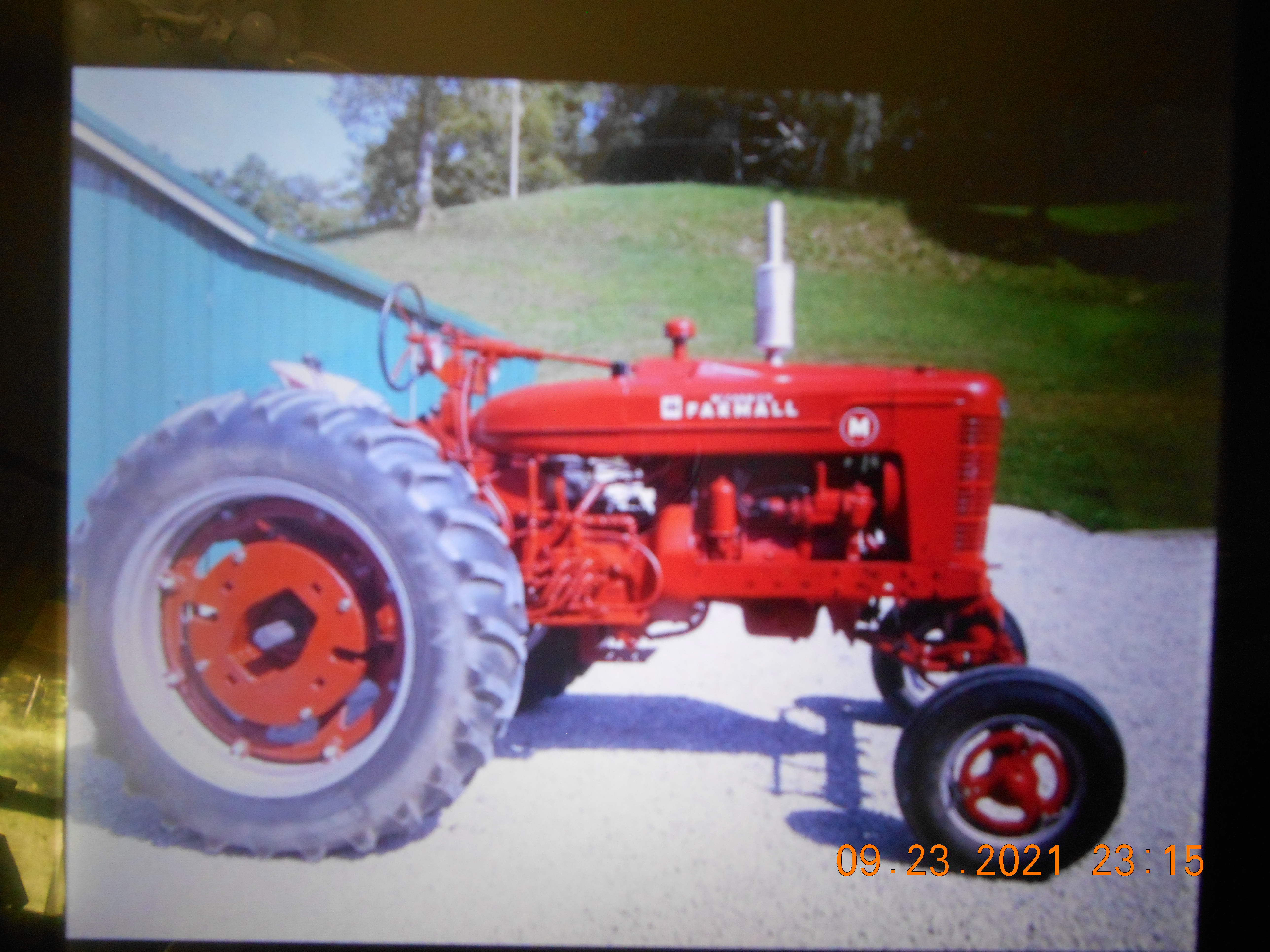

Measured this on cement floor. Top of frame rail at back 36 inches, front just to rear of front mount bolts into bolster 36.5 inches. From floor to center of rear axle 29 inches.

Mine is 35 3/4" and 36 1/2" To the axle center is 28 1/2"
Are those Titans 14.9 x 38" in the pic? They look too big for 14.9's and look like 16.9 x 38" on widened rims if I were to guess.

15.5 X 38 on 14 inch rims. They are titans and a shade taller than another brand of 14.9 I have. Really one has Armstrong on it. Both were like new but bought two different tractors with one new and one old. Switched one tractor to both old. Delta I assumed you measured to bottom just easier for me to check top.
