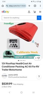

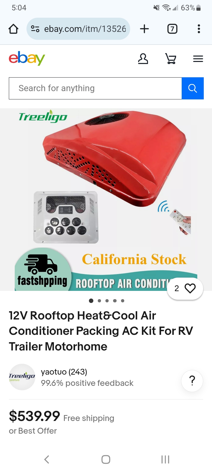

I just put a roof top a/c on my 1105. Replaced the swamp cooler that just never got it cool. Paid around $400 for the a/c from ebay. One wire to positive one to ground and it blows cold air. You do have to be ready to cut a 20"x20" hole in your roof. Mine already had a hole in it from the swamp cooler so just made it larger. Used it yesterday disking and it seemed fine. Will see how it does in the middle of summer. They make mini splits 12volt so you wouldn't have to cut a large hole just feed 2 lines in to cab. This is what I got. Price went up.
Hmmmmmm! About 6 months ago I bought a CIH 895 and decided against any money spent on a possible AC upgrade....although I bought this tractor to pull my round baler and AC would be super. I bought 3 ea 12v, 8" fans and put one on either side of and one on top of the console. Works OK but you got my attention with this. Thanks I'll check it out.
I just pulled this up on ebay where several sellers have them for sale. First off 10k BTU of cooling doesn't come out of thin air. Something has to consume that energy plus losses to transfer that energy to power (consumption of energy). Being 12v, like a regular piston compressor, it would be driven off the fan belt. Spec. read max 60 Amps from a "replacement" (probably) alternator would be required and for longevity, you would want an alternator rated at twice that I'd think. For a 3/8" V belt that's asking a lot. I'd think that you would need a 1/2" HD belt at least or a flat belt like is on most cars today, both requiring pulley changes on the crankshaft of the engine and an idler wheel of sorts, being it the water pump or the alternator itself being used for power and as an adjustable idler. If the crankshaft had the room, a separate pulley might be added for the sole purpose of driving the alternator. Hmmmmm!
With that thought, since the current alternator is usually the adjustable idler pulley, and you still have the water pump to drive, then you have to have a place to put the new alternator if you are only using the crankshaft, leaving the current one in place, electrically disconnected, just to support the water pump rotation.
I had a JD 4230 (100 hp) cab that had a dual pulley setup for the upgraded 4430 (125 hp) with a turbo. That would lend itself very well for this application as the pulleys were sized for 1/2" belts and there was room to drive another alternator off a bracket on the side of the tractor....but that would require removing the side screen on one side and they are necessary to keep chaff out of the radiator. This installation would require more thought!
Good luck on those of you that decide to go for this. Would be interested in your outcome and methodology so keeping us posted would be great.
But all that could be investigated and probably incorporated rather easily if the tractor modifications required didn't get too extensive. Worth checking out and this summer when I am baling hay, I might just up the ante and move that experience up to place #1 on my list of things to do/contemplate.
The 1105 has a 2 belt pulley driving the alternator. I think they are 1/2 but not sure. They are new as well as the alternator. I belive it's a 70 Amp alternator I am sure there are formulas and a guy could loose him self trying to out guess all the what ifs. That's not me. The few hours a week it will be used I will see what happens. I did have the thought to check the wires off the master switch where they are tied in to see if they were hot after 3 hours off use. No noticeable heat in the wires.
One of ther plusses on alternators is that they are fan cooled. That helps trying to run a CW alternator at full power. Bad news is that when its the hottest ambient, aka cooling air to the alternator, the AC is at the max requirement.
If I had the pulley setup that you mention, I'd be all over a newer, higher capacity alt. and the AC system being discussed here.
