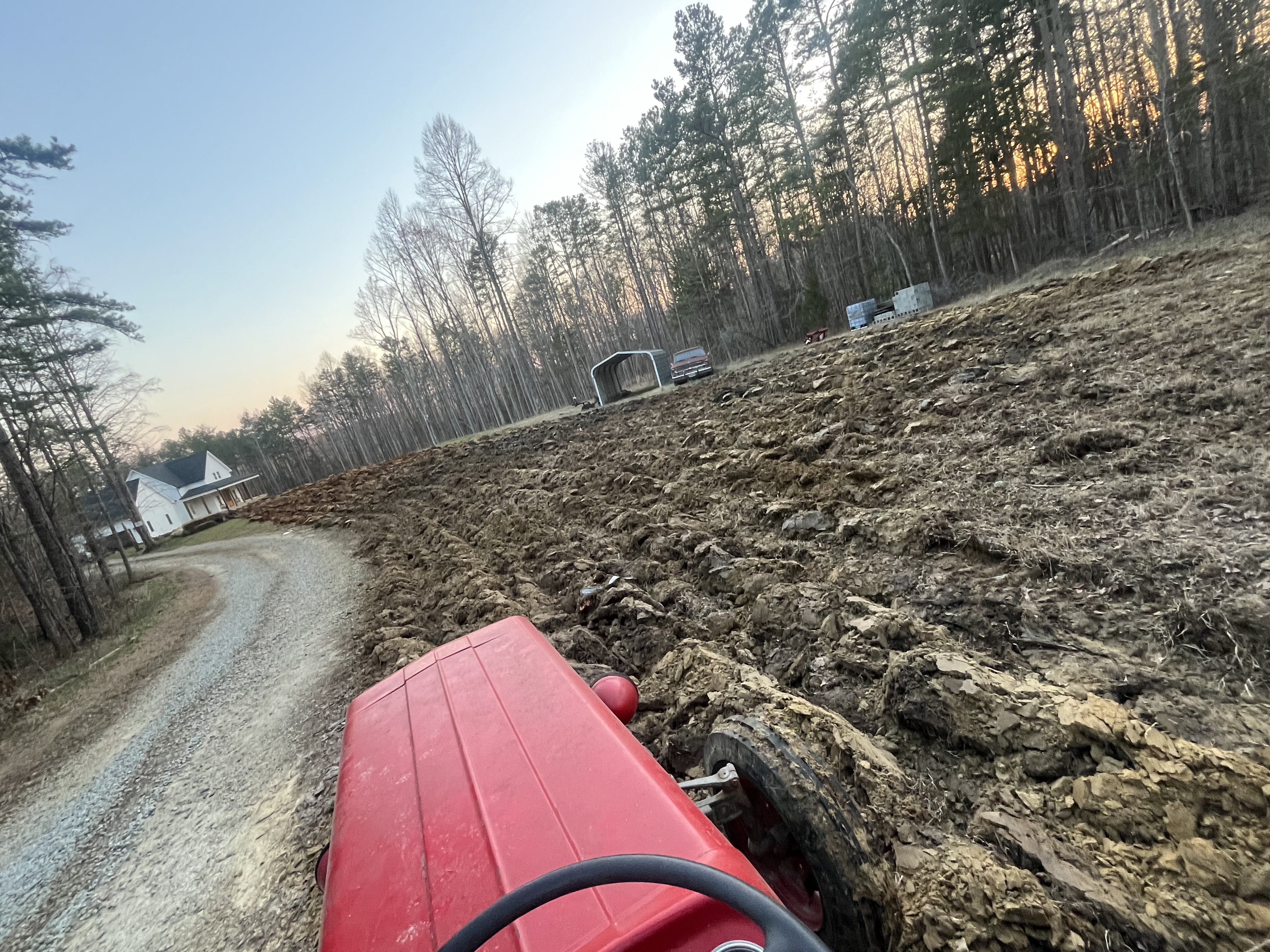

I have a mf135 and an old 2x14 (maybe 16) that my great grand paw gave my dad and he gave me. I’m trying to set the plow up so I can plow Thursday. And I’ll be honest I have no clue how to do it correctly. I can’t get the rear blade to touch the ground it just skates across the top and the big wheel just rolls behind it, any advice? Thanks so much in advance I’ve learned a lot here already.

When setting up a plow, you need to go out and run it. You can't set it up in the yard. The key is to have it run level............which means that you have to take into consideration how the tractor is leaning into the furrow. The tractor will lean, but the plow has to stay LEVEL. It will not work if it's not level as it's pulled through the field. Figure out how to adjust yours so it's level. In addition, my plow at least, the land wheel prevents the plow from rolling. Dunno how yours is built.
Ground....................It's all about the ground. The ground should be dry enough to prevent slick slabs from coming up. These take a ton of time to season. It can take a whole Winter to mellow this kinda crap.
This is ground that could have waited a while before it was worked...........but fields vary from spot to spot. It will mellow over the Winter season.
This is good ground.......prime for tillage. It breaks, instead of rolling over in a slick slab. That stuff you got in your pics is not ready for plowing. NOTE HOW THE PLOW IS RUNNING LEVEL, WHILE THE TRACTOR IS DOWN IN THE FURROW. A plow needs to run level.
Plowing depth. Don't let the morons tell you that you need to go deeper than around 8". All you need to do is to prepare a seed bed. Dig deeper, and you're wasting resources. Fuel, engines, and tillage equipment wear............not to mention ruining your ground.
