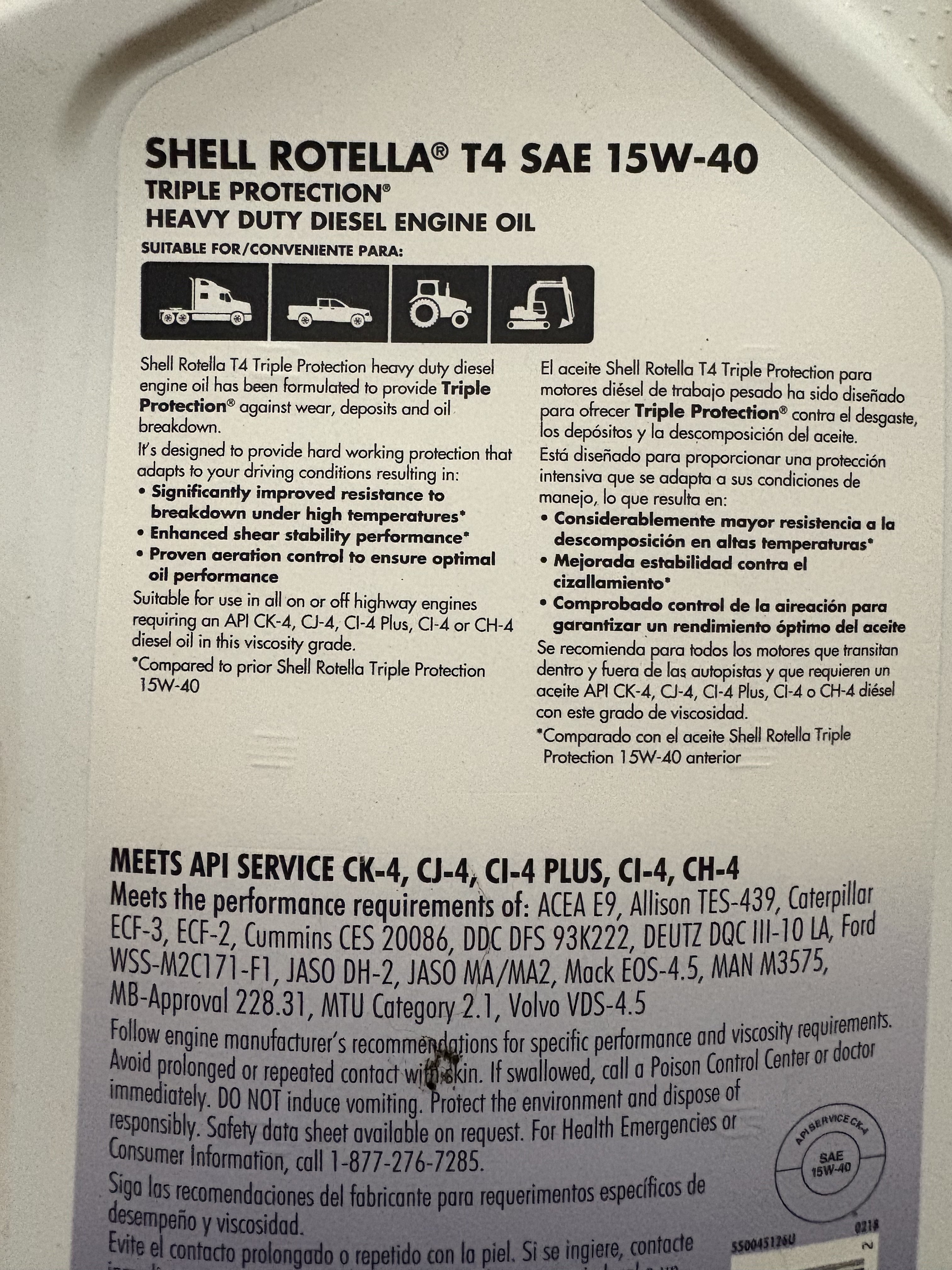

Shell Rotella® T4 Triple Protection 15W-40 is designed to provide hardworking protection that adapts to your driving conditions. Suitable for virtually all modern low-emission heavy duty engines and older hard working diesel engines.
  • With millions of miles of real world testing, Shell Rotella® T4 Triple Protection 15W-40 uses a proprietary, synthetic blend formula exclusive to Shell.
  • It is designed to protect under the most severe engine conditions found in modern low-emission engines and older hard working diesel engines.
  • Resists oxidation, wear, and oil breakdown, and meets CK-4 specs.
  • Enhanced protection against viscosity loss due to shear and improved oil aeration compared to previous generation CJ-4 product.

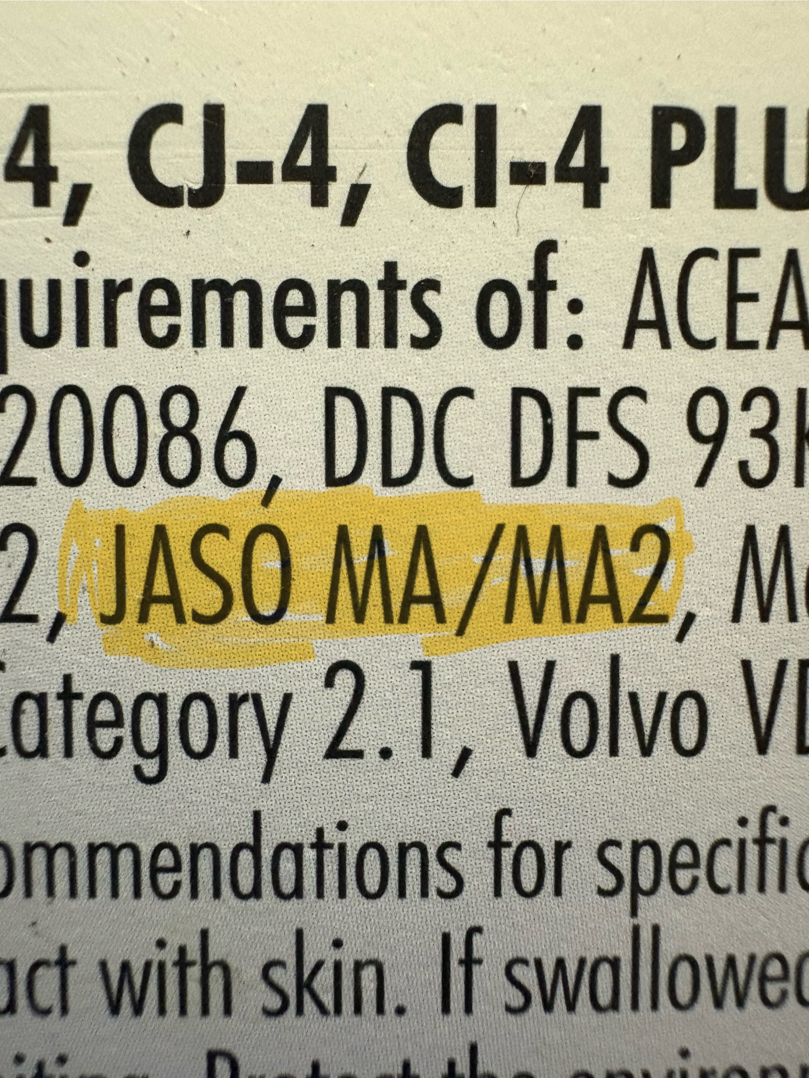

Just saying 'Rotella' doesn't mean much, as there are several different versions of Rotella with different specs. A little-known fact is that Rotella T6 carries the JASO MA spec, which means it's perfectly fine to use in motorcycles with wet clutches. Rotella T4 and T5 are NOT JASO MA rated.
t4 and t5 have too many anti wear additives to be used on a wet clutch... as the clutch will start to slip... Thus its a no no.

T4 has been spec. JASO MA for years. I use it in my wet clutch ATVs and it seems to shift better.

This pre Tier IV rating CH-4 mentions that it provides valvetrain protection .
CI-4plus claims to be back compatible to CH-4 ?
