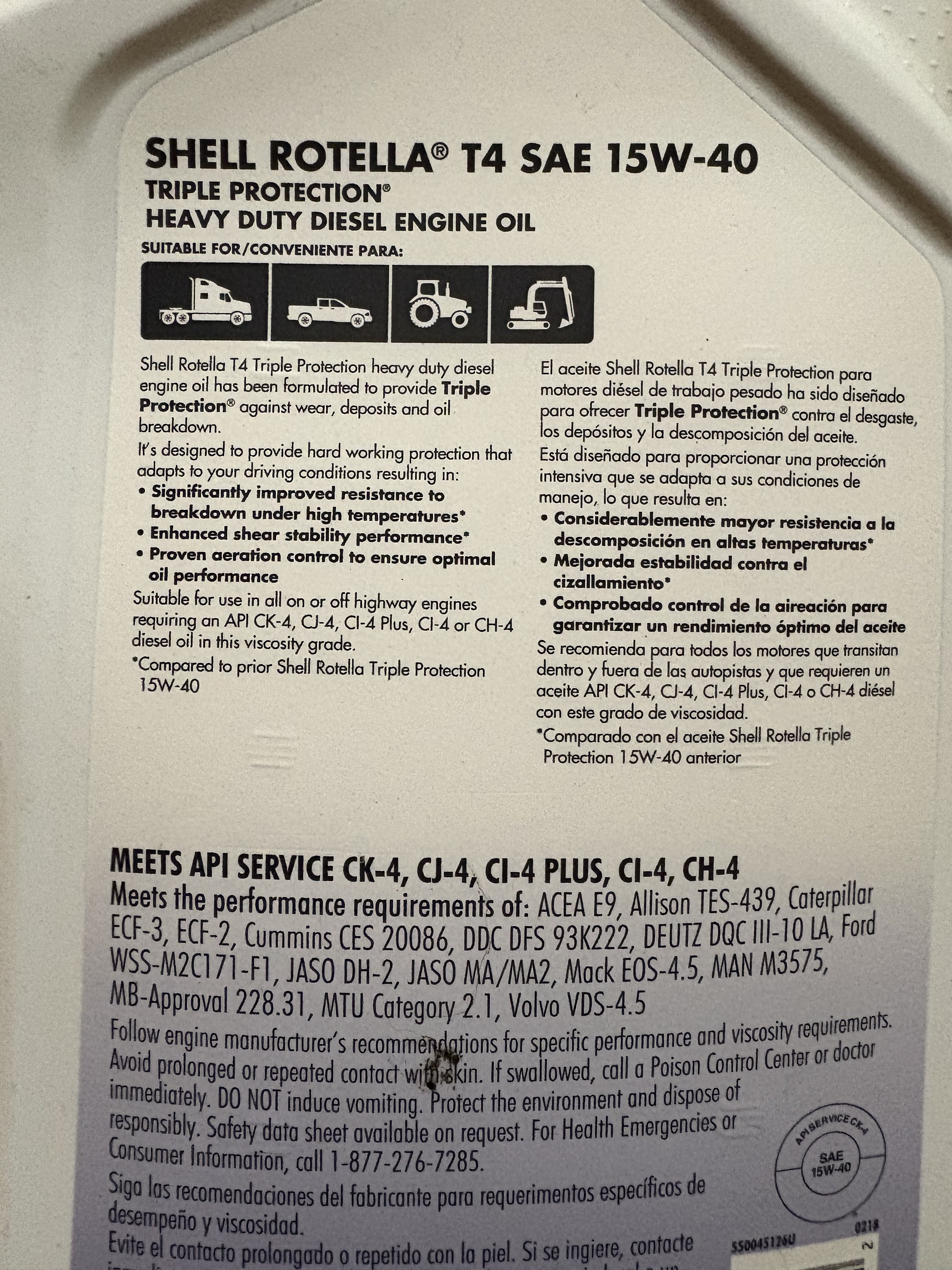

View attachment 109016View attachment 109018

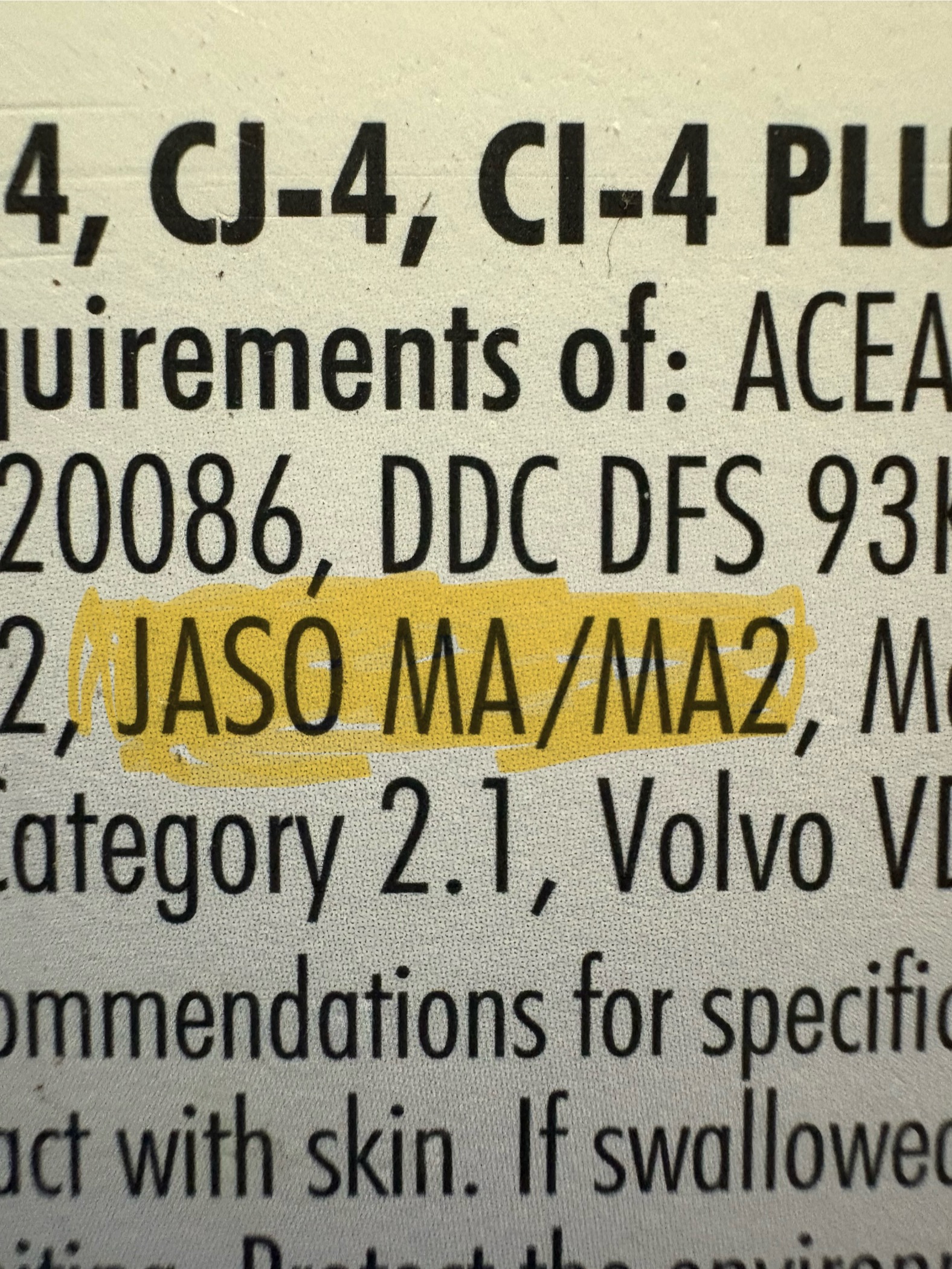

T4 has been spec. JASO MA for years. I use it in my wet clutch ATVs and it seems to shift better.
I stand corrected, Dingo. It seems that T5 doesn't carry the JASO MA spec while T4 does. I never buy T4 so I don't pay much attention to it. I suspect T5 has the sort of friction modifiers that cause problems with wet clutches, and T6 does not.

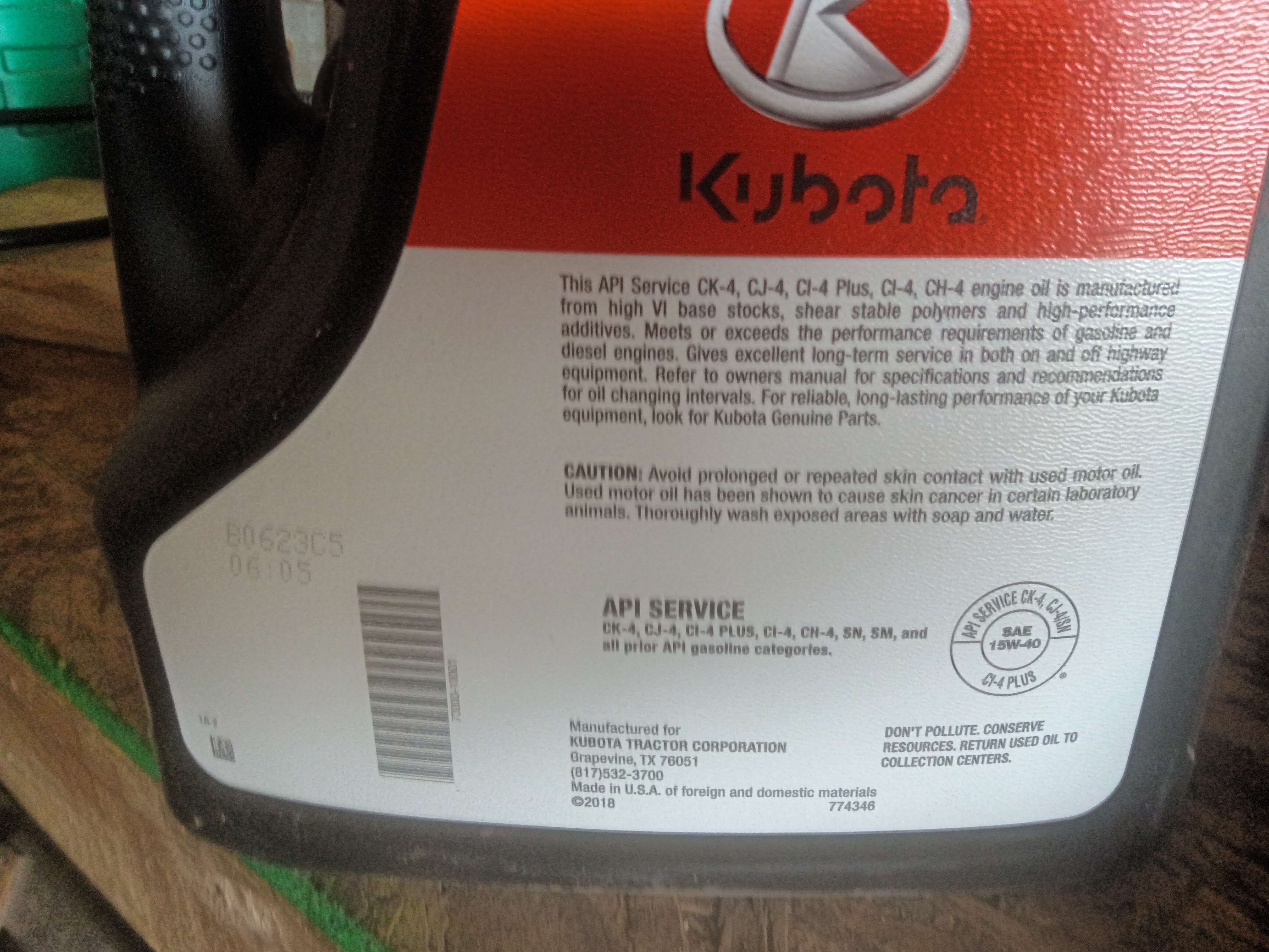

Her is the alphabet on my Kubota oil.
And reason rotella won't work in my old gasser tractor, lawn mowers and my Kubota
Below is a picture of the oil my Kubota dealer sells. My reason for asking is rotella is cheaper.

George, it doesn't really matter what specs are on your 'bota oil. What matters are the specs called out for your TRACTOR.
CK-4, CJ-4 and CI-4 are all API diesel oil specs. ("C" is for "compression ignition"). SN and SM are gasoline oil specs ("S" is for "spark ignition"). But what does your Kubota's manual call for? Diesel engine oil or gasoline engine oil? If it says to use, for example, CK-4, Rotella meets that spec and should be fine. But if it says to use SM, then you'd better not use Rotella because Rotella doesn't meet API SM. Never mind that the oil in your Bota Bag meets BOTH specs.

Just saying 'Rotella' doesn't mean much, as there are several different versions of Rotella with different specs. A little-known fact is that Rotella T6 carries the JASO MA spec, which means it's perfectly fine to use in motorcycles with wet clutches. Rotella T4 and T5 are NOT JASO MA rated.
